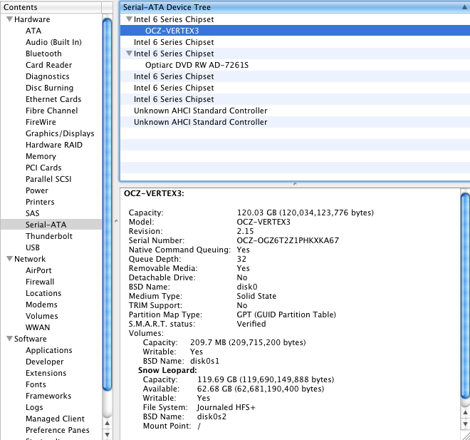

Hi, I'm having some problems with my SSD drive.
I have OCZ Vertex 3 connected to my Gigabyte Z68X-UD3H-B3 (F9) mobo through the Intel Z68 Chipset (Port: SATA3_0)

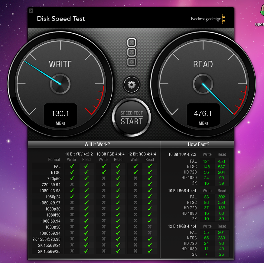

I'm getting great read speeds, but my write speed is nowhere near where it should be.
Can anyone shed some light on what the problem might be?

And here are some screenshots that might help:

weird.. I have a an agility 3 which uses the same controller and I'm also getting weird results... AJA is reporting "normal" sata 3 speeds but blackmagic disk almost got me thinking my drive is running in sata 2, I'm also using a Z68 board p8z68v gen3 JM626 I think
  • 2 weeks later...
I'm using an P6X58D-E with an OCZ Vertex 2 and I got lowered speed in the Black Magic Disk Speed Test too, I think I first noticed when I had 10.7.2 installed.
I know for sure that it worked perfectly under 10.6.8 resulting in read speeds of 275 MB/s .
For now 10.7.2 boots really fast like 10.6.8 used to do, so I'm wondering if there is an compatibility problem with Black Magic's tool and 10.7.2
