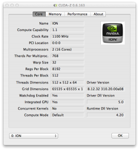

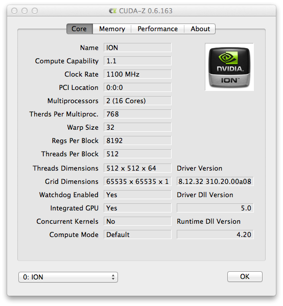

Sorry, bbc9, but how could i know? To me, you were just someone asking help, and i tried my best. :D But i just realized you're the one that wrote the HDA script, so obviously any DSDT injection would be a piece of cake for you. My bad. (OFF: by the way, do you know directions for an AppleHDA patching guide from where i can learn to patch it manually, completely from scratch, for my VT 1705, since it's not supported by any current patch?)
And you are right about CUDA and the 9400m, despite the nVidia site stating 16 "stream cores" (not CUDA cores) for the 9400m: just downloaded the latest CUDA drivers, which i found were missing in my system, and CUDA-Z now displays the CUDA cores correctly (picture below). But then again, i've been running OSX on my 1201n all the way from 10.7.0 to 10.8.4 beta without a single graphics issue, so the issue must lie somewhere else. I'd say, risking to be a little futile, to test the injections of the 1201n topic.
All the best!
