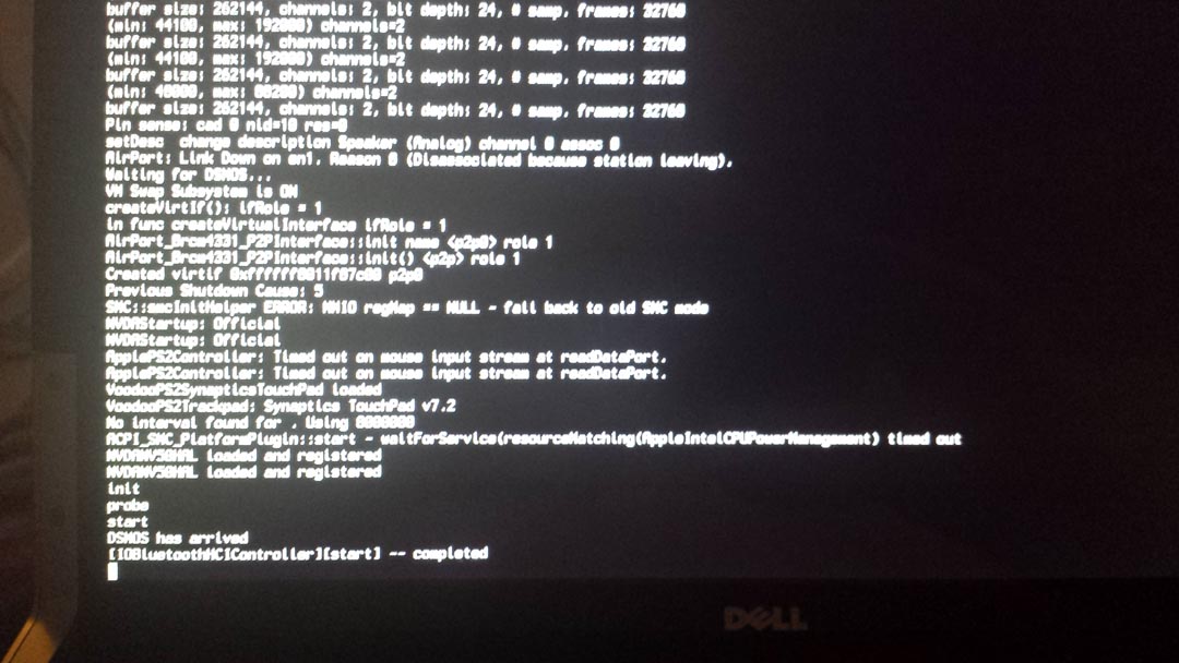

I can remove some of the nvidia graphics drivers and get the system to lock up right before the screen goes black instead, or I can get the system to panic with IOPPlatformPluginLegacy in the traceback if I remove all the nvidia graphics drivers.
So this panic message was the clue. Prior to 10.8.3, I could boot with nv_disable=1 and that would disable the nvidia graphics and the system would come up with vga graphics. With 10.8.3, I'd get the panic with IOPPlatformPluginLegacy and ACPI_SMC_PlatformPlugin in the traceback.
So, I moved ACPI_SMC_PlatformPlugin out of /S/L/E and viola no more panic, and also I can boot with the 10.8.3 nvidia drivers. No more hang.
Digging further, it was 9400m_gstate_inject that was triggering the problems. Looks like mapping this system's AGPM g-state to control-id 16 no longer works. Everything is fine without 9400m_gstate_inject (and I no longer need to break ACPI_SMC_PlatformPlugin).

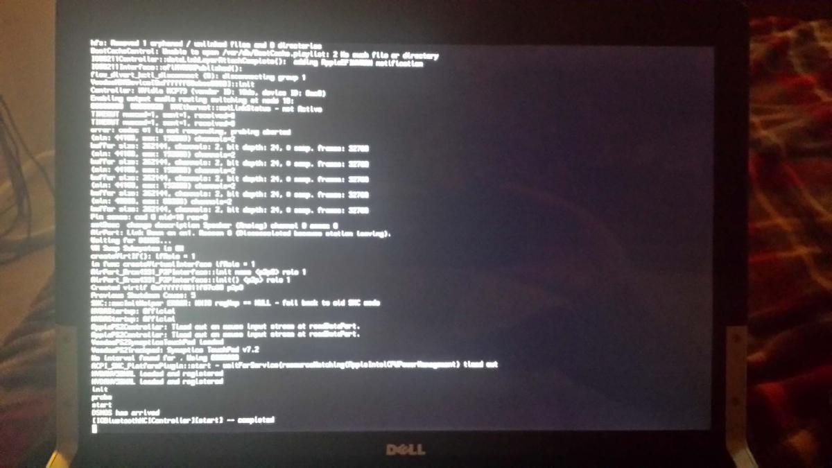

Hi, first would like to thank bcc9 for this great guide and all your hard work. I followed the guide "exactly" for my Mountain Lion install but no matter what I do I'm getting this [ PCI Configuration Begin ] hang when using DSDT.aml (I CAN boot without it) I also don't have this PCI hang on 10.6.3. I CAN'T use the dsdt-check.pl because when I run it I only get "Address space not recognized. Please post the output from showbootermemorymap" so I tried both DSDT.aml / DSDT-alt.aml to no avail. I have also tried metamorphoise's metamorphoiseDSDT.zip .. I have been trying to get past this for more then a WEEK :wallbash: So if someone can help me out it would be greatly appreciated. I'll be waiting for someones response. THANKS
Edit: I've tried npci=0x2000

My dsdt-check.pl and showbootermemorymap were designed to troubleshoot the ACPI memory space issues that some users started seeing as of osx 10.7. The script doesn't work with older OSX (10.6), but that should be OK - it's meant to be run on the version of osx that you're trying to work with not an old release.
If that doesn't describe your issue, then you'd do well to post the showbootmermemorymap output as the script asked you to.
Now, normally I update post #1 to include the latest&greatest fixes, but the DSDT changes I made to support current OSX for users with discrete GPUs (9500m/g210m) continues to lack proper feedback. I cannot clean things up without some complete feedback. For reference, the two candidate fixes are:

Still the same [ PCI Configuration begin ] hang   :(
Stupid Question: Could it be because I have only one 2gb stick of ram? The second stick gave out. ( also changed wireless card )
If someone would benchmark which of these two actually lowers the power consumption for discrete GPU users (with kill-a-watt or some time-based measurements as asked for), then I'd know what to do next to clean things up.
I would have no problem doing this for you but DSDT's still Hanging the system
if nobody is going to follow up with responses and instead just disappear once they've taken enough information to get their system working, then I propose this thread gets closed.
Please dont close the thread i'll give you as much feedback as I possibly can.
I am hoping you can help me get this working. Any more suggestions will be appreciated.
Ok, now we're getting somewhere. So your system does infact have a different memory region layout than everyone else, so you need a different DSDT with addresses that match yours.
Yes, it's expected that you are still hanging with the custom dsdts since they aren't matching your layout.
And yes, I'd assume your layout is different because you're running with 1/2 the normal memory.
Here's 2 DSDTs that match your layout, otherwise identical to the v4 and v5 candidates posted above.
