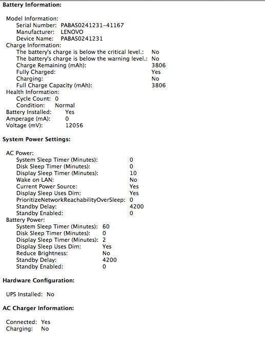

hi rehabman, i managed to show the battery icon on the top (menu bar) using the patch method on your tutorial. there is one register which is using 256-bit. i'm not quite sure how to patch it.
attached is a screenshot of the battery status when unplugged. since battery is always showing 0% when plugged-in. as expected when unplugged it will displayed an almost drained icon. but when clicked, details showed as to "remaining time".

Your DSDT has multi-byte fields in addition to the SMD0. See post #157 for a google search that will get you to the right place for a comprehensive guide for patching your DSDT for battery status. Hint: it is not here, but rather another popular website for hackintosh. This site does not allow links to that site (although that site allows links here) and I'm not willing to maintain two posts on two separate sites for the subject (maybe I should start to provide them on my blog...). I would have thought the clues I gave you in post #157 would be enough, but evidently not...

It means you didn't patch DSDT correctly/completely. Install the debug version of ACPIBatteryManager.kext to further isolate the issue. Check your entire DSDT for multi-byte EC fields. Also, some DSDTs have a non-zero SyncLevel specified for mutex objects and this can cause problems for OS X. See: https://github.com/RehabMan/Laptop-DSDT-Patch, try to apply patch "Fix Mutex with non-zero SyncLevel"
