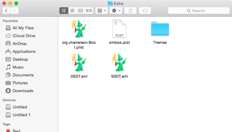

Putting in the DSDT and SSDT fixed the sleep issue, I'll try the Voodoo kexts to see if I can get scroll working! I could even change my brightness now!

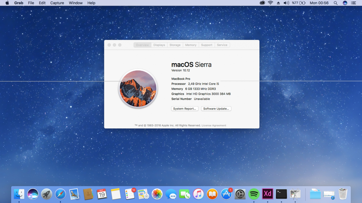

Mac OS Sierra GM works here, with screen artifacts.

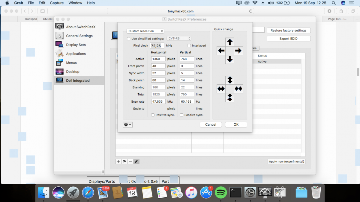

Even though I used the color profile which was created in Yosemite with switchresx(using correct display sync values). In Yosemite it was working fine(no artifacts 99.9 percent of time), even I was removed the switchresx, and wasn't using it for last 1.5 years.
Intel Integrated Graphics with QE/CI works.

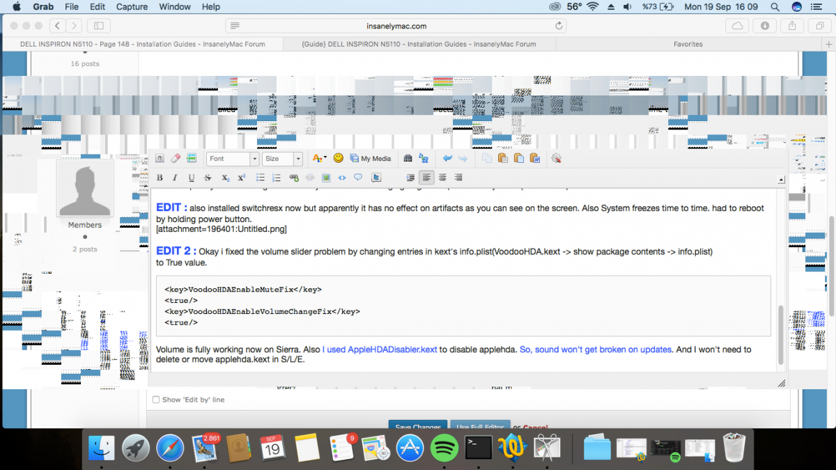

EDIT : also installed switchresx now but apparently it has no effect on artifacts as you can see on the screen. Also System freezes time to time. had to reboot by holding power button.
post-868887-0-80404200-1474277013_thumb.pngpost-868887-0-43003000-1474290433_thumb.png
EDIT 1.1 : I realized that first screenshot contains 1360x768. I changed it again to 1366x768 with pixel clock 72.25 and then 72.1. will update the post if something changes.
