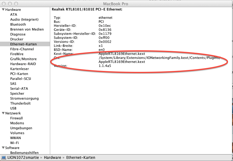

I will try with a other NIC on PCI and disable the internal to check.
My card is a 8101 E pci-e onboard the laptop.
Here is my networking configuration and the kext I have used ( from original realtek software, SnowLeo but works in Lion ), it is a plugin for IONEtworkingFamily.kext

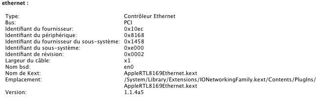

Not better, I have use your kext (it is the official Realtek driver v2.0.6) and that don't work so the problem is not the NIC driver.
It is perhaps a bug with this NIC model, mine is RTL 8111C, I will try an old HP NC7170 (the chipset is intel 8254x, normally that work OOB)

I have try with a PCI NIC HP NC7170 (chipset intel 82546EB) and not better, same error.
It is a very strange problem.

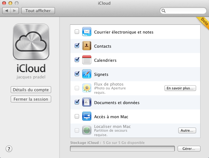

Thank you smartie77. This is the trick. Get Chameleon 2.1 with FaceTime fix or other bootloader that enables FaceTime and you will have iCloud
Issue 188 create for chameleon project. To be continued ..... :)
