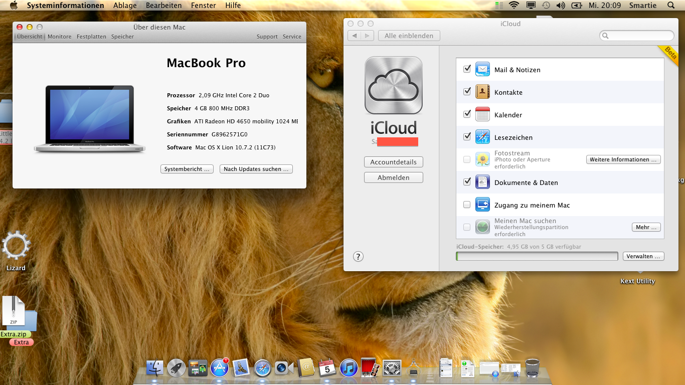

Ok, so all my machines are set up now to use it.
The Ethernet port must be en0 and internal to work. ( same for AppStore , if you can download apps, you can use iCloud ) So if a wifi is active, this has to be en1 instead of en0 , I had to delete all network devices and re-add them with Ethernet being the first. Also chameleon "built-in" hack

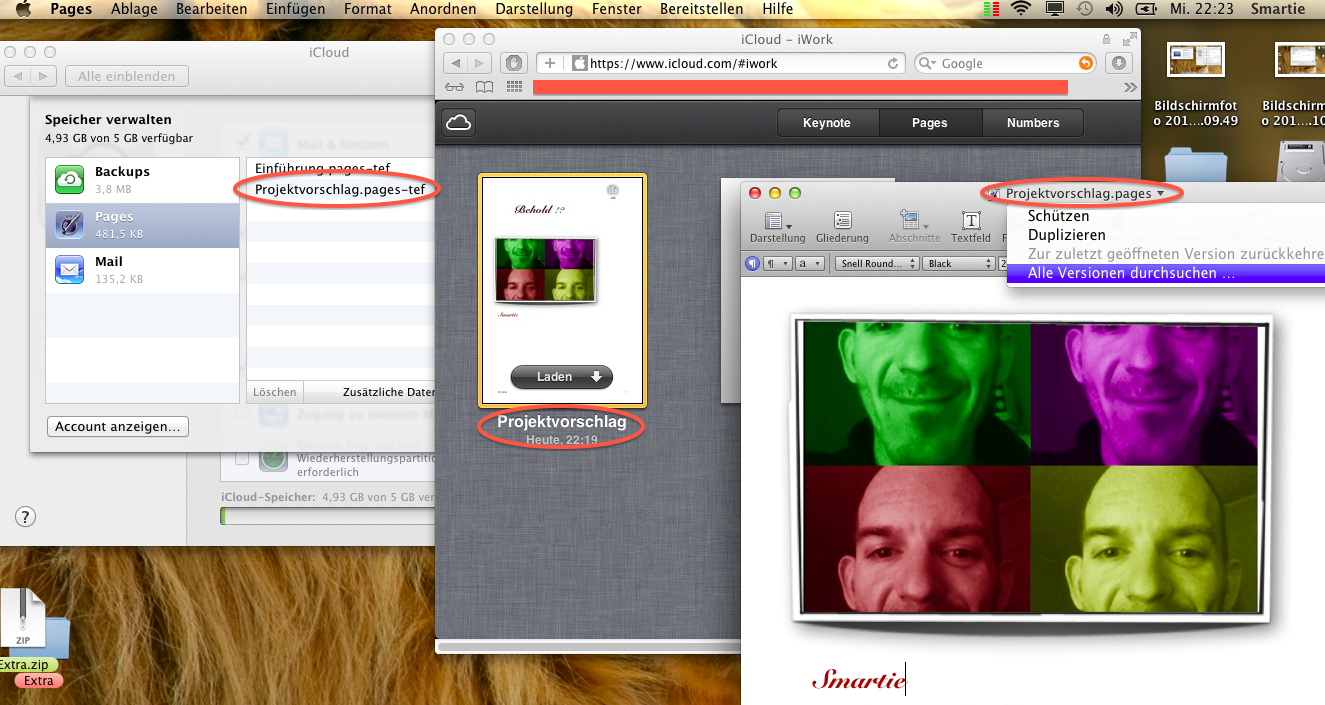

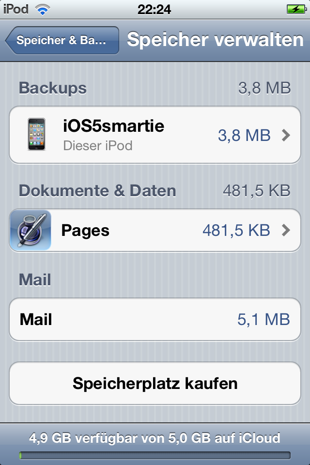

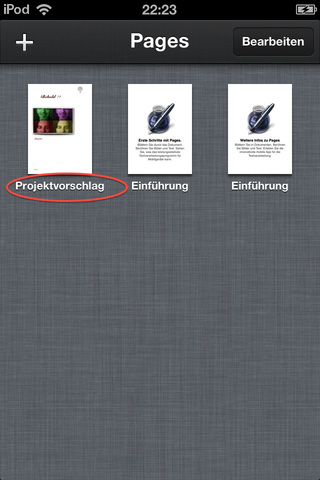

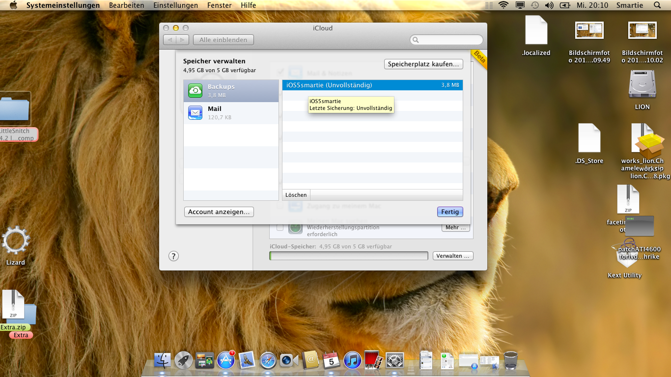

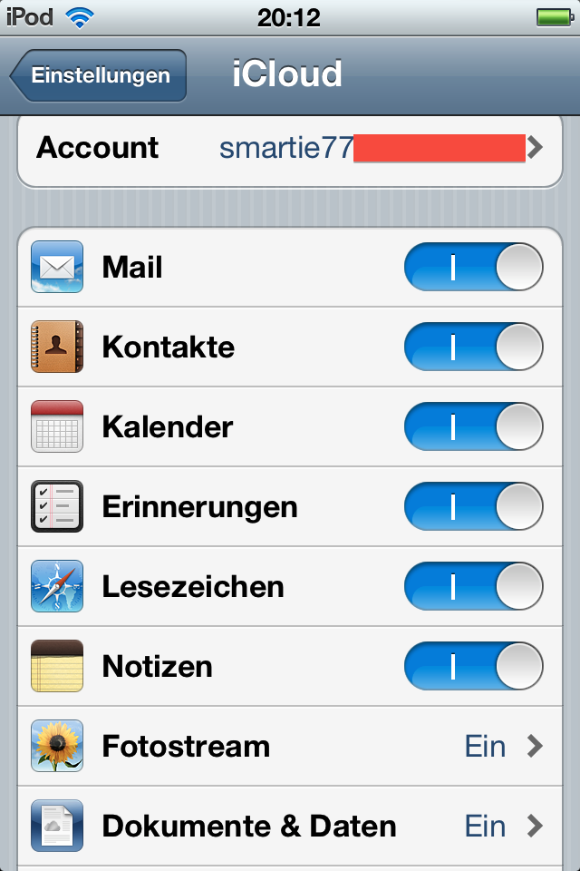

iCloud in iOS5 GM and 11C73 together plus the web component completely work :
example , sync a pages document via iCloud :(
both Mac OS and iPod show same options :

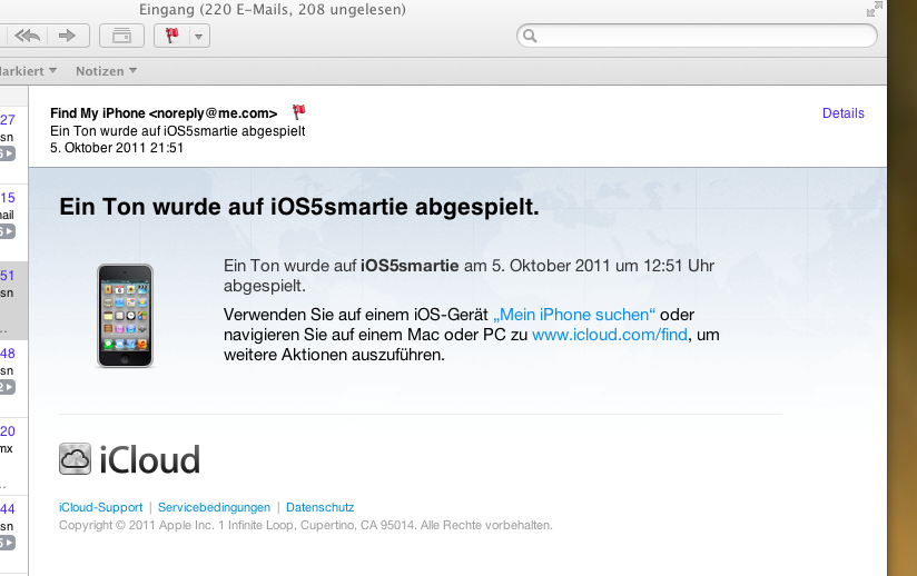

email notification that "find my iPhone" works ( sent a sound/message to the iPod via iCloud.com ) :

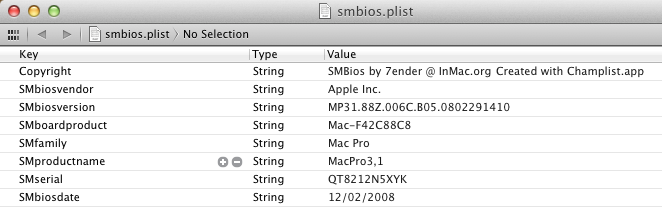

Thank you for your help, i use DSDT fully tuned for ethernet and C-states, etc so normally my DSDT is ok. I use chameleon 1518 and the last fakesmc (3.1.0 rev 495).
I have no webcam so i can't try FaceTime. i will try with the serial of my macbook but not sure that work because my hack is know as macpro

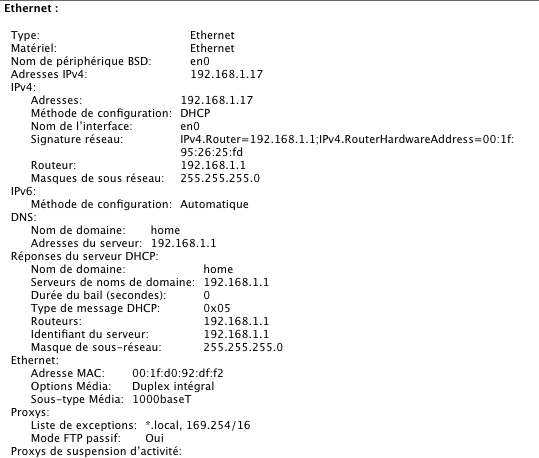

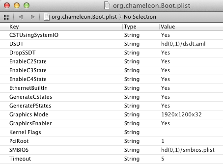

At this time that don't work, please find below my configuration :
- Chameleon 2.1 rev 1598
- FakeSMC 3.1 rev 495

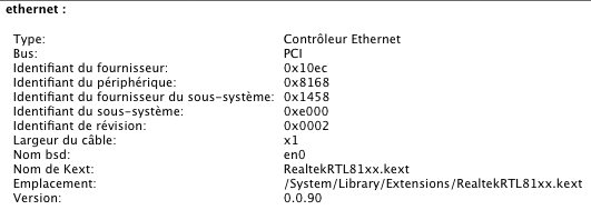

I don't know where we can see if the ethernet is really build-in.
I use drivers package RealtekRTL81xx-0_0_90.pkg for my NIC since Lion because it don't work without that. Do you think the problem can be here ?

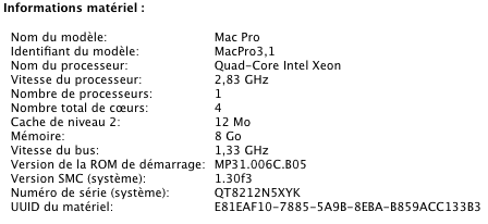

Please find below screenshoot of my configuration
The FaceTime fix is integrated in chameleon since rev1493 so normally i have it with my version 1598. Problem don't come from that.
Random generated serial with lizard app don't work. I've tried everything except device id efi string and still no go.
samething i haven't tried efi string because normally i don't need it.
What is in you're EFI string ?
I'm not using efi string I'm just referring to post 32 on previous page.
I have try to use an EFI string to force build in ethernet and that don't work better (i know how add EFI string because i use it before the option exist in chameleon for build in ethernet so it's not a wrong manipulation).
So too resume :
- my chameleon is ok because this version include the FaceTime fix (last version 1598)
- my fakesmc is ok (last version rev 495)
- my ethernet is build in because time machine work and force it with EFI string don't change anything.
- my ethernet is correctly en0
- Mac App Store is OK

Another thing, i have try to check the warranty on apple support site with my generated serial number and the web site say me it's a mac pro 2008 and the warranty is expired. It never say me the serial number don't exist so i think icloud perhaps don't check the serial number because support site don't know the serial number is not real.
I can confirm that it's not related to the serial number. So, some kind of checking the controller remains.
