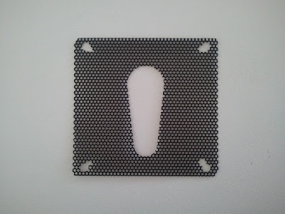

X-fact0r Posted October 1, 2011 Author Share Posted October 1, 2011 Nah... I wasn't leaving it like that HARDWARE List of components used on this build: 1x Asus P8Z68-V Intel Z68 SK1155 1x Intel Core i5 2500K (Unlocked) 3.3GHz, 6MB 1x Noctua NH-U12P SE2 1x PowerColor Ati HD6950 2048MB DDR5 PCI-E 1x Corsair Vengeance 2x4096MB (8GB) DDR3 1600Mhz CAS9 1x Corsair Gaming Series GS700 – 700W 80 Plus 1x OCZ Agility 3 – SSD 2.5 SATAIII 120GB 1x Western Digital Caviar Green 2TB 64MB SATAIII 1x SONY Optiarc DVR 24x DLayer SATA 1x Akasa AK-MX010 Adapter 2×2.5 SSD 2x NoiseBlocker BlacksilentFan XL1 (120mm) 1x NoiseBlocker BlacksilentFan XE1 (92mm) COOLING To cool the G5 I chose two 120mm intake fans and a 90mm for the outlet. In order to fix the intake fans I made a structure from an "L" shapped aluminium strip that was screwed to the case. If you noticed there was a black grill in the NOX case, I used it to make the 90mm fan grill. For the PSU I had to cut the G5 tray. I printed a 140mm fan stencil from MNPCtech but soon realised that the hole was a little small for the PSU fan... whatever. Link to comment Share on other sites More sharing options...
