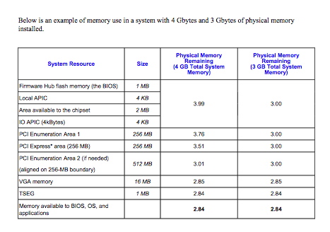

Bearcat Posted September 7, 2006 Share Posted September 7, 2006 I believe all the iMacs today are 945 based, and that is why they only support up to 3gig of ram. (3.2gig actually). A little more follow up on this. A 32 bit Operating System can address about 4 gigs of memory, 64 bit OSes a lot more. The 945 chipset maps a number of things into the 4 gig address range so that 32 bit Operating Systems can see these things, and use the hardware. What it means is, even if I put 4 gigs of ram into the machine that address range at 4 gigabyte downwards will get mapped over with other addressable hardware, which leaves that ram unusable by the Operating System. On some boards like the Asus 945 boards, Windows XP 32 bit would report 3.2gigs of ram available. Below is an example chart that illustrates the memory addresses overlayed in a 4 gig and a 3 gig system. As you can see in the chart, it doesn't matter whether you have 4 gigs of ram in the system or 3 gigs of ram, the hardware overlays part of that address space, and you are left with about the same amount of usable ram to the Operating System and Applications. Link to comment Share on other sites More sharing options...

Bearcat Posted September 7, 2006 Share Posted September 7, 2006 I thought this ~3GB limit issue was limited to the 945G series chipsets and not an issue on the 945P series. Could be, The only thing I know is, we have ASUS 945 boards with the gma950 and without, and all of them say 3.2gigs available ram when boot into windows and linux, even though all the machines have 4gigs ram installed. Link to comment Share on other sites More sharing options...
