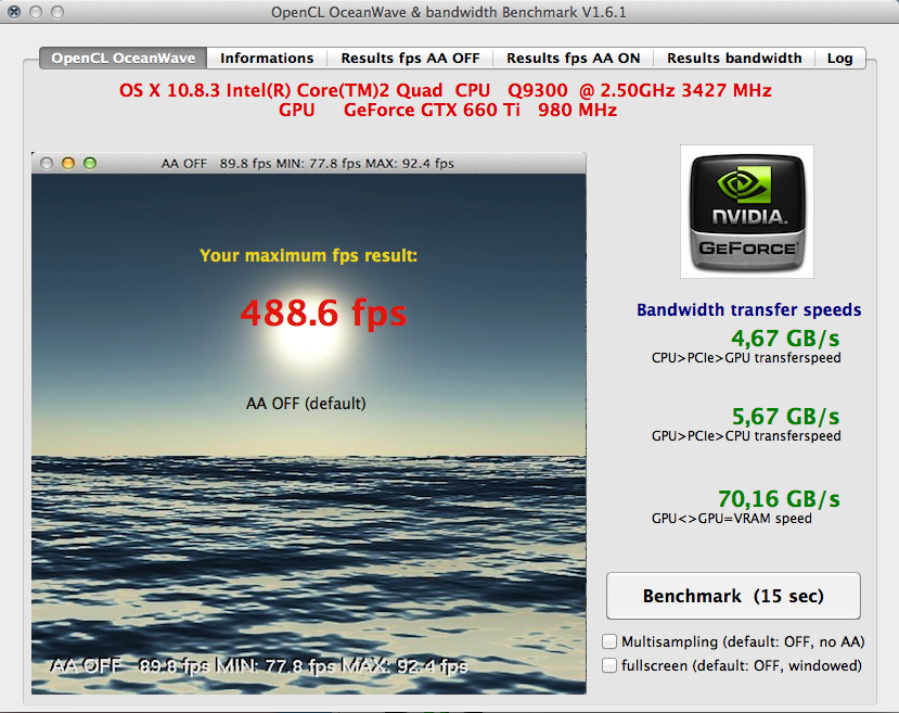

Thanks commenting the OpenCL patch need/noneed. Can be helpful for others. So only older Fermi do need the patch like 4xx and 5xx ? Work 650...680 without patch? Or only some of the 6xx GPU type?
Thanks, also AMD OpenCL drivers got updated - so you be free to check some diffs. But as for every bench, only significant >3% diff may happen by the update.1-3% % fps diff also happens between two runs on same system.
PS: New Bench version has AA OF by default, older versions uses AA ON, doesnt matter for fast gpus (had >> 100 fps in old version) but slower cards have up to 10% less fps with AA ON (default in old version) vs AA OF (default in new version.

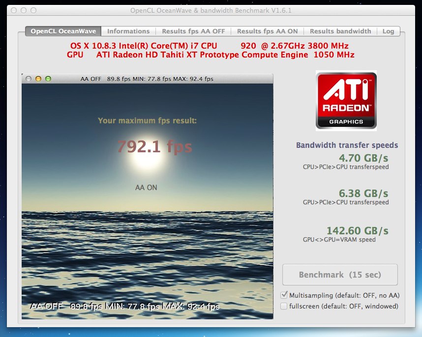

Thanks, we see that AA doesnt matter running this bench on fast gpus. This OpenCL Code seems to perform a bit faster on Nvidia Highend vs. AMD Highend. But doesnt matter - other OpenCL benches, whith different OpenCL code will have other ranking list of the highend gpus.
At least great steps forward compared to AMD 4870 & AMD 5870 Mac in case of OpenCL (here and Luxmark).
How doest the AMD 7950 perform OpenCL ? I guess at around 85%-90% speed of 7970?
