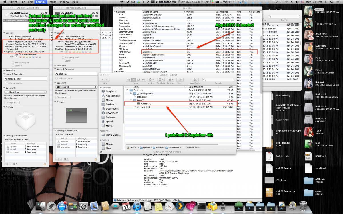

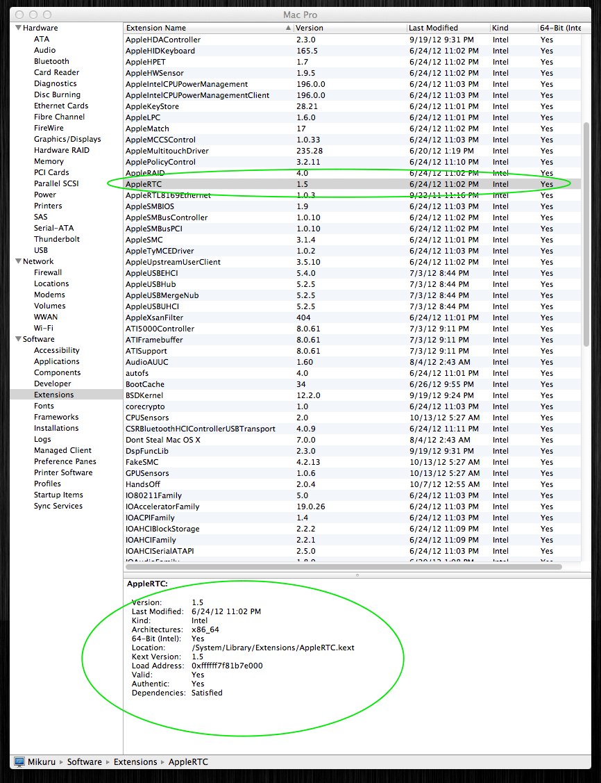

AppleRTC can be patched without moving it by changing the path
sudo perl -pi -e 's|\x75\x30\x89\xd8|\xeb\x30\x89\xd8|' /System/Library/Extensions/AppleRTC.kext/Contents/MacOS/AppleRTC
And loads fine and also included in kernel cache which can't be done from /Extra. Fixes possible sleep issues, but personally have not seen this impact ACPI one way or another, stock AppleACPIPlatform only causes large boot delay for me however and not a KP, so maybe a difference there
Wait a minute there have you actually Patched your AppleRTC in your current System in the /S/L/E path?
Because it does not work, I tried it personally several time and someone pointed out in the original AppleRTC bin patch thread that it also didn't work for them and they had to put it patched in the /E/E path
Yup, booting RAID-0 so I can't load extensions from /Extra anyway, they have to be cached. But if you wan't, for kicks, you can use pacafist with a certain beast product and see that the script used in it to patch AppleRTC is exactly the same and uses the exact same path, I won't post it here, but if you open it in Pacafist and got to resources, its inside multi-9.pkg(package name could change, but this was it in the one I just looked at, version for ML), inside a folder called scripts.

Thanx for your help!

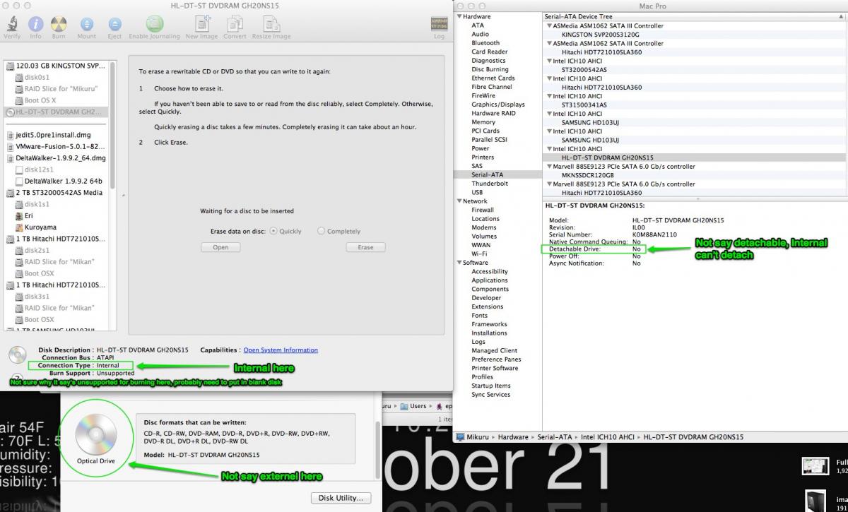

Also, even though problem is likely unrelated, here is how drive should show up to have full functions as an internal DVD, done via injector, as well as corrected sata controller names just for looks
And make sure there's no disk in it :)
