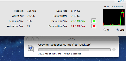

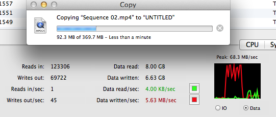

I have found a pretty serious bug USB 2 write speeds are at a snails pace! However reading from the same device is acceptable
Writing to a USB 2 memory stick:
Reading the same file:

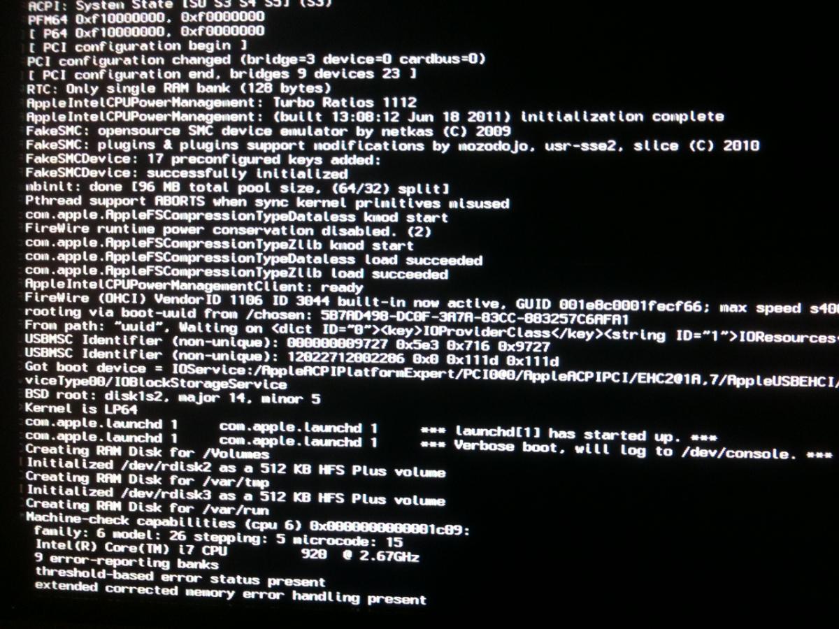

Hi Fabio or anyone,
I have my hack working just fine with SL but i get a SSD and decide install Lion on it. My installation following the steps on this tread hangs always. Look at the picture and give some ideas.
Thanks guys,
Asus P6T Deluxe V2 - Bios 0504
CPU: Intel i7-920
Video Card: XFX Radeon 5770 (Just one card installed)
Ram: Corsair 12GB - 1600
SSD Vertex 3 128 GB
