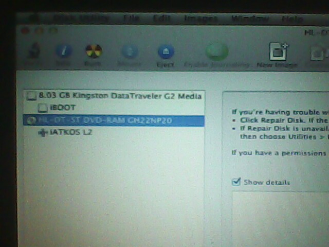

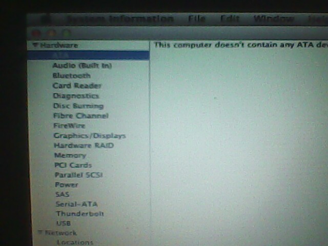

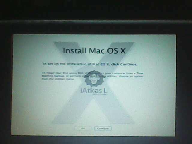

Hi verdant, I have a good news; :jester:
On my nForce PC I've able to boot from iATKOS L2 DVD & go to the installation process by using USB to IDE Converter Cable (without any CD/DVD Boot). Sounds good, but the problem is I can't see my HDD on Disk Utility (I have 3 Disks connected to the PC; 30 GB PATA HDD set as Primary Slave, and 2x320 GB SATA HDD).
Do U have any CD/DVD Boot that I can use for detecting my HDD for iATKOS L2? Please.., help me to fix this problem. :(
Thanks for u're guide verdant.
Hi badruzeus,
As I said before, your 630i MOBO may be fully AHCI compliant and also have a crippled BIOS..........if fully AHCI compliant, OS X cannot use AppleNForceATA.kext installed on your HDD OS X volume to "see" your HDDs..........and if the BIOS is crippled, then like users of Aspire M series desktops such as M3641, M564, you may be forced to run OS X from an external USB HDD.......
Also, most distros are designed around Intel chipset MOBOs not nForce chipset MOBOs.....you should follow a "manual route" to installing OS X......and if using an AppleNForceATA.kext in /Extra/Extensions/, or in /System/Library/Extensions/, does not work for you, then focus on these two topics:

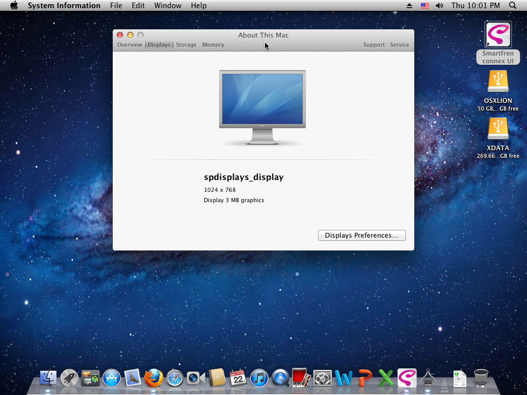

Thanks for your guide verdant... I am considering on use A Mac OS X Retail DVD or DVD Image and follow yours or iBifteki guide for OS X installation. :wink2:
BTW, now I'm running Mac OS X Lion 10.7.2 directly from my SATA HDD connected using USB to IDE Converter Cable. And as you've said before that nForce 630i is AHCI Compliant, so... we all know what would happened if it connected via IDE/SATA Cable for Boot Volume. :hammer:
OK, now I'm confusing why My ALC888 SoundCard doesn't work and I got not optimal graphic performance...!? While, my GeForce 7050 / nForce 620i has 256 MB RAM...? :weight_lift: Were there any mistake I choose during "Customize"-ing section (I choose all of Realtek ALC888, AppleHDA & VoodooHDA on Sound section)?
Please help me fix this problem, I wanna learn more about OSX... :thumbsup_anim:

1. Graphics Performance
OS X does not supported integrated shared RAM graphics pre-9000 series......nVidia GeForce 7050 uses shared memory.......it is not supported by OS X, so you cannot get full CI/QE with it........
Run in basic VESA mode with your native display resolution set in com.apple.Boot.plist, by doing as follows:
After rebooting by typing -s at the boot: prompt and waiting for the prompt
:/ root# to appear, type each of the following lines, followed by Enter and then waiting for :/ root# to re-appear:
mount -uw /
cd /System/Library/Extensions
mv GeForce.kext GeForce.kext.orig
mv NVDAResman.kext NVDAResman.kext.orig
mv NVDANV50Hal.kext NVDANV50Hal.kext.orig
mv NVDANV40Hal.kext NVDANV40Hal.kext.orig
mv NVDANV30Hal.kext NVDANV30Hal.kext.orig
ls -l
exit
"logout" will then appear on screen followed by "Jettisoning kernel linker" and the rest of the verbose booting screen, resulting in successful booting into the OS X Welcome screen and music.....
The System Profiler shows under Graphics/Displays, 1024x768 resolution 32-bit Color depth and 32MB VRAM with Software Driven CI and QE Not Supported, and against Kernel Extension Info: No kext loaded
Modify the com.apple.Boot.plist file as follows:
1. Go to the Terminal, and at the $ prompt, type in
sudo nano /Library/Preferences/SystemConfiguration/com.apple.Boot.plist
2. Enter your password when requested. Use the arrow keys on the keyboard to move the cursor within the Terminal window.
3. Type in (without any spaces anywhere except where there are spaces)
"Graphics Mode"="1280x1080x32@60" BUT as I said using your display resolution.....
between <string> and </string> under <key>Kernel Flags</key>.
4. Move the cursor the Terminal window down until it no longer moves, then press Ctrl O and then Enter, to save the modified com.apple.Boot.plist file.
5. Press Ctrl X to Exit and type
and install no nVidia injector kext, or EFI graphics string, and do not set Chameleon bootloader GraphicsEnabler to Yes.....
Or, get an nVidia graphics card supported by OS X.....

Hi verdant, many thanks for your guides. I've followed your guides and now I got my ALC888 Sound worked well. :thumbsup_anim:
But, the problem now, I got my Graphics performance running on more & more slowly than before. At first time I've boot the OSX I saw on About This Mac - Display Info that my shared graphics has 256 MB VRAM. Suddenly, It became just 3 MB VRAM and now my OSX running like "a walking baby..."
(Once again... :wink2: ) Plz, help me fixing this problem..!? Thanks for your guides...
As I said OS X does not support your 7050 onboard integrated GPU using shared MOBO RAM and so you will not be able set up Core Image and Quartz Extreme functionality.......
Have you checked in your BIOS to see how much RAM is allocated to video.....?
My recommendation is to get a PCI-e graphics card that is supported by OS X.
Yeah, I think so. I got to upgrade my Graphics Card to a new PCI-E one. :|
(But, I don't know after my Graphics was upgraded is my nForce still supported by OS X Lion or not, the PATA/SATA HDD + DVD..., we will see next time, OK? Then, I would like to ask your guides again.. :thumbsup_anim: ).
You're the best verdant, so plz help me (at later time I think). For now, I'm focusing on learn and learn more about OSX before I use the PC for production purpose, especially for Graphic Design. This is why, I have obsession to installing this OSX on my PC beside Windows 7 & Ubuntu Linux. As other said that Mac OS X is amazing OS ever... :withstupid:
That is.., many thanks to you for your cool guides verdant... the Hardwares is still under contruction (for upgrading of course...) I will back to your topic as soon as possible, Tata for now.. :king:

I've successfully installed MacOSX Lion 10.7.2 on my nForce PC using External USB 2.0 DVD Drive and my SATA-HDD connected to USB 2.0 to SATA/IDE Cable.
Now, my already installed OSX boot & run directly from USB and almost all my hardwares (ALC888 Sound, GraphicCard, Monitor, USB Ports & Ethernet) work fine. (except my built-in CardReader doesn't work, but I don't need it frequently, any suggestion..!?)
Recently, I've tried some methods on How to enabling CI/QE for my new nVIDIA GeForce 8400GS @512 MB GraphicCard. Now, it works fine on my System with "Graphic Enabler=Yes", modified NVDANV50Hal.kext and NVEnabler64.kext installed using Kext Utility. I can play some HD Videos & RPG Games with no graphic problem and Translucent Menu Bar is Enabled.
(Although, it's not very important for me, since my GraphicCard works fine...)
But, I got "NVEnabler :: Probe fails" errror message when my System boot, and on my Display Preferences I found a wrong info with "Unknown nVidia card 512 MB graphics".
Would U like to help me solve this problem..!? :thumbsup_anim:

USB cardreaders can be and are often a problem........but see here......
As for your graphics,
1. Ignore 'NVEnabler :: Probe Fails' messages at bootup
2. Use either NVEnabler64.kext alone or Graphics Enabler = Yes in Boot.plist file but not both together......
