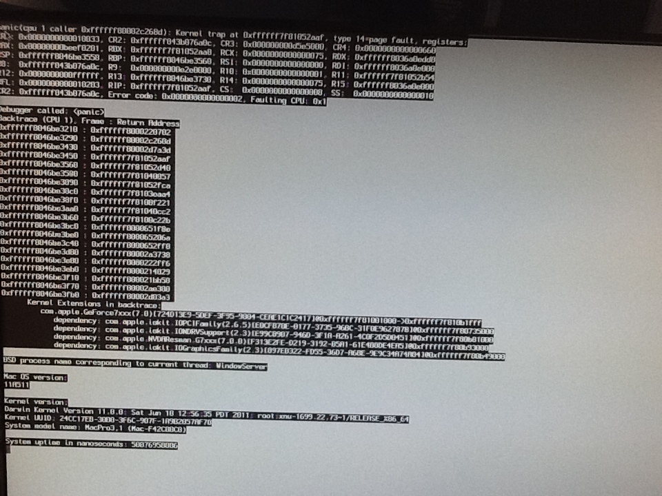

abkratch Posted July 23, 2011 Share Posted July 23, 2011 I'm running Lion GM. My graphics card works flawlessly under Snow Leopard, but fails to work in Lion. It causes a Kernel Panic! I need help, and any guidance would be very much appreciated! Thanks, abkratch Link to comment Share on other sites More sharing options...
Acid_Burn Posted July 24, 2011 Share Posted July 24, 2011 7600 Grapfics Cards works only in 32bit. Link to comment Share on other sites More sharing options...
gabby Posted July 24, 2011 Share Posted July 24, 2011 7600 Grapfics Cards works only in 32bit. You can check to delete/move this files GeForce7xxxGLDriver.bundle GeForceGLDriver.bundle Mine, is work but I have some problems with video and vlc. http://www.projectosx.com/forum/index.php?showtopic=2112 Link to comment Share on other sites More sharing options...
