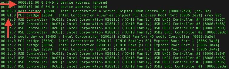

i noticed strange report by lspci.
pcilib: 0000:02:00.0 64-bit device address ignored.
it was not present with 10.6.7. could it be related to "pci configuration begin" thing ?
how to tell what device is at this address ?
uhhh..?! Gee I don't know, use LSPCI maybe?

@kerr,
I see that also under LSPCI but twice. Could that be something to do with Thunderbolt which now shows up in the System Profiler?
pcilib: 0000:0b:00.0 64-bit device address ignored.
pcilib: 0000:01:00.0 64-bit device address ignored.
It's possible that all this PCI Configuration Begin stuff is related to Thunderbolt support being added to OS X.
http://en.wikipedia.org/wiki/Thunderbolt_%28interface%29
I guess this could also explain why it's affecting graphics.
It looks to me like the address referred to in LSPCI is that of the PCI Bridge. This is the place where the PCI Root UID goes..

Be careful with your wording - LSPCI is not ignoring a device, it is ignoring the 64-bit address of a device.
LSPCI ignoring, not recognizing or complaining about a device has no bearing on the functionality of the device. If anything, LSPCI just needs to be updated.
