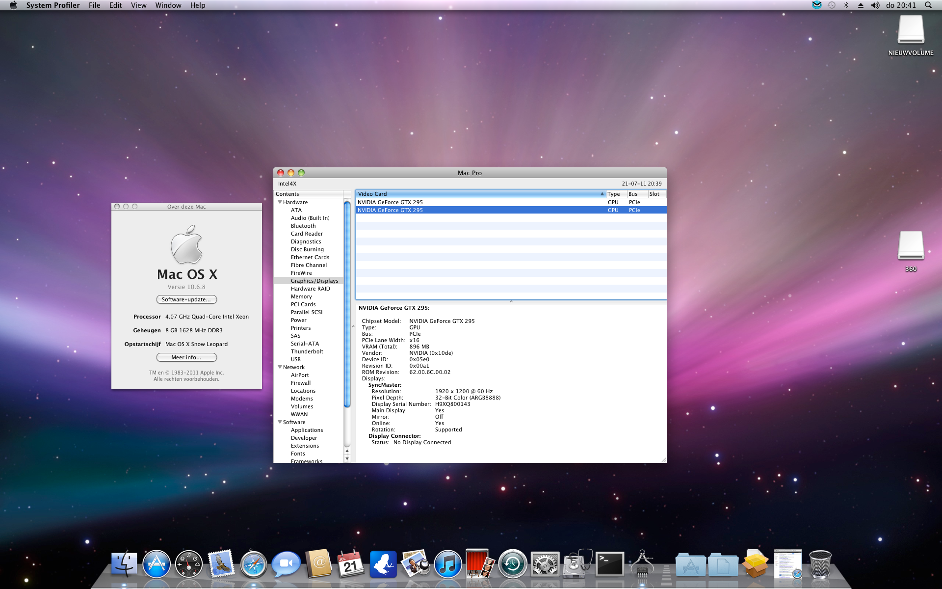

Posted 21 July 2011 - 06:56 PM
Confirmed working on a my Asus ENGTX295 dual-pcb edition using 10.6.8.
For the dual-pcb edition you need to set:
<key>device_type</key>
<string>NVDA,Parent</string>
For BOTH gpus as pointed out by meroy.
Then remove (also for both gpus) :
<key>name</key>
And you're good to go :-)
Here's my gfx.plist:
Thanks for everything!
Screenshot below...

i used the link you post to generate my .Hex when i get it to work on my 10.6.7 first time, now to generate my new .Hex i edited the dualpcb.plist that comes in there and manage to get the new .Hex, put it and give it a try, blue screen with the mouse cursor showing, nothing more, the i tried installing the pkg that you mention but it was worst, screen goes black again and then reboot it self.
anyone manage to get GTX295 dual pcb to work with lion?
