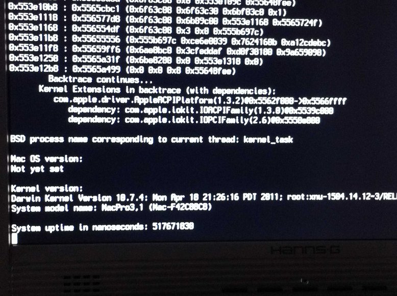

In mobo I have
i7 2600,
4 GByre RAM 2x2,
old 8400GS working perfectly on other builds
Using [url="http://www.insanelymac.com/forum/topic/279450-why-insanelymac-does-not-support-tonymacx86/"]#####[/url] 3.0.4, HackBoot V6 and other boot cd and Retail SL 10.6.3.
When swap to SL DVD I have an ACPI kernel panic. See attacment.
This is what I have set in bios:
- Intel Turbo Memory = Disabled
- ACPI Settings = S3
- SATA mode = AHCI
- CPU Config:
- Boot Freq Ratio = 32/30/29/...
- Hyper-Threading = Disabled
- EIST = Disabled
- C1E = Enabled / Disabled
- CPU Thermal Monitor = Disabled
- CPU C3 Report = Enabled / Disabled
- CPU C6 Report = Enabled / Disabled
- HPET = Enabled
- Internal HDMI Audio = Disabled
And various combination of them.
Tried flag -x -v busratio=29/30/32... cpus=1 and various combination.
Windows 7 64bit installed and working perfectly, so no hardware problem on build.
I tried both bios version F2 and F3 with same results.
Thanks to all in advance for help.

How did you get the 10.7.4 kernel installed, where did you get it?
It is not installed.
I boot from [url="http://www.insanelymac.com/forum/topic/279450-why-insanelymac-does-not-support-tonymacx86/"]#####[/url] 3.0.4 from tonymacx86 and then swap on 10.6.3. DVD.

This screenshots show the sequence of the boot process:
From HD with 10.6.7 [url="http://www.insanelymac.com/forum/topic/279450-why-insanelymac-does-not-support-tonymacx86/"]#####[/url] and bridgehelper installed on another pc:
Posted Image
Posted Image
Posted Image
Here the screenshots for boot from [url="http://www.insanelymac.com/forum/topic/279450-why-insanelymac-does-not-support-tonymacx86/"]#####[/url] and then swapped SL DVD with -x
Posted Image
Posted Image
or
Posted Image
Posted Image
Sorry for bad quality but I have recorded screen with camera.

The mobo returned from maintenance but still non way to boot in OS X. With a GA-Z68MA I managed to boot 10.6.7, 10.6.8 and Lion (10.7).
With same HD, changing only mobo, no way to boot, neither with safe (-x) nor single user mode (-s).
With 10.6.7 and 10.6.8 the problem is still KP on ACPI.
With Lion I have a reset at boot, at some point before graphics init, either with safe and single user mode.
Now I'm investigating on this point.

Here's a DSDT.aml fixed automatically with DSDTFixer from evosx86 guys. If that doesn't work I'll look into fixing it manually.
Attached File  DSDT.aml.zip   10.51KB   58 downloads
Remember, just unzip it, and put it in /Extra folder. Also be sure you are using the 10.6.8 or Lion version. If you are using Lion you need one of the latest Lion compatible Chameleon versions.
Take pictures to see how far you reach with this DSDT.aml.
I hope we have success. This seems the ONLY compatible 1155 mobo easily avaible everywhere .
On the other hand, I'm not so sure about Protools HD not working in non Q67-Q65-B65-C20x mobos. Some Asus mobos have a different pci bridge than the Gigabyte ones (which are the only which have been reported as non working with PT)
EDIT: if the DSDT was extracted from F3 bios, you need that bios installed. Also don't forget to include the disabler.kext in /Extra/Extensions
Also if you are trying with Lion keep in mind you need a different FakeSMC.kext at your /Extra/Extensions
Here is latest Chameleon which includes different kext depending on the OS X version you are (Lion or Snow)
Attached File  Chameleon_2.0_RC5_r1173_bin.zip   1.39MB   97 downloads

According to what I've seen in the F3 DSDT, a modded DSDT is essential to get this mobo working.
This motherboard (surprisingly) doesn't include many of the OS X DSDT specific fix which Gigabyte have been including in their latest motherboard as default.
So don't understimate the need for a fixed DSDT.
If you have windows working you can extract your current DSDT with IASL.EXE and this command
IASL -g
Send me the files which this command creates and I'll create a fixed DSDT.aml for F5

I guess you can get the dsdt from linux but, it's linux working? Probably you have to set the acpi=off flag. Also you need the iasl binary for linux.
About how to patch the dsdt, I mainly follow the instructions in DSDTSE from Evosx86 guys, and also some self-knowledges.
Just to sum up a bit and be sure we all are taking in mind the basic steps. In order to run osx in that motherboard you need:
- A properly configured bios: AHCI on, (you better disable hyperthreading by now), HPET on, etc...
- An already clear 10.6.8 / 10.7.0 installed system. You don't need bridgehelper at all. Both system have native sandybridge support.
- Latest Chameleon installed http://www.insanelym...p...st&id=98264
If you are not too used to command line just use any of those chameleon (not [url="http://www.insanelymac.com/forum/topic/279450-why-insanelymac-does-not-support-tonymacx86/"]#####[/url]) installers, and then replace the boot file in the root with the one in the /i386 folder in the zip I've posted.
Also create an /Extra folder and put there the fixed DSDT.aml, the included smbios.plist, and a Extensions folder with:
AHCIPortInjector.kext
ATAPortInjector.kext
IOAHCIBlockStorageInjector.kext
and the Disabler.kext and fakesmc.kext for the OS X version you have installed.
Also keep in mind apple.com.boot.plist in /Extra is no longer used in newest Chameleon. The file has to be named: org.chameleon.Boot.plist
This is all you need in order to get OS X working at a basic level. Additionally you might need to add one or several of these kernel flags:
PCIRootUID=1
maxmem= 4096
busratio=29
npci=0×2000

Without Video
Attached File  dsdt_01.aml.zip   10.54KB   55 downloads
Video(Intel HD video)
_DSM into device
Attached File  dsdt.02.zip   10.55KB   33 downloads
kext Lion
Attached File  AppleIntelSNBGraphicsFB.kext.zip   217.88KB   35 downloads
Thanks to rimmi2002(kext)
