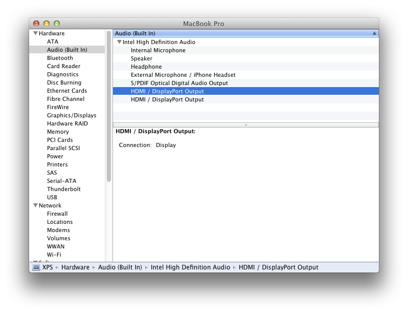

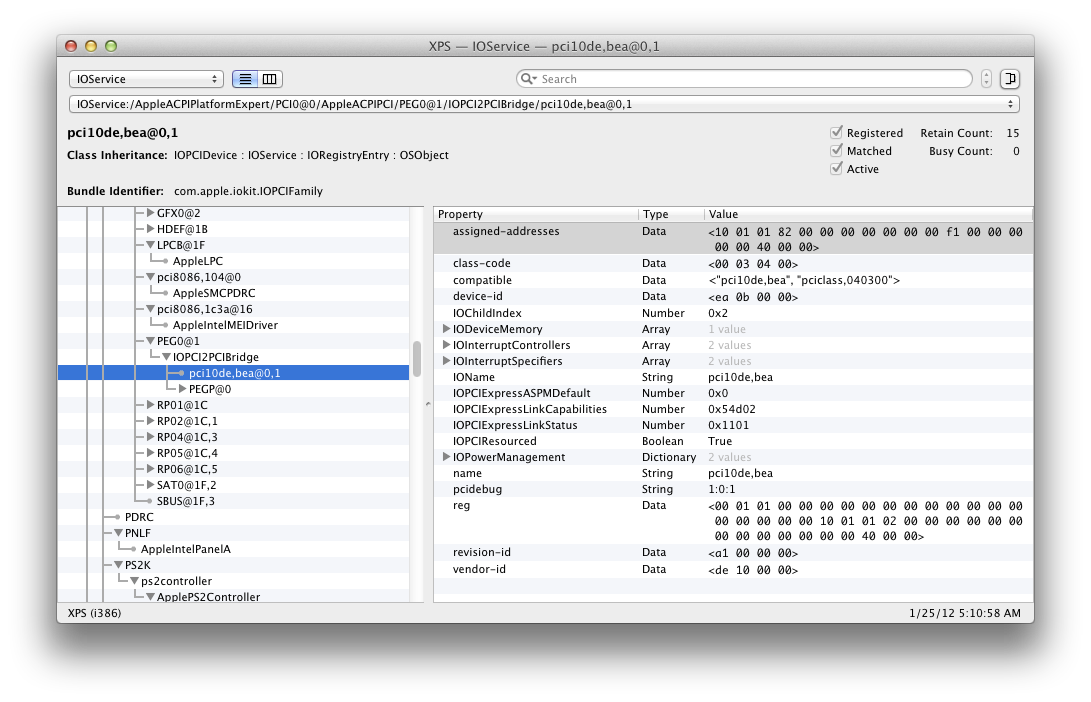

Thanks, i'll check it now. That's actually the Audio Chip powered on the card, which is another step forward. And yes you are correct, around 200 DSDT lines.
Set the 0200 value on the 000000c line to 0300 try with 3000 or 0000 too, if i got the OS X drivers right... setting the value to an error would emulate the same kickstart you get from rotating

For me i guess it would be IORegExplorer, because it has a detailed GUI. Oh i forgot, there is also the Kext Wizard option, simply load into Kext Info the kext you want to delete and check it's dependencies.
The kext requires some heavy patching, atm it's out of my interest... i'm just glad the audio part of the card is being powered which im pretty sure it means the whole card is powered (my battery drains even faster). This means that the DSDT part is done, now i have to focus on some kext that isn't loaded.
