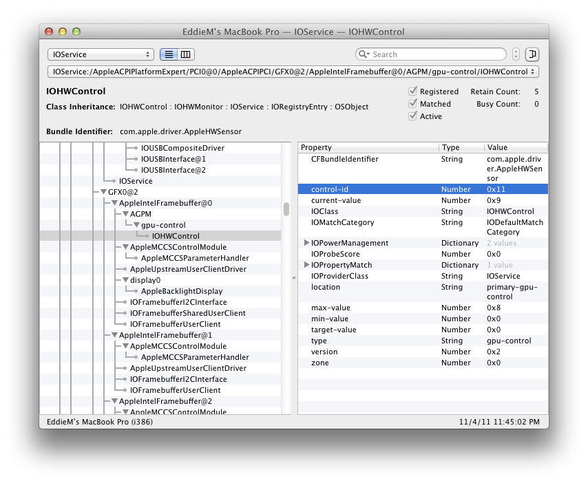

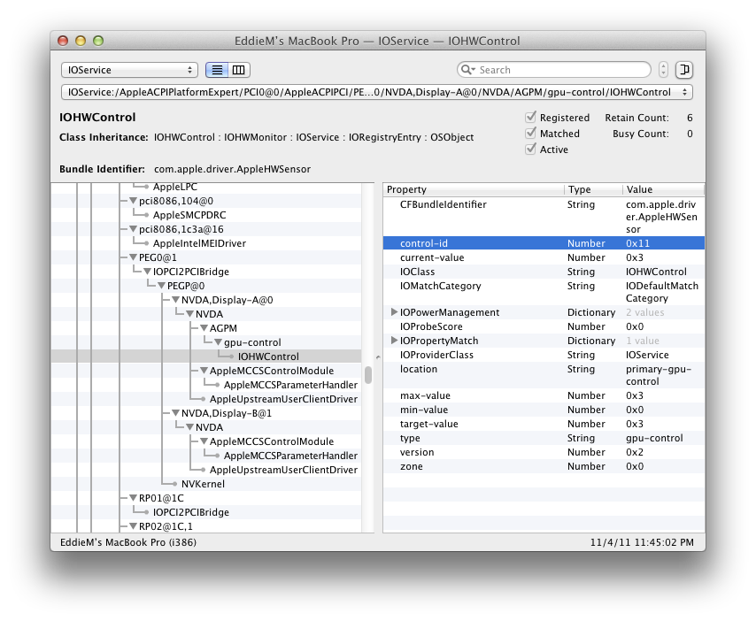

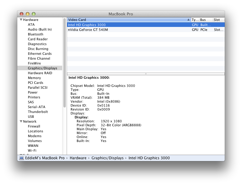

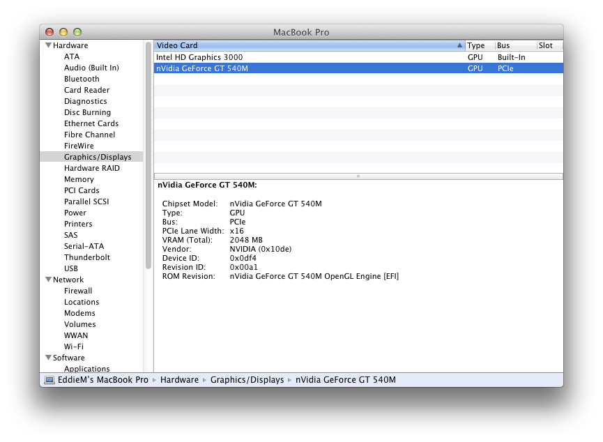

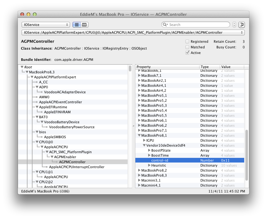

EFI one try DSDT another try, IORegistry reports the same thing in both cases, it appears to get powered and used to some extent but not fully, atm im trying to get my hands on a rom dump from gt540m, i only have W7x64 and damned be dell bios (mbr) i reached the max numbers of partitions so i can't install a 32bit windows.
I'll install the 32bit windows today and I'll send you the rom dump from gt540m :D
Thank you, please also post your card id (if its not 0df4 or 0df5)
Edit: well im out of ideas and im too tired to continue this (been awake for more than 24 hours)
post-167221-1320443309_thumb.pngpost-167221-1320443316_thumb.pngpost-167221-1320443325_thumb.pngpost-167221-1320443331_thumb.pngpost-167221-1320443344_thumb.png
Next step would probably be generating proper NVCAP from ROM, if it will work properly then i will mod Chimera to auto inject whatever this GPU needs so we can use GraphicsEnabler=Yes, or proper Optimus modified DSDT...
If anyone has an idea or something please share! :D
