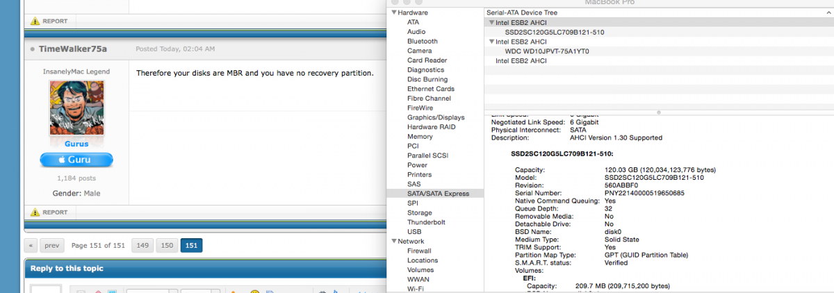

I bought a internal hard drive, eSATA to SATA Cable, format hard drive with GPT format. Instal With Yosemite Zone.
