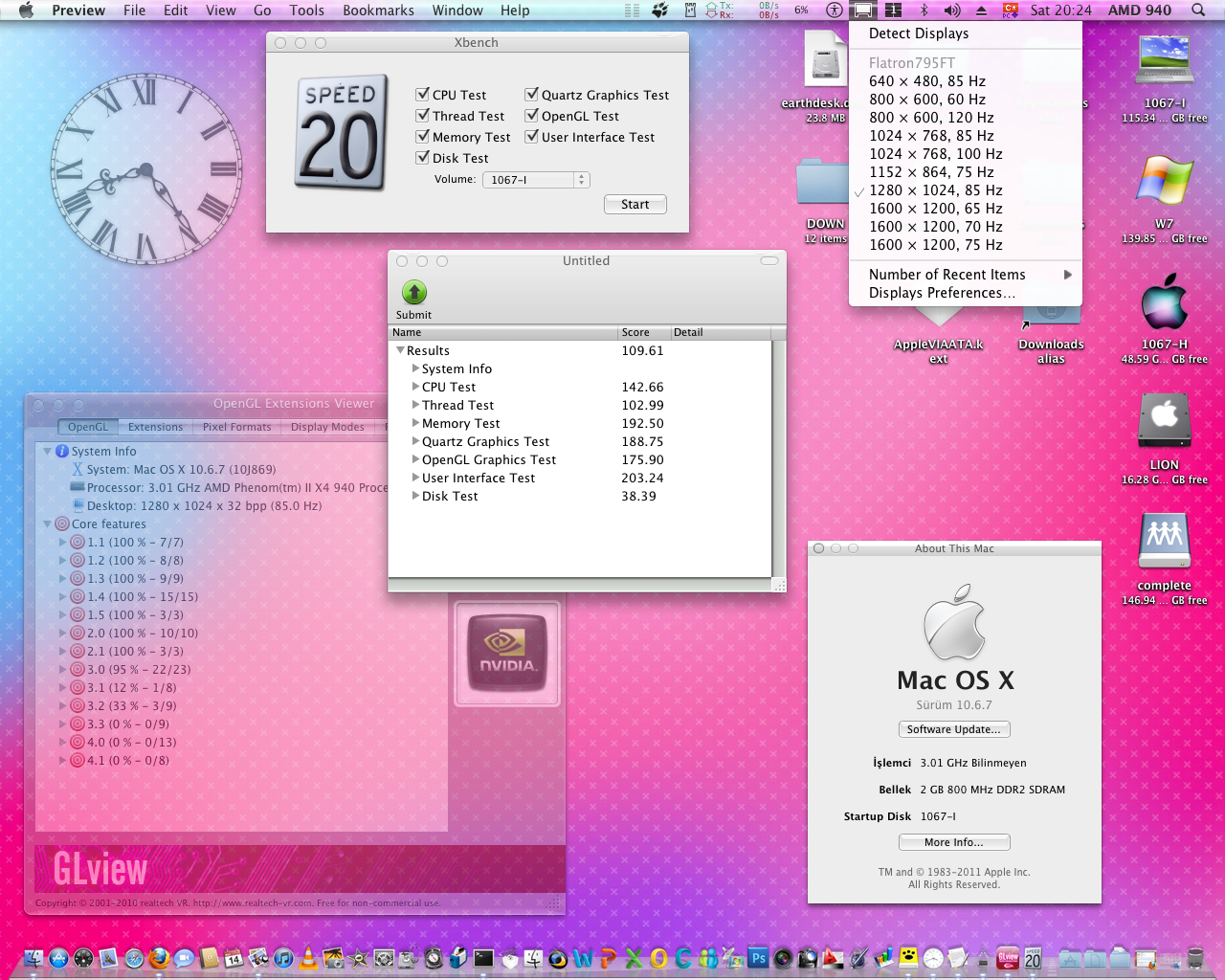

There will not be resolution and QE
but, in "about this mac", more info, graphics ; your vga card will be recognized full by name and ram,
additional pci card will be (that is hdmi audio) there, too
But if u do GE=No, you ll now have full resolution and QE,
this time your vga card name will become unknown; that s the only negative part of it ;)
and your pci card info (hdmi audio) will be lost...
Unknown nVidia card:
Chipset Model: Unknown nVidia card
Type: GPU
Bus: PCIe
PCIe Lane Width: x16
VRAM (Total): 1024 MB
Vendor: NVIDIA (0x10de)
Device ID: 0x10c3
Revision ID: 0x00a2
Displays:
Display Connector:
Status: No Display Connected
Flatron795FT:
Resolution: 1280 x 1024 @ 85 Hz
Pixel Depth: 32-Bit Color (ARGB8888)
Main Display: Yes
Mirror: Off
Online: Yes
Rotation: Supported

boot options; -v arch=i386 cpus=1 busratio=?
If u boot with blue screen, wait a little and reset/restart for 2. or 3. times...
I ve tried crt mon. on vga port, dvi port gives a total black screen, didnt try hdmi as i have no cable for now.
