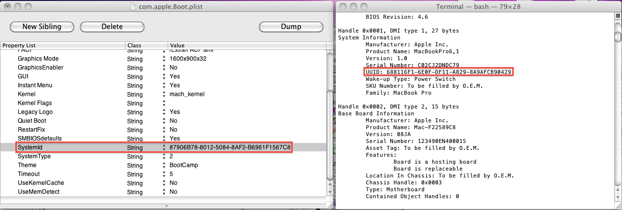

What's wrong with hardware UUID overriding? Doesn't work here.

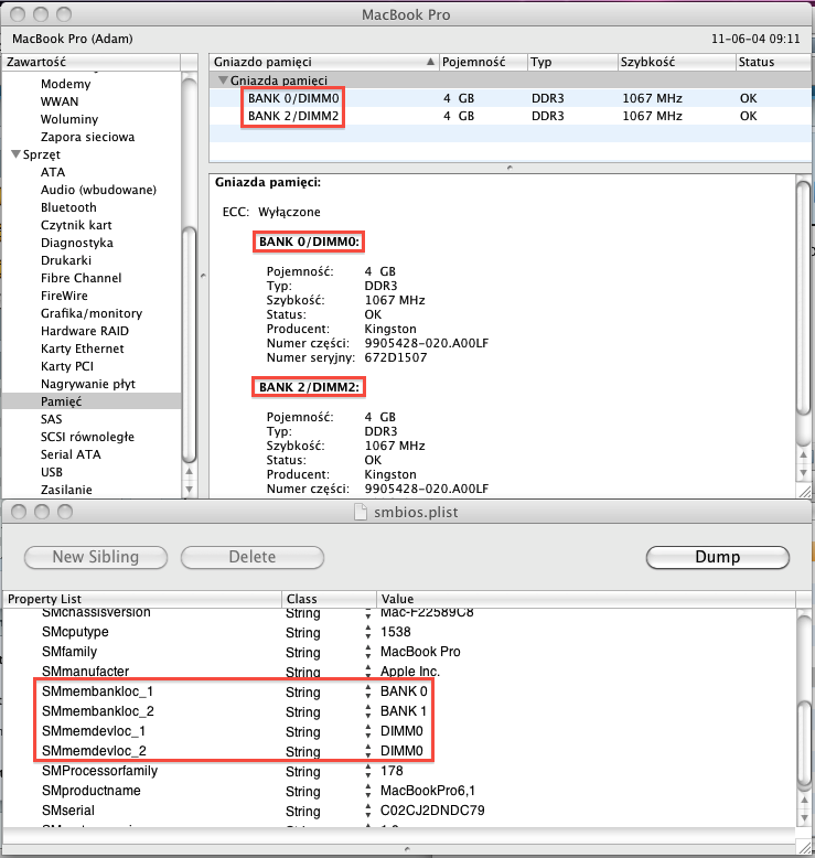

SMmembankloc_X and SMmemdevloc_X overriding doesn't work now too.
Why do you want to override the hardware uuid? On the picture, the uuid on bdmesg should be the real hardware uuid of your machine; check bdmesg near the end for this line "Customizing SystemID with :..." and see if it's the same. That uuid is added to ioreg "IODeviceTree:/efi/platform/system-id" in it's real format and "IOService:/IOPlatformUUID" on a converted format for use on System Profiler (Hardware -> Hardware UUID).
About SMmembankloc and SMmemdevloc, at least the modules info seems correct; did you tried checking that on Windows with Everest or similar tool? If not, do it and if it doesn't match, get an ioreg dump and file an issue at:
http://forge.voodooprojects.org/p/chameleon/issues/
I had the feeling those were disabled on the old code... not sure...

Kabyl,
I found a regression in chameleon's handling of smbios memory information with my nvidia-chipset system. Patch #861, included this change:
Index: libsaio/smbios_getters.c
--- libsaio/smbios_getters.c	(revision 860)
+++ libsaio/smbios_getters.c	(working copy)

Prior to this change, my motherboard's memory info could be specified manually in smbios.plist thru the SMmem* keys. With this change, the system errors out on any reporting for the memory section.
Hope this is an OK place to report this.

I think your issue is related to this:
http://forge.voodooprojects.org/p/chameleo...o/smbios.c#L378
The syntax has changed, there is no underscore.
I am not using any underscores in my smbios.plist. I don't see any syntax change that you're referring to.
When I posted those 3 globs, it was because I was sure that they are what caused the regression. I know this because I checked out r861, tested it (result: failure), reverted those 3 globs, tested (result: success). The current mainline, r1000 also fails.
