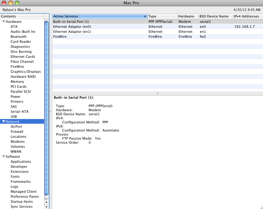

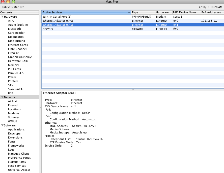

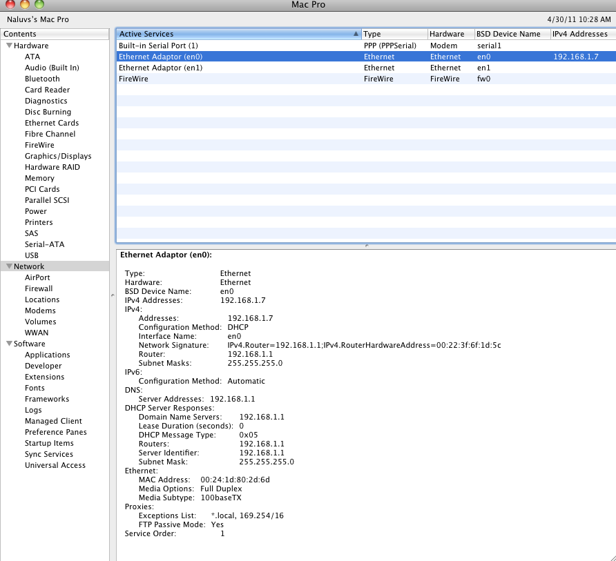

naluvs01 Posted April 30, 2011 Share Posted April 30, 2011 I have two LAN ports and they are en0 (port 1) and en1 (port 2). I have the e-net cable plugged in port 1 and both ports work flawlessly. As far as the PCIRoot is concerned, I'm not sure how to check this. Also I noticed you mentioned something about QE/CI. I don't know if this pertains to me or not. By the way, I have built hackintosh systems by following specific instructions from guides here. I'm a little familiar with adding strings to the com.apple.Boot, but my level of experience is no where on par with you guys, so I apologize. But I'll get there eventually now that I'm on the Hackintosh path for LIFE. Anyway here is my com.apple.Boot list. <?xml version="1.0" encoding="UTF-8"?> <!DOCTYPE plist PUBLIC "-//Apple//DTD PLIST 1.0//EN" "http://www.apple.com/DTDs/PropertyList-1.0.dtd"> <plist version="1.0"> <dict> <key>Kernel</key> <string>mach_kernel</string> <key>Kernel Flags</key> <string></string> <key>Timeout</key> <key>EthernetBuiltIn=y</key> <string>5</string> </dict> </plist> Again thank you for helping me and I read that other post you posted and there was a lot of info. However, I'm not sure what part is applicable to me or where to start. Link to comment Share on other sites More sharing options...
Gringo Vermelho Posted April 30, 2011 Share Posted April 30, 2011 Pay attention to what you're doing - the poster in that thread I linked to made the exact same mistake as you. This is why I keep telling you guys to read that thread. TimeoutEthernetBuiltIn=y 5 You must follow the key/string syntax: EthernetBuiltIn y And you separated the timeout key from its string value. System Profiler does not show if your ethernet hardware is registered as built-in. You can check this with IORegistryExplorer, which, like the plist editor you should be using, is part of Xcode 3 tools. Link to comment Share on other sites More sharing options...

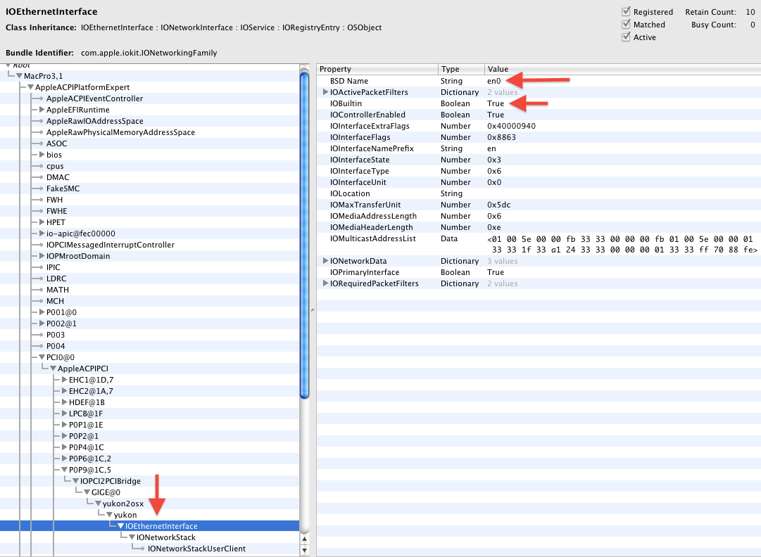

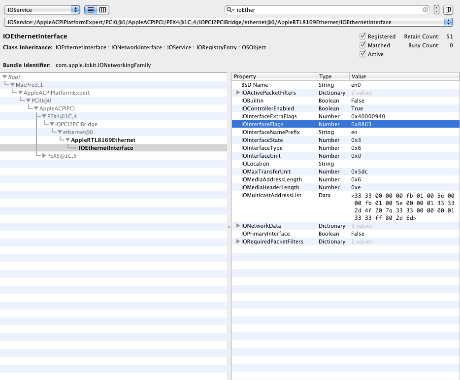

naluvs01 Posted May 10, 2011 Share Posted May 10, 2011 Thanks..I understand now the key and string part. Sorry I haven't replied in a while. Me and my wife just had another baby. I also got the X code software and you were absolutely right. The boolean is showing false like you posted. How can I fix this because I have no knowledge of how at the moment...thank again for your time. Link to comment Share on other sites More sharing options...

Gringo Vermelho Posted September 4, 2011 Share Posted September 4, 2011 I have told you everything I know. I don't know what else to say. This is the same thing that breaks App Store by the way. Look through the many threads here discussing issues with app store on 10.6.8 or Lion, you can use the same fixes for your issue (yes, really). Maybe you'll find someone in one of those threads who explains it in a better way than I did. Link to comment Share on other sites More sharing options...
naluvs01 Posted September 5, 2011 Share Posted September 5, 2011 As per my last post with a pic, I just needed to know how to change the IO Builtin to true instead of false...but I'll move on...Thanks anyway. Link to comment Share on other sites More sharing options...
Gringo Vermelho Posted September 5, 2011 Share Posted September 5, 2011 ...I'll repeat: A wired ethernet port is required at EN0 and it must be registered by OS X as "built in". There must be a driver loaded for it - but it doesn't have to work 100% - it doesn't matter if it can actually make or sustain a connection. (and here we go again) There are three things you can do to achieve this. 1. Set EthernetBuiltIn=y in /Extra/org.chameleon.Boot.plist (com.apple.Boot.plist if you are still using an older version of Chameleon). Note that on some motherboards you have to set PCIRoot=1 in your Boot.plist as well, in order for EthernetBuiltIn (and GraphicsEnabler) to work. You can also modify your DSDT so that Chameleon is able to detect the correct PCI Root automatically: http://www.insanelym...howtopic=207635 2. Use gfxutil to generate a device properties string for ethernet (already explained earlier in this thread) which you can add to the same boot.plist. http://forum.netkas.....php?topic=64.0 3. Add "built in" properties to LAN0/GIGE device via DSDT: http://www.projectos...hp?showtopic=60 After performing any modifications you will want to delete networkinterfaces.plist (full path to this file can be found earlier in this thread) and reboot. Don't waste your time trying to manually change the contents of this file, it will not stick. Link to comment Share on other sites More sharing options...
naluvs01 Posted September 5, 2011 Share Posted September 5, 2011 Thank you. I actually really screwed up my system, but got it up again. I deleted my Networkinterface.plist and kind of messed everything up (my graphics card, StartupItems folder and some other audio usb drivers). However when I restarted, the IOBuiltin was set to true. I then got the locking code I needed, but my graphic's card wasn't displaying properly. Good thing I kept the kext installers for my motherboard and graphics card from Lifehacker. Reinstalled and everything runs great. The only problem I have now is VMWare says it can't connect to virtual machine and I'm getting errors stating everything in my StartupItems (HP Trap Monitor, PACESupport, BRESINKx86Monitoring, VirtualPCOSServices and other items) can't run because the security settings aren't set. Hopefully, reinstalling the drivers will fix this....Again thank you for your time. Link to comment Share on other sites More sharing options...
