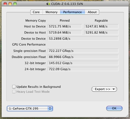

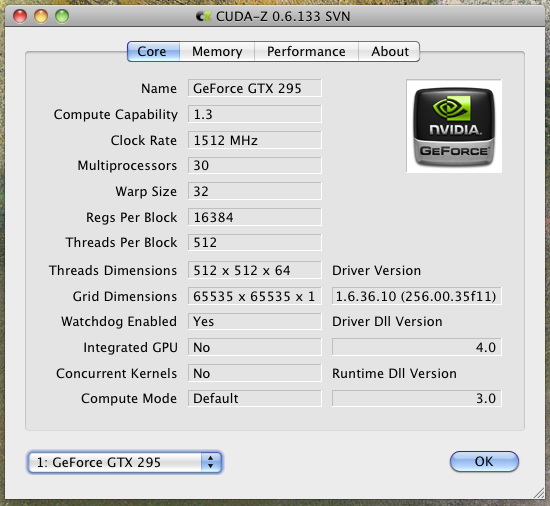

Hi all. My GTX 295 Co-op edition is up and running in Snow Leopard 10.6.8 using Apple's native drivers in 10.6.8 and the OpenGL framework. There are 2 GPUs on this card, therefore x2 the results.
I added a post to a thread on insanelymac to give solution for GTX 295 owners who want to update to 10.6.8:
http://www.insanelymac.com/forum/index.php...p;#entry1716804
Basically, there are changes made in 10.6.8 which render the existing EFI string useless unless 2 extensions are installed in /Extra/Extensions.

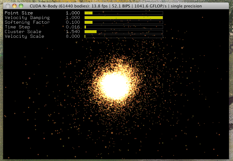

The following is the result of combining both GPUs on the GTX 295 card for the N-Body demo in CUDA 4.0.
./nbody -numdevices=2 -n=61440 -benchmark
[nbody] starting...
Run "nbody -benchmark [-n=<numBodies>]" to measure perfomance.
-fullscreen (run n-body simulation in fullscreen mode)
-fp64	   (use double precision floating point values for simulation)
-numdevices=N (use first N CUDA devices for simulation)
> Windowed mode
> Simulation data stored in system memory
> Single precision floating point simulation
> 2 Devices used for simulation
> Compute 1.3 CUDA device: [GeForce GTX 295]
61440 bodies, total time for 10 iterations: 697.011 ms
= 54.158 billion interactions per second
= 1083.161 single-precision GFLOP/s at 20 flops per interaction
[nbody] test results...
PASSED
Great nbody result!

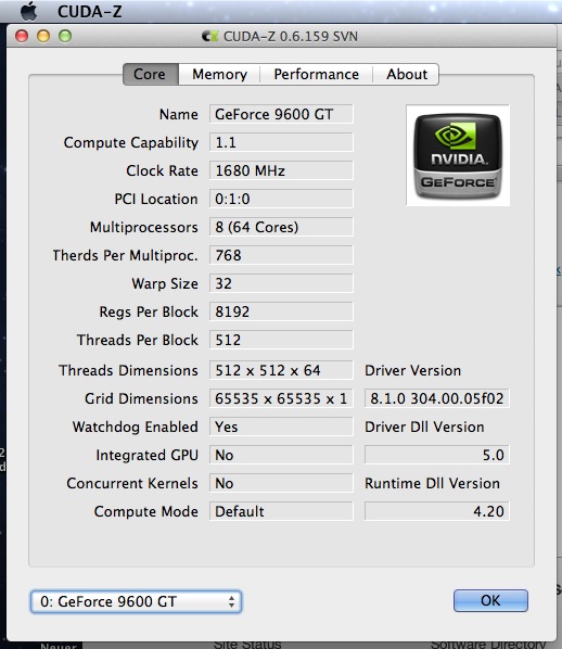

Here my 9600GT:
nbody -n=61440 -benchmark
[nbody] starting...
Run "nbody -benchmark [-n=]" to measure perfomance.
> Windowed mode
> Simulation data stored in video memory
> 1 Devices used for simulation
> Compute 1.1 CUDA device: [GeForce 9600 GT]
61440 bodies, total time for 10 iterations: 4812.126 ms
= 7.845 billion interactions per second
= 156.890 single-precision GFLOP/s at 20 flops per interaction
PASSED
GA_EP35:nbody ami$

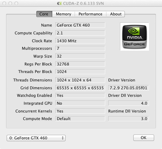

GTX 460 results :
[nbody] starting...
> Windowed mode
> Compute 2.1 CUDA device: [GeForce GTX 460]
61440 bodies, total time for 10 iterations: 2008.823 ms
= 18.791 billion interactions per second
= 375.829 single-precision GFLOP/s at 20 flops per interaction
PASSED

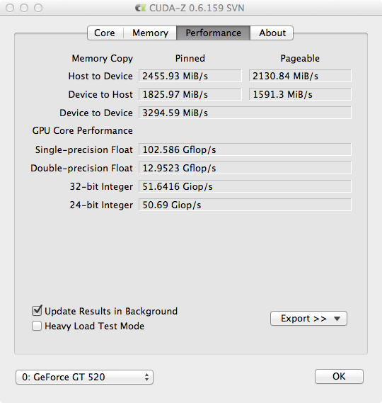

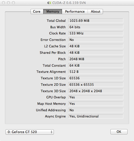

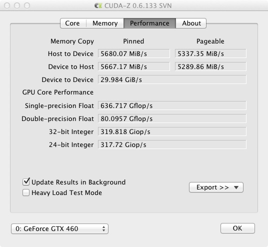

Performance Tab : Device to Device Speed shows VRAM Speed.
In your case, GT 520 , you can see that that value is not good, because of limited (Bits) vram bandwidth of GT 520 (GT 420, GT 620) and others using 64/128 Bit instead of 256/384 Bit.
Host to Device or Device to host values (VRAM copy/access over PCI-E) are mostly limited by PCI-E Speed and way less than transferspeed onboard VRAM.
