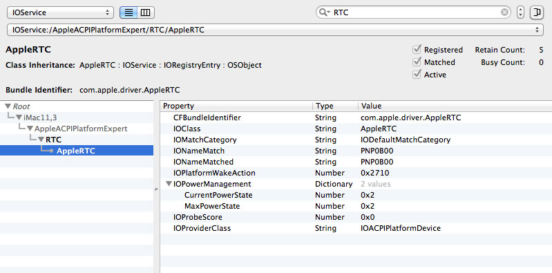

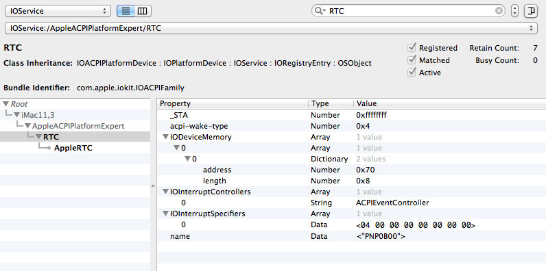

Apple usually write a length of 8 in RTC, that would make port 70 busy until 77.
So, if you are really curious about this issue and are not using stuff that reads your mobo's I/O ports (like the itf kext) you can find and remove

Some possible fixes for the problem:
ATTENTION: TOTAL THEORIZATION, Just posting because i can not try it myself and need feedback;
Adventurers may try to insert _FIX to their RTC, also, we can try changing the alignment to 1 and play with the irq something like:
				Device (RTC)
				Name (_HID, EisaId ("PNP0B00"))
				Name (_FIX, Package(1) {EISAID("PNP0B00")})
				Name (_CRS, ResourceTemplate() {IO(Decode16, 0x70, 0x70, 0x1, 0x2)})
PS: The _FIX will correlate RTC to FACP/FADT
RTC wake not in fixed reg space (V1) : 0
PS2: The alignment of 1 is pure madness of mine, it is a standard of IT8720F but not used in Gigabyte's bios, after more then a year of trial and error I have found many many errors in their bios, and fixed some, sometimes they are correct, sometimes they commit unbelievable faults
PS3: Setting the IRQ to 8 will enable RTC_STS bit, what is not concomitant with the fadt/facp that says:
			  RTC_STS valid on S4 wake (V4) : 0
in both MacPros and Gigabytes.
as so, I would not recommend using it, if anyone is.
Just some ideas, sorry for posting without testing them myself (and their combination), maybe only one of the remarks I am doing solves the problem, maybe none, and maybe a combination...

As to be expected, the DumpCMOS.kext shows identical results before & after a sleep/wake cycle.
Looking at RTC in ioreg doesn't tell anything different to what we already know.
