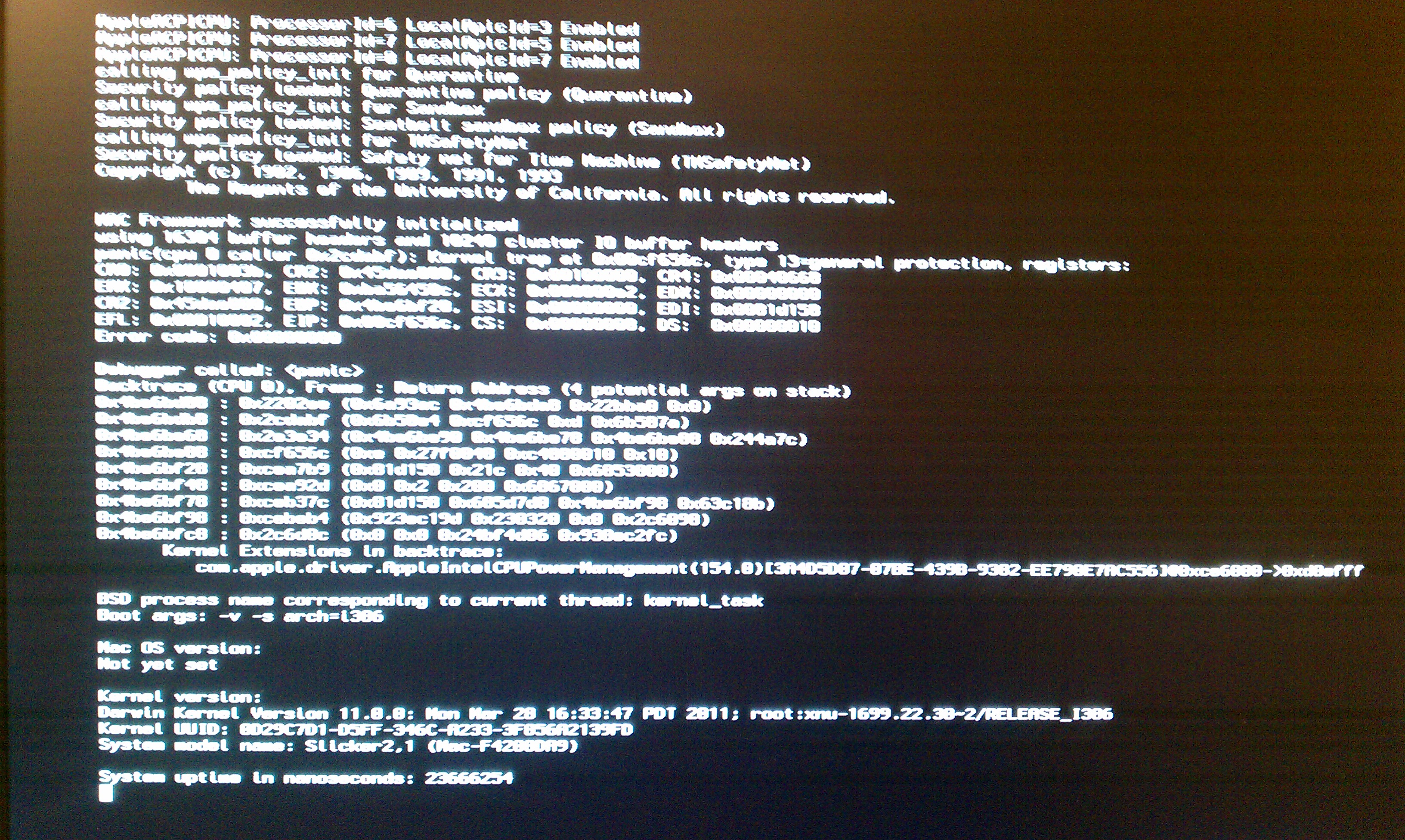

I'm trying to boot with a USB XPC drive - once the Lion install partition is booted I get a KP.
Something along the lines of "Looking for 8 args only found 9" weird..
Is Lion DP2 known to work with Sandy Bridge chips?

darkstargtk, on Apr 3 2011, 12:18 PM, said:
Hey Kyle - I've attached a picture of the KP. Any Ideas?
Hmm, I thought AppleIntelCPUPowerManagement.kext was supposed to be blacklisted by the bootloader anyway. Maybe try adding NullCPUPowerManagement the same way as with FakeSMC. If I recall correctly, you can't remove AppleIntelCPUPower Management, but I believe the Null... one is supposed to prevent this.

I've run into these issues before (personally and troubleshooting others) with the AppleIntelCPUPowerManagement.kext KP, but not on SB systems.
What I found was that even when you rename that kext in S/L/E or force the NullCPUPowerManagement.kext to load in Single-User Mode, it would still KP. It wasn't until we installed the DSDT.aml file, that this issue went away. Weird, I know.
