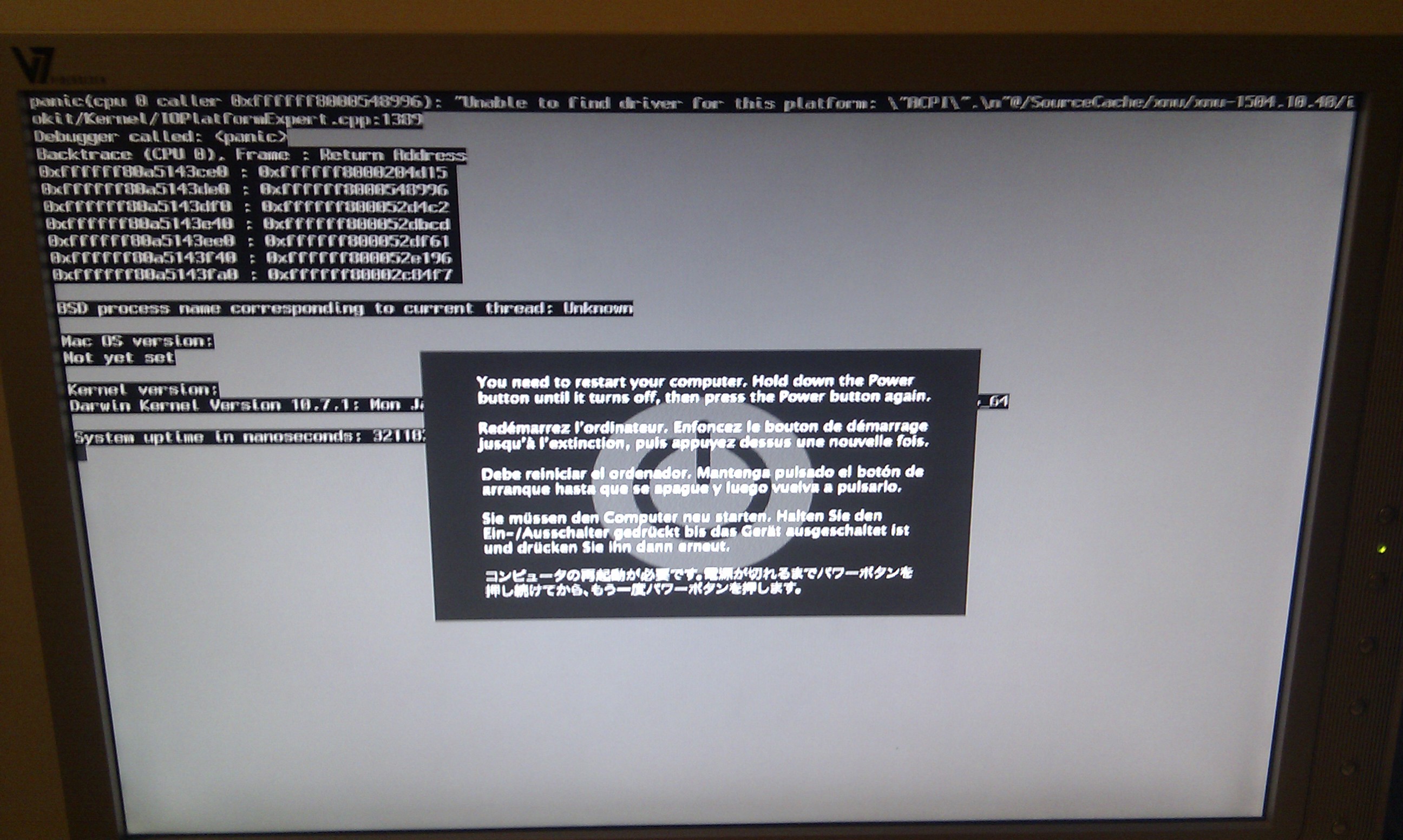

Hi Andy. Second try, this time using the latest Andy Disk, thanks for updating the iso.
The install for me went smoothly up until step 6.
Mac OS X 10.6.3 installs and loads no problem, I mount the update combo 10.6.7. It runs through to completion and says I need to restart the machine, I click and it shutsdown ready to restart.
I remove the combo update dvd and put in the AndyBoot ready for restart. On the boot selector screen I choose the Mac Instance to boot in to my updated OS X.
Within about 2 seconds up comes the dark grey screen of doom with "You need to restart your computer. Hold down the power button until it turns off, then press the Power button again."
Board - Asus P8P67 Pro - ACHI mode
2 hard disks
- SATA6G_1 (Gray) = C300 (windows)
- SATA3G_3 (Blue) = WDC WD10EADS (Mac OS X)
4GB (for now) of G.Skill RipJawsX RAM
Sapphire ATI Radeon HD 5770
Monitor - Samsung Syncmaster 226BW 1680x1050
This is my first time with OS X so it's all new to me.... treat me gently! Any ideas on where I can start to get to the bottom of this?
I have an additional network card in there so I'm going to pull that out.
I also have the windows disk in place so I'll remove that too and pray one of them does the trick.
Anything glaringly obvious that I'm doing wrong.... :)

I had the same problem. The way I got around this is to boot from "[url="http://www.insanelymac.com/forum/topic/279450-why-insanelymac-does-not-support-tonymacx86/"]#####[/url] Legacy"( you can easily find a download for it ). It's like andy boot. After you boot from [url="http://www.insanelymac.com/forum/topic/279450-why-insanelymac-does-not-support-tonymacx86/"]#####[/url], put andy boot back in and continue with the build.
Best of luck!
Best of luck!
Thanks for the response :)
I took the approach of ripping out hardware and disabling things until the OS booted correctly....
Turns out it's the Intel Gigabit Ethernet that seems to be preventing the OS X load.
With the onboard Ethernet disabled I booted/restarted OS X 10 times one after the other with no problem.
Renabled onboard Intel Gigabit ethernet and it consistently stops the load with the previous generic error (no specific errors shown behind the gray overlaid screen).
So I can now get it to boot but with no LAN enabled, everthing else is plugged back in and running with no issues....
Any ideas on how to resolve this?
Cheers, Phil
