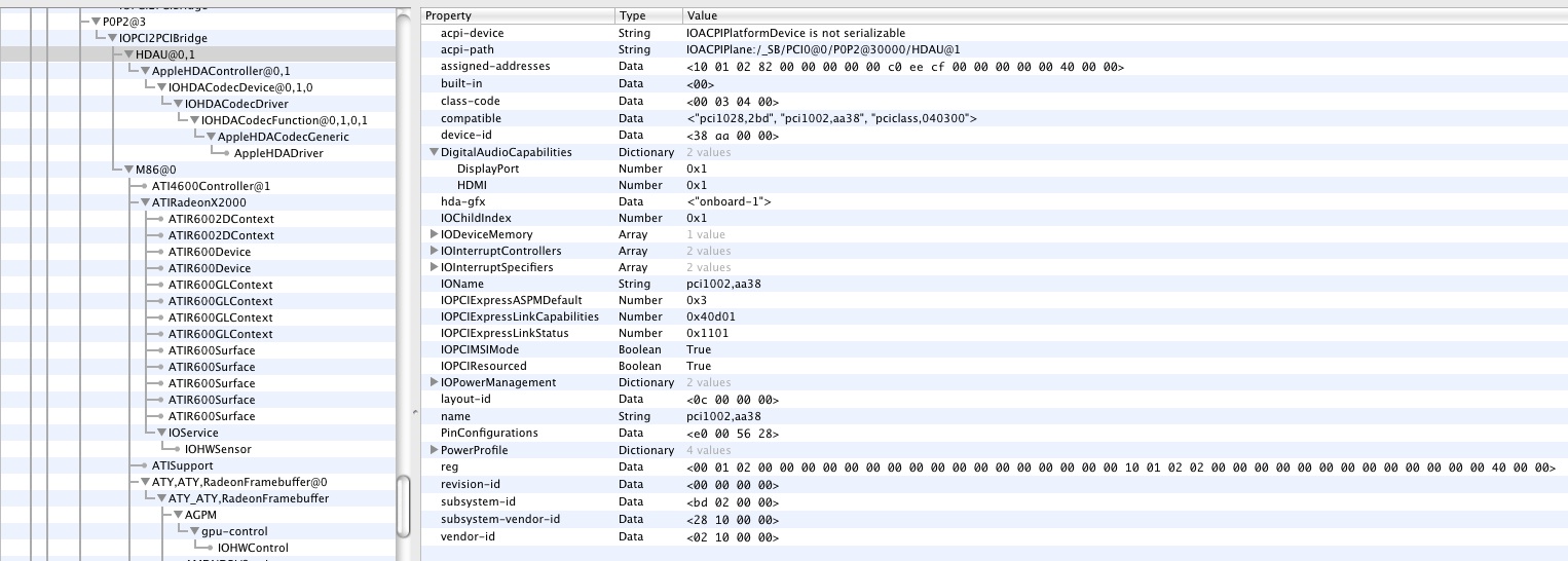

Hi tmongkol,

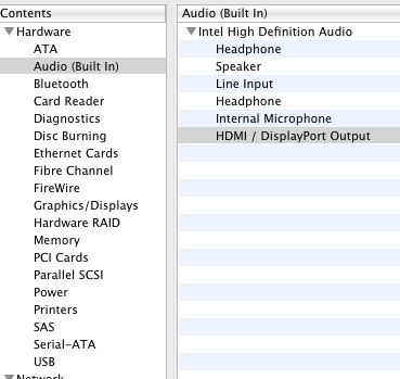

I already inject HDAU device in DSDT. System Profiler now reported HDMI audio but there is no HDMI audio in audio/sound preferences. I checked & found the device ID 0x1002AA01 already exist in AppleHDA binary. What did I miss?
#108

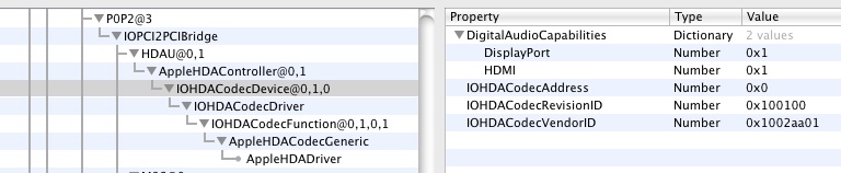

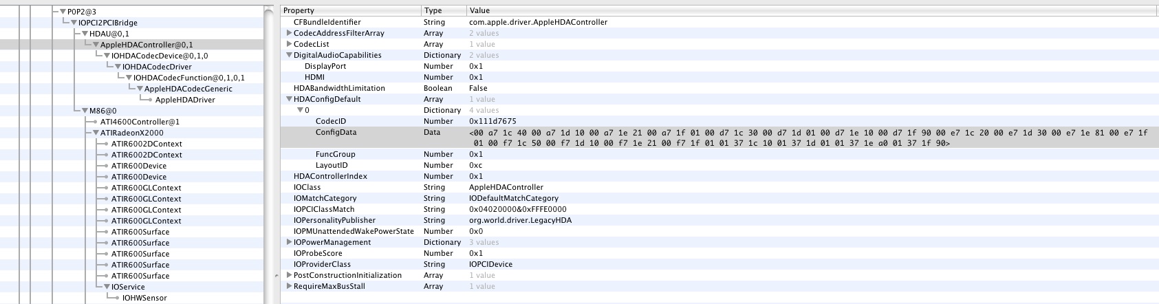

Hi tmongkol,
Attached File  100.jpg   20.18KB   46 downloads
Do you have this in IORegistryExplorer? Did you connect HDMI cable? Which framebuffer? HDMI sense-id?
Sorry for asking many questions.

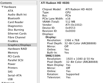

Yes, I have that in my IORegistryExplorer. Yes I did connect HDMI cable. I have "High Speed HDMI Cable with Ethernet" if that matters. :D Currently I'm using Vervet framebuffer. HDMI sense ID is 0x02. I'm using 10.7's kexts though.

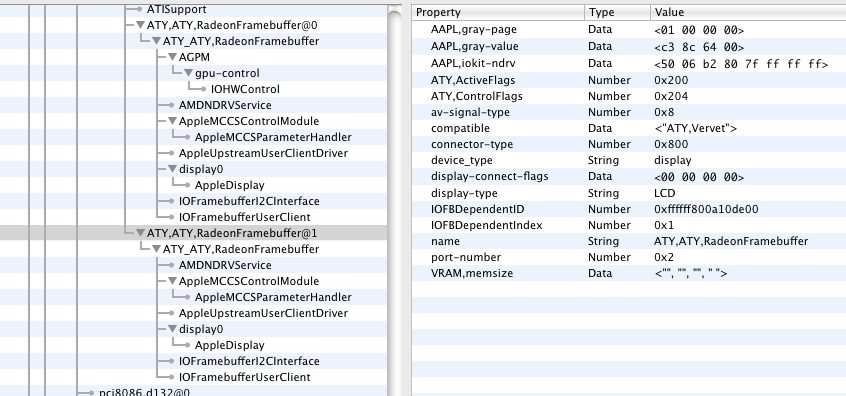

I think bcc9 means connector-type. I may be wrong about this. See the below picture from my HD5770;
Attached File  102.jpg   111.55KB   64 downloads
Hex 0x800 = Dec 2048
Did you get video output thru HDMI? If yes, can you post a picture of av-signal & connector-type.
Did you try to change senseid of Vervet?
Yes, I get video output through HDMI.
Attached File  ati_hdmi_port.jpg   121.97KB   61 downloads

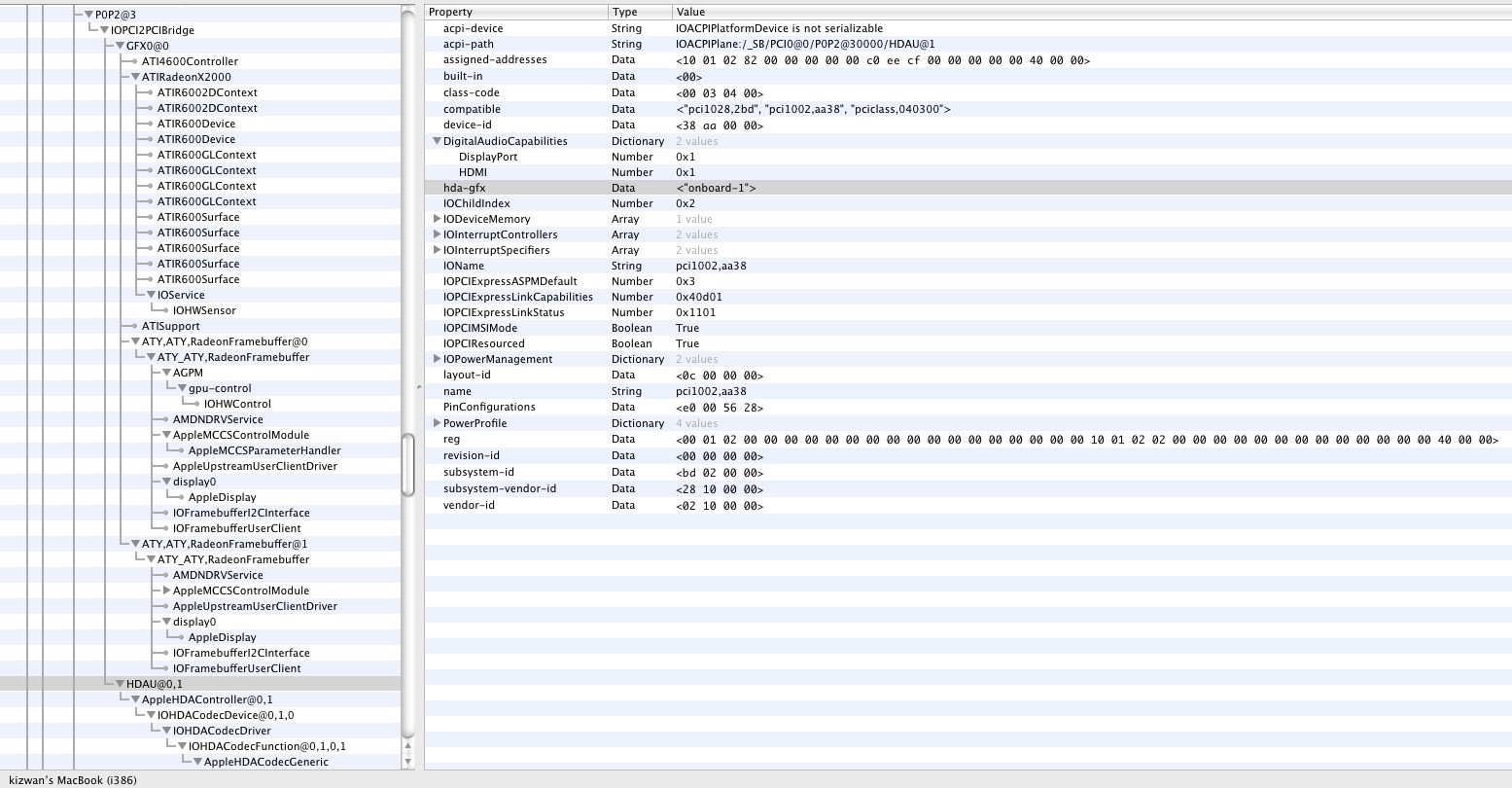

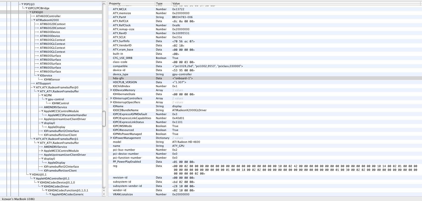

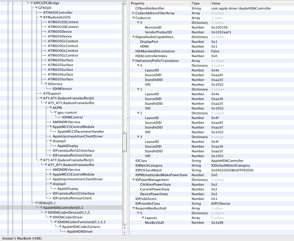

I'm using 10.7's kext. The 10.7's ATIFramebuffer is different than 10.6's Framebuffer. So I'm unable to test the senseid.
With 10.6's kexts & ATIFramebuffer patched, no output on external monitor (connected to HDMI). The display just sleep. However, monitor does detected in IORegistry with correct EDID & correct connector-type (0x800). When checked via VNC, I found QE/CI are enabled.

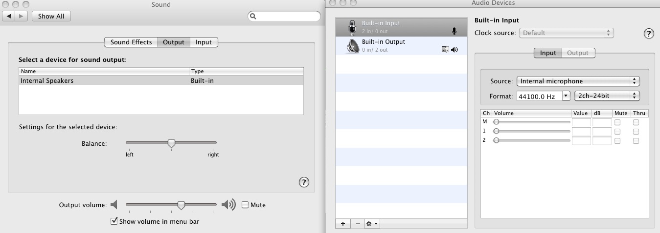

These are screenshots of the HDAU device:-
Attached File  ati_hdmi_audio_1.jpg   232.58KB   56 downloadsAttached File  ati_hdmi_audio_2.jpg   182.78KB   37 downloadsAttached File  ati_hdmi_audio_3.jpg   45.95KB   29 downloads
You should remove IOKitPersonalities of BuiltInHDA from LegacyHDA.kext as I saw the middle picture. my ati & nvidia;
Attached File  ati.jpg   122.18KB   27 downloads Attached File  nvidia.jpg   133.22KB   27 downloads
I would like to tell you from my experience. I updated OS X to 10.6.6 and tried to used old AppleHDA.kext (10.6.4) and then I could not get HDMI audio for my HD5770. After that I got to use AppleHDA.kext v1.9.9f12 and then I got HDMI audio again. I was thinking that ATIframebuffer might be related to AppleHDA.kext in some way but I had no idea how. In contrast, I got to use old AppleHDA.kext (from 10.6.2-.4) for my GT240 to get HDMI audio after updating to 10.6.5-.6. I hope bbc9 can find out something.
Yes, sorry that's what I meant. I see that he does have that value matching up just fine (as well as av-signal-type).
kizwan,
We've seen the hda-gfx under the HDAU node, but is the other matching one injecting correctly under GFX0?
If you use
ioreg -l -t -w0 > file
and send in the HDAU and GFX0 subtrees from that file then there would be no need for 20 questions about your ioregistry & screen captures :thumbsup_anim:

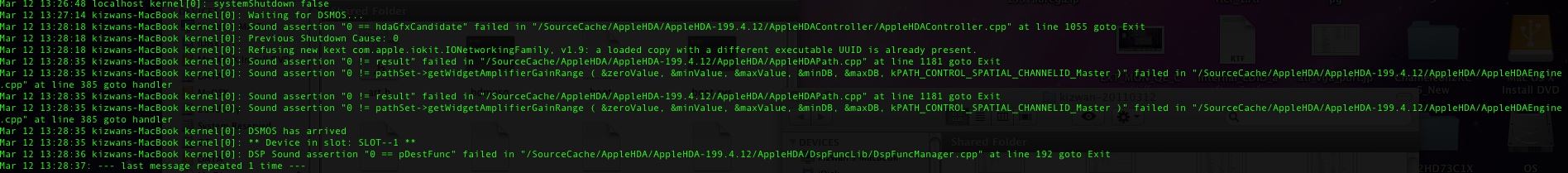

Newer applehdacontroller has specific PCI-id checks that affect nvidia (it checks for 10de:0ac0 and 10de:0d94 in framebuffererEventHandler()). Older code has no such checks.
Since the gt240 is 10de:0be4, I suspect this check is breaking your support. I think the result is that it won't find the right codec-id # for your HDMI audio.
With 10.6.6 applehda, you could try either injecting audio-codec-index into the IGPU device, for example the following if your hdmi codec is #3:i
"@1,audio-codec-index",
  Buffer (0x04)
   0x03, 0x00, 0x00, 0x00
or edit applehdacontroller changing one of those pci id matches to match your hardware.
kizwan,
If you use
and send in the HDAU and GFX0 subtrees from that file then there would be no need for 20 questions about your ioregistry & screen captures :)
There is a matching set ("hda-gfx=onboard=1") under GFX0 (or to be precised M86). This is my ioreg dump:-
Attached File  kizwan___s_1557.ioreg.zip   617.54KB   20 downloads
The hda-gfx set looks fine. I don't see anything obviously wrong from that dump. You are in a bit of unchartered ground with 10.7 video on a 10.6 system. (10.6 AppleHDA I presume).
  Buffer (0x04)
