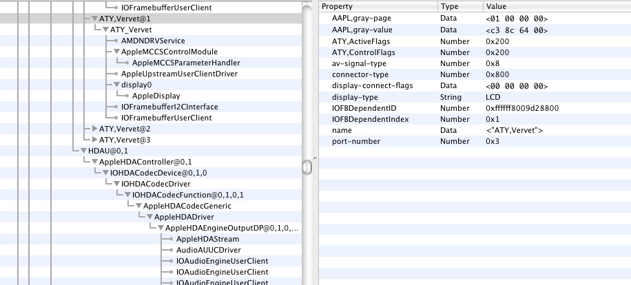

I think bcc9 means connector-type. I may be wrong about this. See the below picture from my HD5770;
Hex 0x800 = Dec 2048
Did you get video output thru HDMI? If yes, can you post a picture of av-signal & connector-type.

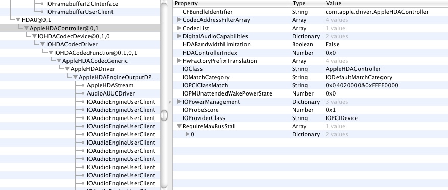

These are screenshots of the HDAU device:-
post-125711-1299771671_thumb.jpgpost-125711-1299771695_thumb.jpgpost-125711-1299771715_thumb.jpg
Yes, I get video output through HDMI.
I'm using 10.7's kext. The 10.7's ATIFramebuffer is different than 10.6's Framebuffer. So I'm unable to test the senseid.
With 10.6's kexts & ATIFramebuffer patched, no output on external monitor (connected to HDMI). The display just sleep. However, monitor does detected in IORegistry with correct EDID & correct connector-type (0x800). When checked via VNC, I found QE/CI are enabled.

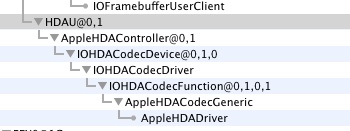

You should remove IOKitPersonalities of BuiltInHDA from LegacyHDA.kext as I saw the middle picture. my ati & nvidia;
Yes, sorry that's what I meant. I see that he does have that value matching up just fine (as well as av-signal-type).

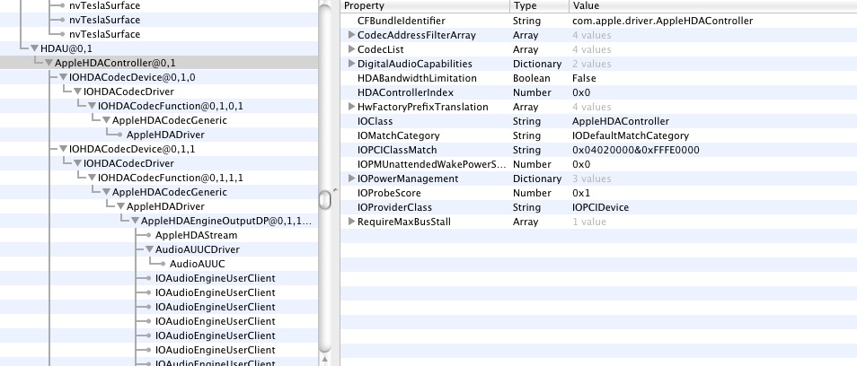

kizwan,
We've seen the hda-gfx under the HDAU node, but is the other matching one injecting correctly under GFX0?
If you use
ioreg -l -t -w0 > file
and send in the HDAU and GFX0 subtrees from that file then there would be no need for 20 questions about your ioregistry & screen captures :thumbsup_anim:
kizwan,
If you use
and send in the HDAU and GFX0 subtrees from that file then there would be no need for 20 questions about your ioregistry & screen captures :)
There is a matching set ("hda-gfx=onboard=1") under GFX0 (or to be precised M86). This is my ioreg dump:-
kizwan___s_1557.ioreg.zip
The hda-gfx set looks fine. I don't see anything obviously wrong from that dump. You are in a bit of unchartered ground with 10.7 video on a 10.6 system. (10.6 AppleHDA I presume).

I would like to tell you from my experience. I updated OS X to 10.6.6 and tried to used old AppleHDA.kext (10.6.4) and then I could not get HDMI audio for my HD5770. After that I got to use AppleHDA.kext v1.9.9f12 and then I got HDMI audio again. I was thinking that ATIframebuffer might be related to AppleHDA.kext in some way but I had no idea how. In contrast, I got to use old AppleHDA.kext (from 10.6.2-.4) for my GT240 to get HDMI audio after updating to 10.6.5-.6. I hope bbc9 can find out something.
I tried AppleHDA.kext from 10.6.2 - 10.6.6, still failed to get HDMI audio to work. I always get:-
Sound assertion "0 == hdaGfxCandidate" failed in "/SourceCache/AppleHDA/AppleHDA-179.1.4/AppleHDAController/AppleHDAController.cpp" at line 889 goto Exit
I think you probably right on the relation between ATIFramebuffer & AppleHDA. I already tried 10.7 AppleHDA.kext. It just failed to load. I guess I have to wait 10.7 (official) to get HDMI audio working.
That means the hda-gfx pair are not matching up between the audio&video drivers... You souldn't be getting that assertion failure if you have things configured right.
hda-gfx does matched up between audio & video. You did checked my ioreg earlier.
