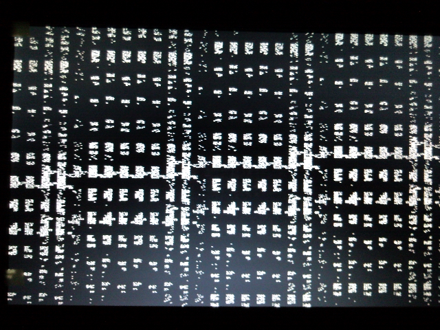

Yes I have already this:
Mac-Pro-di-fabry:tmp fabry$ od -Ax -tx1 /tmp/uakari3
0000000	00  04  00  00  00  04  00  00  00  01  00  00  12  04  04  03
0000010	04  00  00  00  14  00  00  00  00  01  00  00  01  12  01  01
0000020	04  00  00  00  14  00  00  00  00  01  00  00  00  00  06  05
0000030	00  08  00  00  00  02  00  00  00  01  00  00  22  05  05  04
0000040
but I try to change the transmitter to 0x02:
0000000	00  04  00  00  00  04  00  00  00  01  00  00  02  04  04  03
0000040

Yes, I'd recommend trying the other values for the transmitter byte, 0x2, 0x22, unless you know that the HDMI port is working right with the 0x22 transmitter byte.

The Display Port....
:D

My point was that if you know that the HDMI port is working with transmitter byte 0x22 then the HDMI port is for sure linkb and that would make the displayport for sure linka, as both your hdmi&displayport are apparently sharing phy2.

Hi Bcc9,
Can ATY,ATY,RadeonFramebuffer be edited? if i inject RadeonFramebuffer i can get perfect VGA out on CRT, if this framebuffer can be edited this would be great.
I have noticed Framebuffers have disappeared from the latest kexts, example Nomascus i cannot find it, Are they removing the personalities out and replacing with this auto framebuffer?
Regarding the Encoders and transmitters i've tried so many combinations it's no longer funny or fun :)
