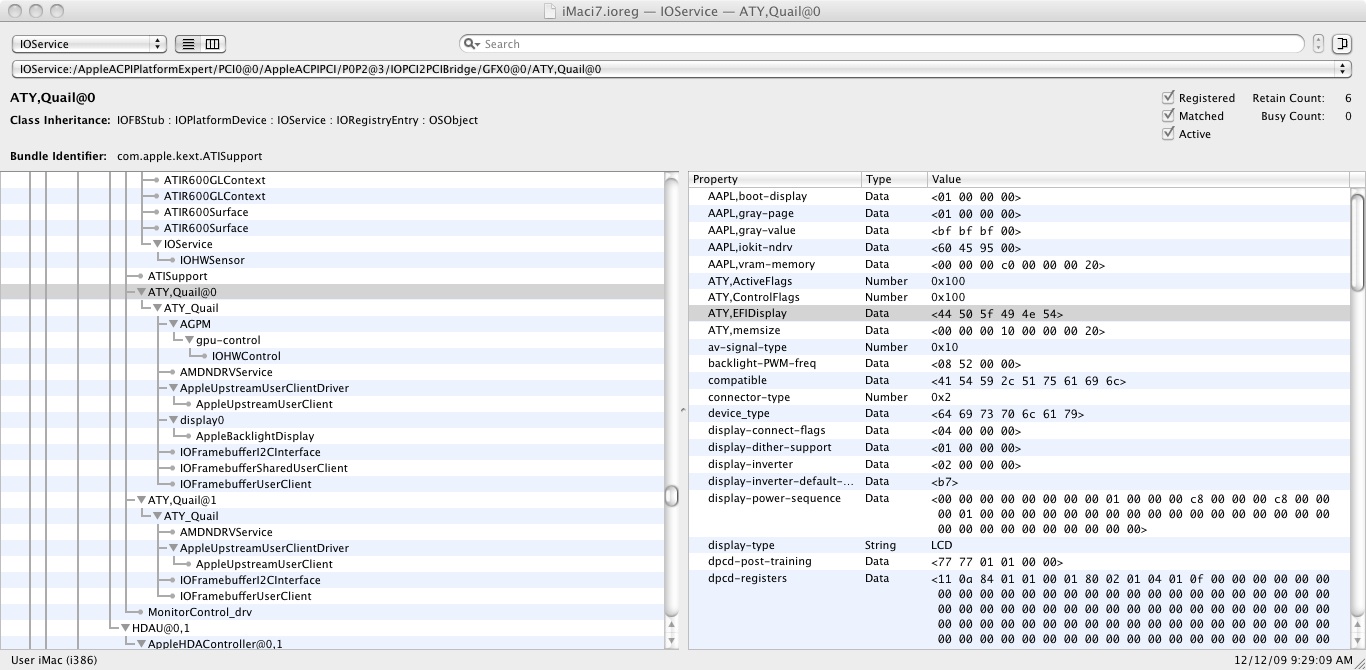

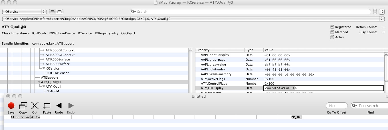

I found out connector-type=0x2 & ControlFlags=0x100 is DP_INT (DisplayPort). The "_INT" stand for internal I guess. I found this in iMac11,1's IORegistry.

LVDS will be LVDS (as printed out by ATY,EFIDisplay). It share connector-type with DP_INT which is 0x2 but LVDS's ControlFlags is 0x40 while DP_INT's is 0x100.
No, connector-type 0x400 is DP, 0x2 is connector-type LVDS. Per post #1. I've verified these personally.
Yes, DP's connector-type is 0x400. Please check the iMac11,1's IORegistry I posted at my previous post.
Already did that before posting. And now you're agreeing with me, so perhaps you might want to rephrase your original statement?

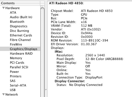

Look to this screenshots:-
I'm quoting myself here. I said DP_INT's connector-type is 0x2 is based on the iMac11,1's IORegistry. The "DisplayPort" can be seen in the iMac11,1's System Profiler (included in the zip file).
I didn't said DisplayPort's connector-type is 0x2. The DisplayPort's connector-type is 0x400. The DP_INT's connector-type is 0x2 based on the iMac11,1's IORegistry.
