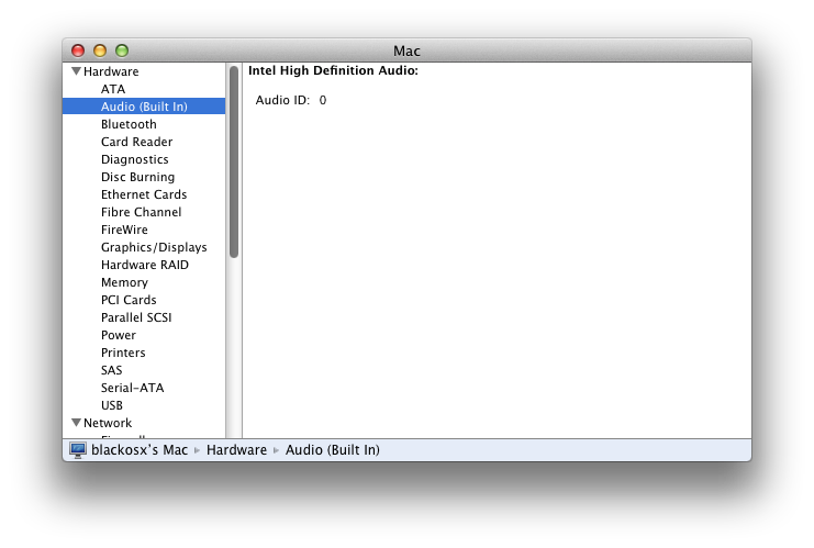

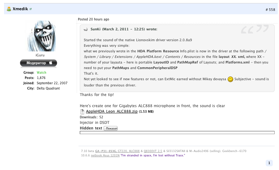

ALC888 audio is working courtesy of a solution by Xmedik from a post by Sunki
I haven't asked permission to post this so I apologise in advance if Xmedik takes offence but hopefully he won't.
I am using the Gigabyte EP45-DS3L and can confirm this works for me.
The solution comprises a patched AppleHDA.kext:
and a Device (HDEF) patch for DSDT.

I've posted the files as I've found them but I'm sure the DSDT patch can be tweaked as System Profiler/Audio currently shows me this:
But for now I'm happy.
Great work Xmedik
Regards :wacko:

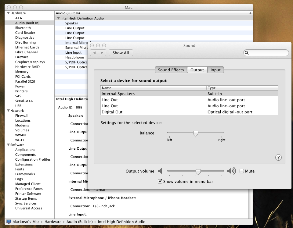

try this one => http://www.mediafire.com/?iz5znq3z176n5hd (please pay attention to the creation date of the included files :wacko: )
edit: (the DSDT part)
Device (HDEF)
			Name (_ADR, 0x001B0000)
				Return (Package (0x02)
					0x0D,
					0x05
				Store (Package (0x0E)
						"subsystem-id",
						Buffer (0x04)
							0xA0, 0x00, 0x00, 0x00
						"subsystem-vendor-id",
						Buffer (0x04)
							0x6B, 0x10, 0x00, 0x00
						"codec-id",
						Buffer (0x04)
							0x88, 0x08, 0xEC, 0x10
						"layout-id",
						Buffer (0x04)
							0x78, 0x03, 0x00, 0x00
						"device-type",
						Buffer (0x07)
							"ALC888"
						"PinConfigurations",
						Buffer (0x28)
							/* 0000 */	0x40, 0x90, 0xA1, 0x90, 0x50, 0x90, 0xA1, 0x02,
							/* 0008 */	0x60, 0x30, 0x81, 0x01, 0x70, 0x40, 0x21, 0x02,
							/* 0010 */	0x10, 0x40, 0x11, 0x01, 0x20, 0x10, 0x01, 0x01,
							/* 0018 */	0x30, 0x60, 0x01, 0x01, 0x80, 0x20, 0x01, 0x01,
							/* 0020 */	0x90, 0x61, 0x4B, 0x01, 0xA0, 0x01, 0xCB, 0x01
						"platformFamily",
						Buffer (One)
							0x00
					}, Local0)
				Return (Local0)

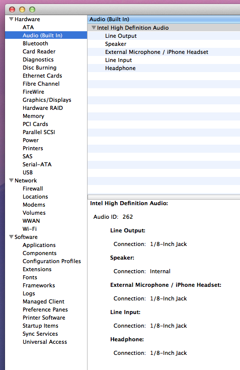

Works for my ALC262:
My Files for ALC262 (HP xw4600):
ALC262.zip
My DSDT:
Device (HDEF)
Name (_PRW, Package (0x02) { 0x0D, 0x05 })
               Store (Package ()
                     "built-in", Buffer (One) { 0x00 },
                     "layout-id", Buffer (0x04) { 0x06, 0x01, 0x00, 0x00 },
                     "device-type", Buffer () { "Realtek ALC262" },
                     "PinConfigurations", Buffer () { 0x00 }
               }, Local0)
	Return (Local0)
I hope to help :wacko:

Thank you cparm
That's a cleaner solution, audio works and System Profiler/Audio is now populated again.
:wacko:
