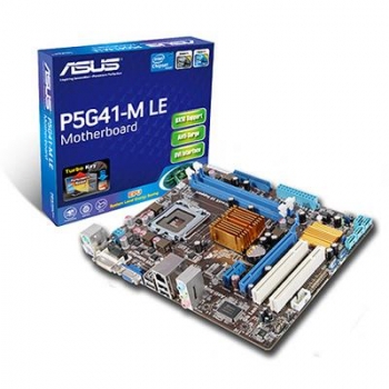

Guide to Install iATKOS S3 [Snow Leopard] in ASUS P5G41-M-LE
ASUS P5G41-M-LE
Attached File  P5G41_M.jpg   84.09K   296 downloads
It is recommended by me to have a modded bios to run snow leopard on this board.
I didn't try with the official bios update but you can try it.
Quote
Please note that for this motherboard you need to have an external graphics card as many of them said that on-board graphics didn't worked. I already had XFX Nvidia 8600GT 1GB, so I didn't even try also, but you can try it out on your own.

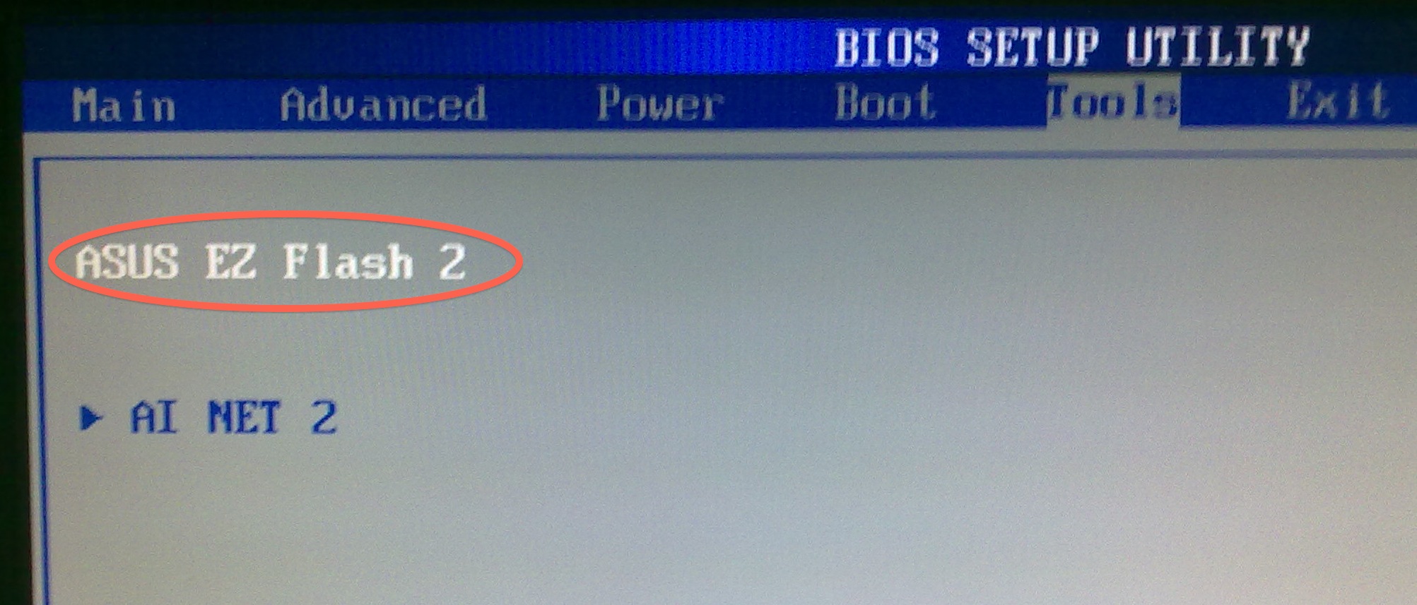

Setting Up Ur BIOS:
Update ur Bios using the modded BIOS .ram file using the BIOS TOOLS which can be found in the BIOS under Tools Menu called "ASUS EZ Flash 2" as shown below
Attached File  27022011135.jpg   364.3K   517 downloads

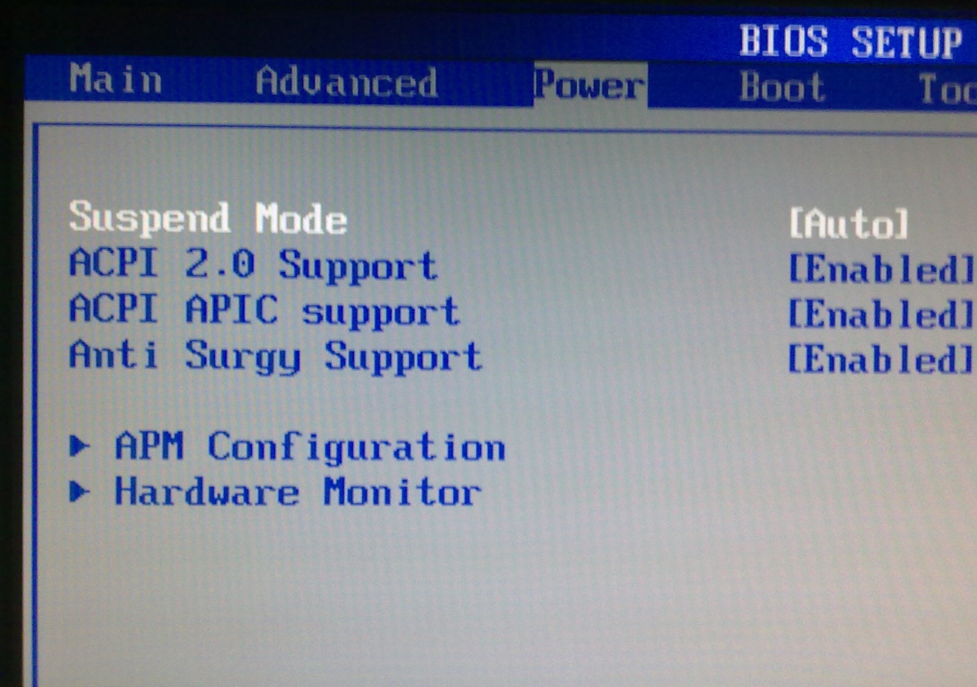

NEXT Adjust ur POWER OPTIONS from the screenshot :
Attached File  27022011139.jpg   604.57K   616 downloads

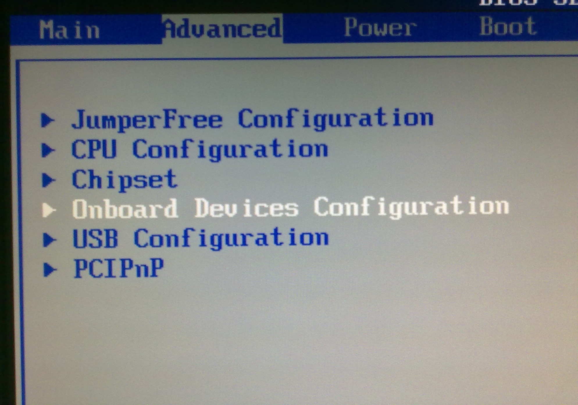

GO INTO ONBOARD DEVICE CONFIGURATION [from the menu given in screenshot] and disable Serial and Parallel Ports.
Attached File  27022011141.jpg   484.21K   482 downloads

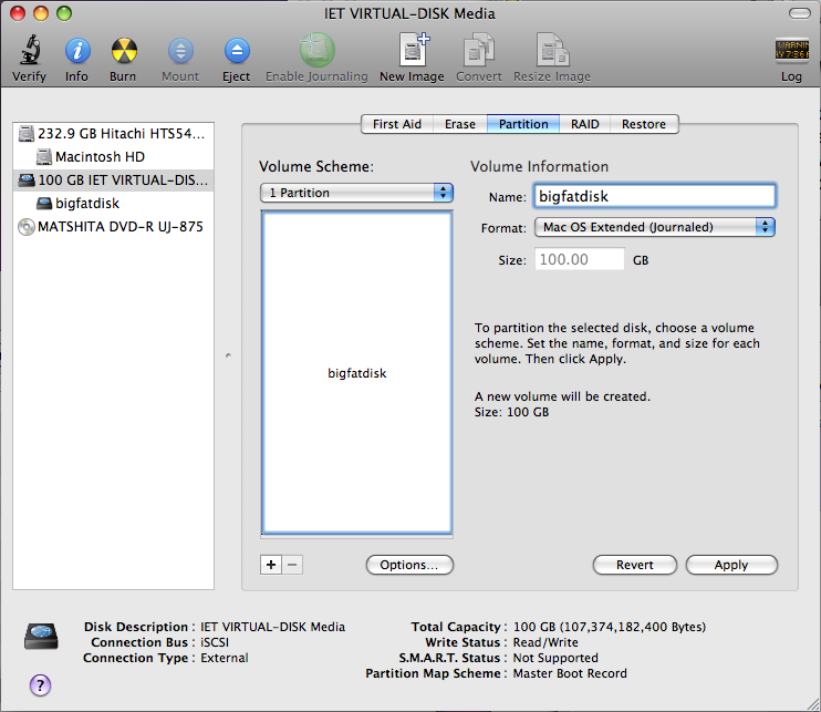

Pre-Installation Setup
Insert the DVD and let it boot. Don't worry it will boot up fine to the MAC OSX installer. From the Utilities menu select disk Utilities -> select your hard disk -> click partition tab -> select the number of partitions as per your choice from the VOLUME SCHEME -> select the MAC OSX Extended (Journaled) format but don't forget the to click OPTIONS and set the GUIDE PARTITION TABLE. Hit apply and your HDD should be ready to install Snow Leopard  :lol:
Close the Disk Utility.
Attached File  screen.png   109.69K   381 downloads

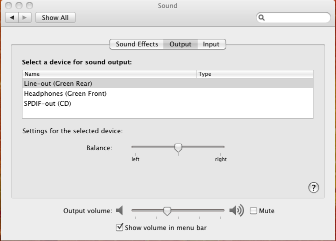

If you face Audio Problems, here is the driver : Attached File  VoodooHDA.kext.zip   153.16K   454 downloads <- This is working great  :P

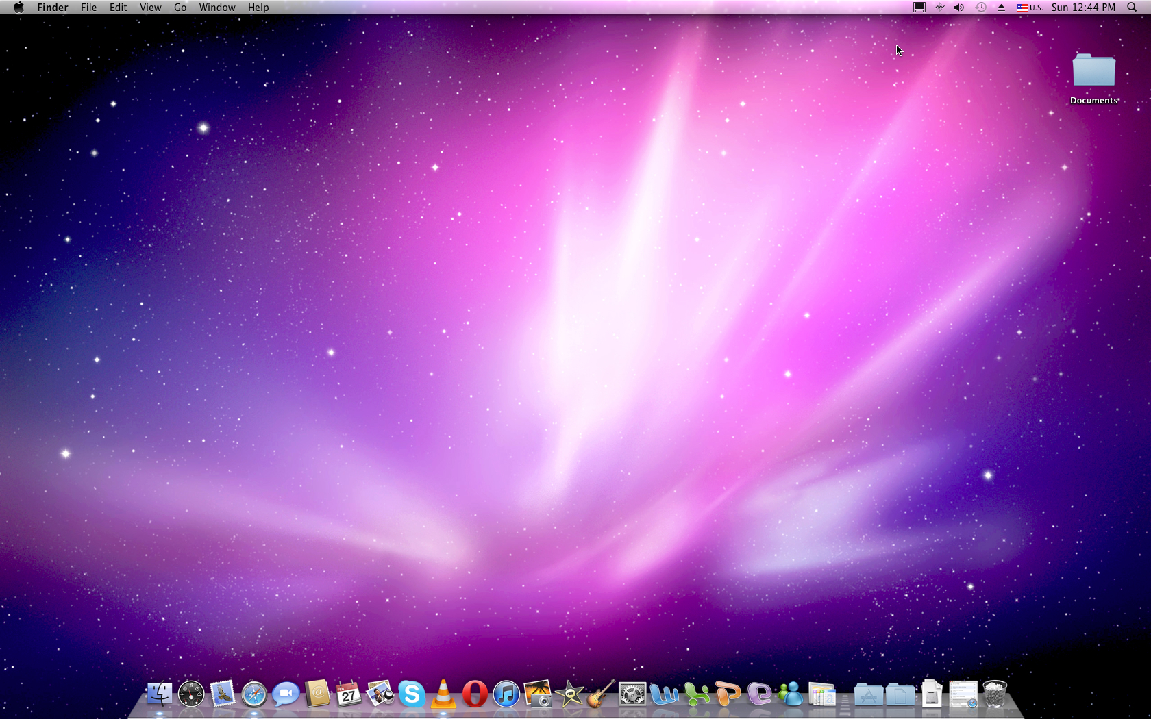

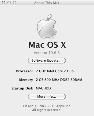

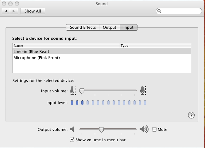

SOME SCREENSHOTS : :P
Attached File  Desktop.jpg   1.83MB   275 downloads
Attached File  screen_capture.png   33.37K   197 downloads
Attached File  8600GT.jpg   47.29K   175 downloads
Attached File  Audio_Inputs.png   44.74K   182 downloads
Attached File  Audio_Outputs.png   45.47K   153 downloads
