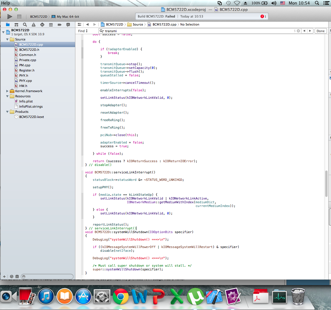

Yes, my Realtek driver is a good tutorial to show you what has to be done. I suggest you start with the queue management because this is completely hardware independent. Also take a look the documentation of the queue management functions: start(), stop() and flush(). Xcode is your friend. After you got this working properly you can add the cleanup of the transmitter ring.
void BCM5722D::serviceLinkInterrupt()
  statusBlock->statusWord &= ~STATUS_WORD_LNKCHGD;
  setupPHY();
  if (media.state == kLinkStateUp) {
    setLinkStatus(kIONetworkLinkValid | kIONetworkLinkActive,
                  IONetworkMedium::getMediumWithIndex(mediumDict,
                                                      currentMediumIndex));
  } else {
    setLinkStatus(kIONetworkLinkValid, 0);
  reportLinkStatus();
} // serviceLinkInterrupt()
This is the routine where you'll have to apply most of the changes. The general structure should be quite clear.
Good luck!

@Mieze, thanks for your help. But it seems that Register.h also has  some inaccuracy.
Here is a data sheet for bcm57781. For the time present, I haven't gain an understanding of it yet. But I don't give up.
http://www.broadcom.com/collateral/pg/57785-PG103-R.pdf
I also looked at tg3 and bge
http://www.cs.fsu.edu/~baker/devices/lxr/http/source/linux/drivers/net/tg3.c
http://fxr.watson.org/fxr/source/dev/bge/if_bgereg.h
I decided to start off with simplicity.
I added what you suggested me. But I get a mistake during a compilation.
Ld /Users/admin/Library/Developer/Xcode/DerivedData/BCM5722D-fcooihstpbdwkhezjwqbemonljsx/Build/Products/Debug/BCM5722D.kext/Contents/MacOS/BCM5722D normal x86_64
    cd /Users/admin/Downloads/BCM5722D
    setenv MACOSX_DEPLOYMENT_TARGET 10.9
    /Applications/Xcode5-DP.app/Contents/Developer/Toolchains/XcodeDefault.xctoolchain/usr/bin/clang++ -arch x86_64 -isysroot /Applications/Xcode5-DP.app/Contents/Developer/Platforms/MacOSX.platform/Developer/SDKs/MacOSX10.9.sdk -L/Users/admin/Library/Developer/Xcode/DerivedData/BCM5722D-fcooihstpbdwkhezjwqbemonljsx/Build/Products/Debug -F/Users/admin/Library/Developer/Xcode/DerivedData/BCM5722D-fcooihstpbdwkhezjwqbemonljsx/Build/Products/Debug -filelist /Users/admin/Library/Developer/Xcode/DerivedData/BCM5722D-fcooihstpbdwkhezjwqbemonljsx/Build/Intermediates/BCM5722D.build/Debug/BCM5722D.build/Objects-normal/x86_64/BCM5722D.LinkFileList -mmacosx-version-min=10.9 -Xlinker -kext -nostdlib -lkmodc++ /Users/admin/Library/Developer/Xcode/DerivedData/BCM5722D-fcooihstpbdwkhezjwqbemonljsx/Build/Intermediates/BCM5722D.build/Debug/BCM5722D.build/Objects-normal/x86_64/BCM5722D_info.o -lkmod -lcc_kext -Xlinker -dependency_info -Xlinker /Users/admin/Library/Developer/Xcode/DerivedData/BCM5722D-fcooihstpbdwkhezjwqbemonljsx/Build/Intermediates/BCM5722D.build/Debug/BCM5722D.build/Objects-normal/x86_64/BCM5722D_dependency_info.dat -o /Users/admin/Library/Developer/Xcode/DerivedData/BCM5722D-fcooihstpbdwkhezjwqbemonljsx/Build/Products/Debug/BCM5722D.kext/Contents/MacOS/BCM5722D
duplicate symbol __ZN22my_name_adlan_BCM5722D20serviceLinkInterruptEv in:
    /Users/admin/Library/Developer/Xcode/DerivedData/BCM5722D-fcooihstpbdwkhezjwqbemonljsx/Build/Intermediates/BCM5722D.build/Debug/BCM5722D.build/Objects-normal/x86_64/PHY.o
    /Users/admin/Library/Developer/Xcode/DerivedData/BCM5722D-fcooihstpbdwkhezjwqbemonljsx/Build/Intermediates/BCM5722D.build/Debug/BCM5722D.build/Objects-normal/x86_64/BCM5722D.o
ld: 1 duplicate symbol for architecture x86_64
clang: error: linker command failed with exit code 1 (use -v to see invocation)
I tried it added in several places but anytime I get the same mistake.
What is the appropriate place in the code for it?
