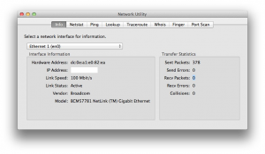

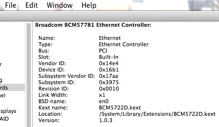

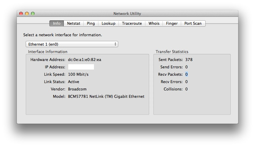

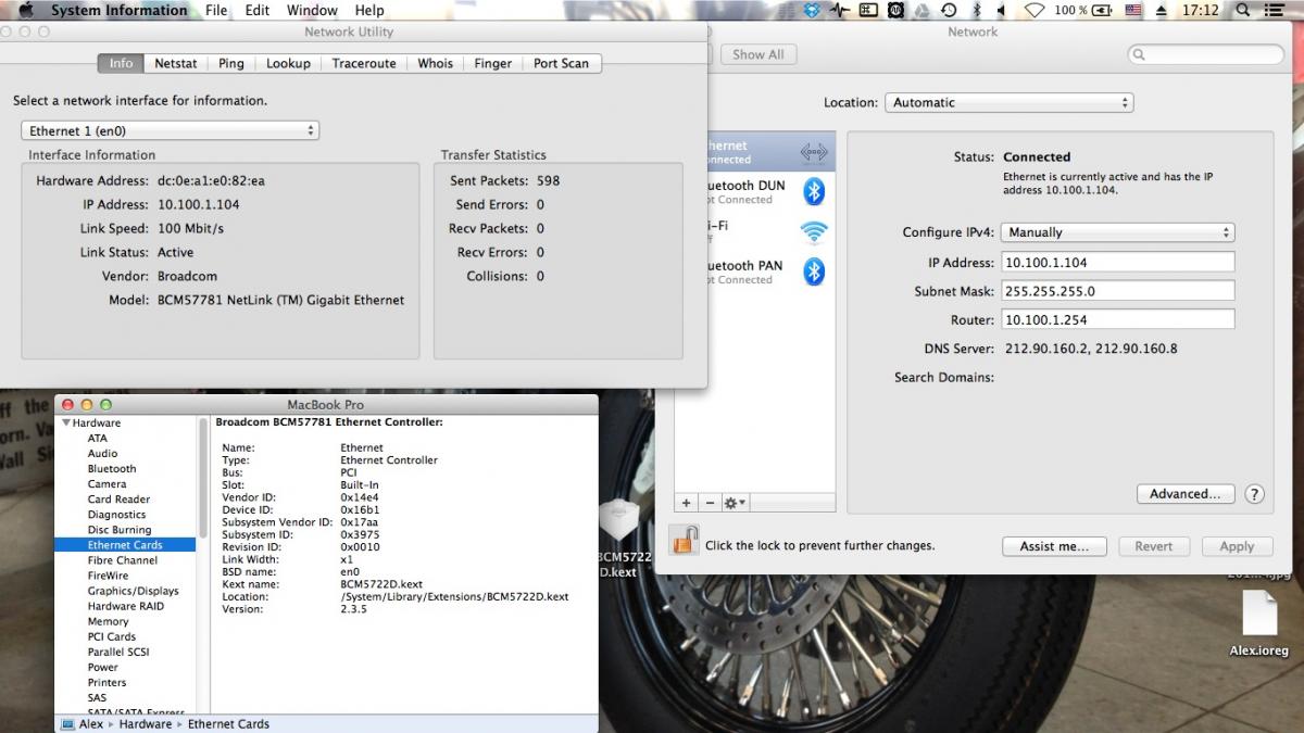

Hi. I have this chip:
Broadcom BCM57781 Ethernet Controller:
Vendor ID: 0x14e4
Device ID: 0x16b1
I download source BCM5722D-master. Add into info.plist my id, add into Register.h "#define DEVICEID_BCM57781                 0x16b1".
Then build. I got kext )))
After installation I got this results:
boot log:
2014-10-15 11:37:34 +0300 kernel[0]: BCM5722D (Build date/time: Oct 15 2014 11:13:44)
2014-10-15 11:37:34 +0300 kernel[0]: BCM5722D (resetAdapter:145): 4B657654 to B49A89AB in 1063 iterations
2014-10-15 11:37:34 +0300 kernel[0]: my_name_adlan_BCM5722D: Model: BCM57781 NetLink Gigabit Ethernet
2014-10-15 11:37:34 +0300 kernel[0]: my_name_adlan_BCM5722D: Loaded successfully
2014-10-15 11:37:35 +0300 kernel[0]: BCM5722D (resetAdapter:145): 4B657654 to B49A89AB in 4676 iterations
2014-10-15 11:37:35 +0300 kernel[0]: BCM5722D (setMedium:356): Change medium: kIOMediumEthernetAuto
2014-10-15 11:37:35 +0300 kernel[0]: BCM5722D (setMedium:381): Change medium: kLinkDuplexNegotiate
2014-10-15 11:37:35 +0300 kernel[0]: BCM5722D (configureLinkAdvertisement:555): advertiseFe: 5E1
2014-10-15 11:37:35 +0300 kernel[0]: BCM5722D (configureLinkAdvertisement:556): advertiseGe: 300
2014-10-15 11:37:35 +0300 kernel[0]: BCM5722D (startAutoNegotiation:578): Adv reg: 5E1
2014-10-15 11:37:35 +0300 kernel[0]: BCM5722D (setMedium:367): Change medium: kIOMediumEthernet100BaseT
2014-10-15 11:37:35 +0300 kernel[0]: BCM5722D (setMedium:381): Change medium: kLinkDuplexFull
2014-10-15 11:37:35 +0300 kernel[0]: my_name_adlan_BCM5722D: Advertising with limited capability, speed: 100 MBps, full duplex
2014-10-15 11:37:35 +0300 kernel[0]: BCM5722D (configureLinkAdvertisement:555): advertiseFe: 501
2014-10-15 11:37:35 +0300 kernel[0]: BCM5722D (configureLinkAdvertisement:556): advertiseGe: 0
2014-10-15 11:37:36 +0300 kernel[0]: BCM5722D (startAutoNegotiation:578): Adv reg: 501
2014-10-15 11:37:37 +0300 kernel[0]: BCM5722D (setupPHY:96): Auxillary status: F534
2014-10-15 11:37:37 +0300 kernel[0]: BCM5722D (setupFlowControl:456): flowControl: 0
2014-10-15 11:37:37 +0300 kernel[0]: my_name_adlan_BCM5722D: Link up: 100 MBps, full duplex. Flow control: disabled
And in system spec i've got. See pics i attach.
post-188311-0-48893100-1413363976_thumb.pngpost-188311-0-87767200-1413363977_thumb.jpg

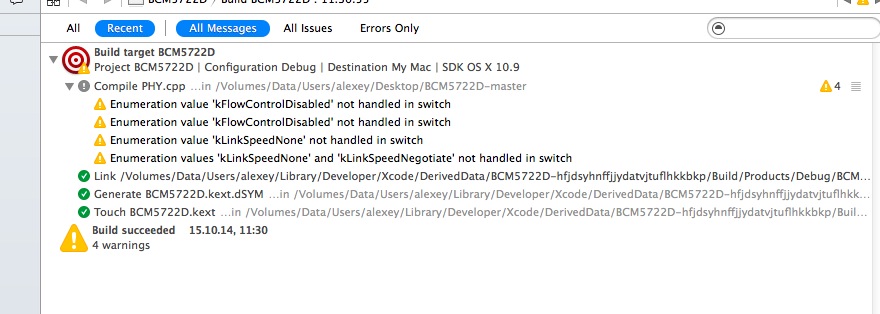

But when i make build I see warnings in log:
Kext sees chip but no Rx traffic.
Can any one help me.
