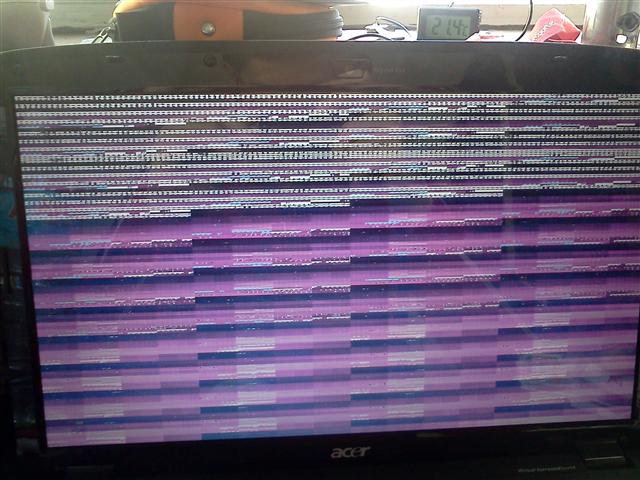

Here you can se our new corruption screen :wacko:
ATI Mobility Radeon HD 4570 @ Acer Aspire 5738ZG
Whit 10.7 developer preview kexts is a little bit different. I've a corrupted screen but no the grey one.

I've add to ATI4600Controller.kext my ID and now my laptop screen has color corrupted but Native Resolution!!! My HDMI is working pretty well!!! The colors are correct in HDMI screen. But I don't QE/CI for the moment :)
Now the ATI4600Controller and ATIFramebuffer are loaded, I think that changing the Fb we can improve it.

Hi. Now I'm testing the stock framebuffers whit Lion's kext (10.7), it's a heavy work because Kabyl's boot doesn't work for me and I'm editing the chameleon's Ati injector one by one :/.
The results of my test are these:
Flicker - Doesn't work - White draped screen
Gliff - Doesn't work - Black screen
Kakapo - 50% working - Native resolution but corrupted colors, HDMI works fine
Motmot - 50% working - Native resolution but corrupted colors, HDMI works fine
Peregrine 50% working - Native resolution but corrupted colors, HDMI works fine
Quail - 50% working - Native resolution but corrupted colors, HDMI works fine
Raven - 50% working - Native resolution but corrupted colors, HDMI works fine
Wormy - 50% working - Native resolution but corrupted colors, HDMI works fine
Nomascus - 50% working - Native resolution but corrupted colors, HDMI works fine
I'll update the list when I test more framebuffers.
