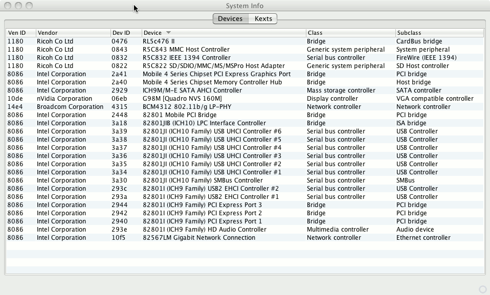

Hello,
Just updated my Dell Latitude E6400 from 10.6.3 to 10.6.6.
1. To install OSX i use this guide:
[INSTALL/GUIDE] Snow Leopard On Dell E6500/E6400 in 8 simple steps, Dual boot Windows 7 Instruction Included
I use empty DVD with this OSX - SnowOSX Universal 10.6.2 v3.6 Intel Only, this works fine on my E6400.
2. Then, after add kext from this tutorial:
64-bitHackintosh Specifically for the Latitude E6400/E6500.pdf
Additional_Kexts_for_E6400_E6500.zip and Extras_for_E6400_E6500.zip (thanks to carman23)
I was able to use Snow Leopard on my Latitude E6400. This kext and extras set up graphic, sound, LAN, webcam and keyboard to work in my E6400. I still need to set up SD Card Reader, WiFi, Trackpad and volume to work.
To make WiFi and SD Card Reader to work i needed this kext: Broadcom43XXFamily.kext and VoodooSDHC.kext ( 4.3MB )
3. When system run after next reboot i added kext (used Kext Helper to install) and /extra folder from this pack (just copy them and replace yours). This pack works perfectly with my 64bit OSX.
jichi_E6500_10.6.6_i386.tar.bz2 ( 12.41 MB ) (thanks to jichj - HCL 10.6.6/Portables)
This fix trackpad and volume in my E6400.
3a. If you find problem with volume control - slider changes but volume doesn't - you need to replace VoodooHDA
(thanks to pcrew): download 32/64bit VoodooHDA.kext ( 230.49K )
4. Then after reboot, i was able to run system update, witch found new update for: OSX 10.6.6, airport, itunes and some more. Downloaded them, installed and after reboot. System starts OK, but without sound. So went to S/L/E and i deleted AppleHDA.kext
Next reboot and everything works

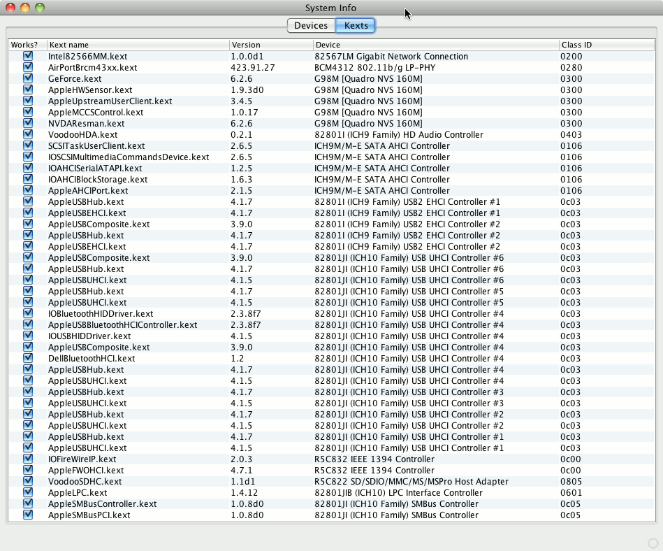

hi, found really cool software System Info app, this can be used to check what kexts version we have installed in Snow Leopard. Below you can find some screen shots of kexts used in my hackintosh E6400:

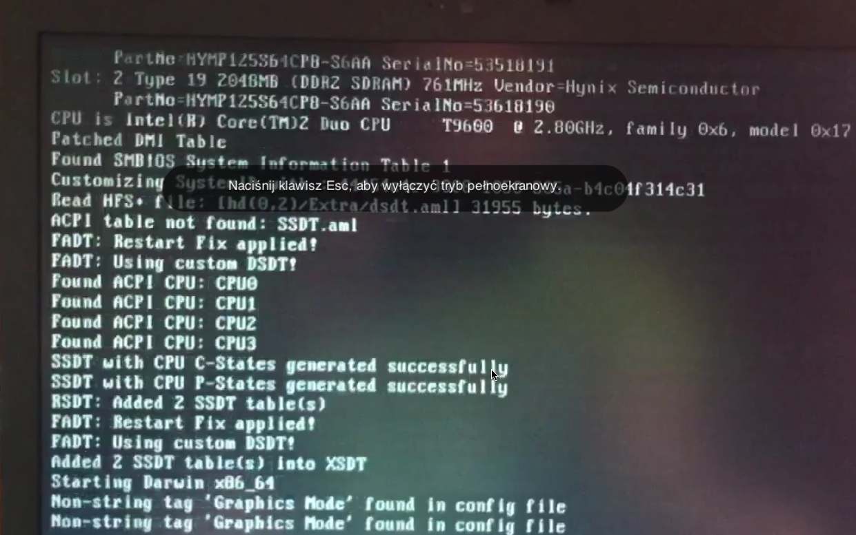

Hi there, got my system refreshed.
Now i used clean retail DVD Snow Leopard and to install used Xbooter 1.3 and then Chameleon 2.0 RC5 v747.
Have here new edited SMBOOT.plist and com.apple.Boot.plist for MacBookPro5,1 with FSB fix for E6400 and dsdt.aml from E6500 with working power management.
System profile :
Dell Latitude E6400 Hackintosh
OSX - Snow Leopard 10.6.7
CPU - Intel C2D T9600 2.80GHz
RAM - 4096MB 800MHz DDR2
GPU - nVidia Quadro NVS 160M 256MB
WiFI - WLAN 1397 802.11 a/b/g/N
LCD - 14.1 WXGA+ LED
Installed system with XBooter CD inside CDRom, then installed update 10.6.7 from file, rebooted with XBooter CD, then installed Chameleon, then installed kexts, dsdt.aml and plist from archive zip (extra/extension and S/L/E).
Rebooted system without CD XBooter, everything works.
System profile :
