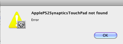

The VoodooPS2PrefPane is written for Synaptics. I just tryed to remake it for ALPS as follows
	io_service = IOServiceGetMatchingService(0, IOServiceMatching("ApplePS2ALPSGlidePoint"));
if (!io_service)
	NSRunCriticalAlertPanel(
							NSLocalizedString( @"ApplePS2ALPSGlidePoint not found", "MsgBox"),
							NSLocalizedString( @"Error", "MsgBoxTitle" ), nil, nil, nil );
		return;
But it uses parameters that the driver is not using. They must be implemented. As well as parameters from Apple's Trackpad.prefPane provided by DarwinX.

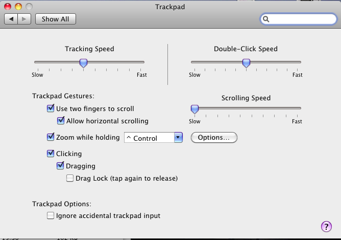

I have Synaptics on that notebook. And the driver gives toooo slow mouse movement. Resolution?
Also can't check here special keys cause there are not here.
Yeah in the Apple trackpad pane set mouse speed to max, then it works real smooth (it's because of the new resolution implementations).

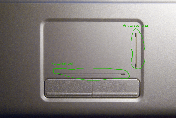

SideScrolling assumes panel size of 950x720. Thus x>900 = VScroll, y>600 = HScroll. It will be better to use VoodooPS2.prefPane settings that the driver understand, for example TopEgde, RightEdge.

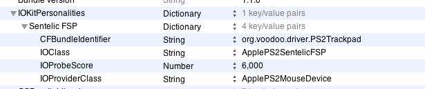

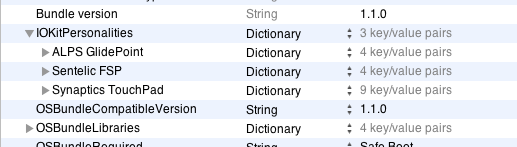

And I can get my trackpad incomplete working(no scrolling) by delete trees of ALPS GLIDPOINT or both of ALPS GLIDPOINT and SYNAPTIC TOUCHPAD. As shown below.
Not working using this setting.
Working with this.

Side scroll speed is controlled by this panel
Dragging is not implemented.
