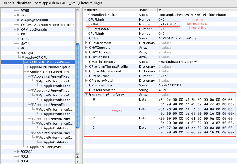

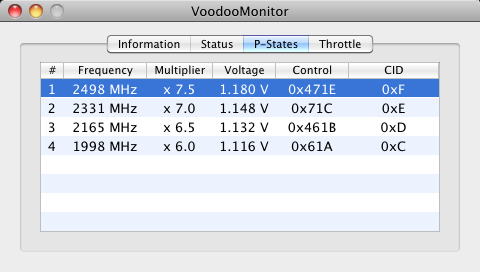

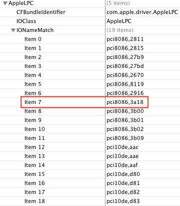

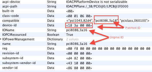

Gringo Vermelho Posted December 27, 2010 Share Posted December 27, 2010 Looking good. If you're satisfied that everything is working fine then there's no need to add your SSDT tables. You can check how many P-states you've got with IORegistryExplorer, they're shown somewhere in the CPU branches. AppleHDA and fakesmc errors are not important (the fakesmc error should go away if you use the latest version), but the "USB controller will be unloaded across sleep" can be taken care of. Some suggestions below. There is a DSDT fix for the Firewire power conservation message as well. my LPC device is exactly the same as in the guide: 3a16. Hehe, yes, according to LSPCI it is, but if you used my code example you have now patched it to 3a18. Confirm this with IORegistryExplorer. Anyway if AppleLPC.kext is loading now, then you did it right. 3a18 is the device ID for the LPC device on the Intel ICH10, which is supported by AppleLPC.kext (check info.plist inside the kext to see the IDs of all supported devices). My board has ICH10R, where the LPC device has device ID 3a16, which is unsupported by AppleLPC.kext - there are no Macs with ICH10R. I don't know how important this is or if it's important at all but I picked that device ID because it's the closest to my real device ID. This is why I asked you for your LPC device's device ID. But since your mobo has the ICH10R as well, then you should be fine using my code example as it is. It's odd you're getting that USB error, I don't have that error message in the logs and since USB is part of the ICH10R as well, your USB controller is the same as mine and there should be no difference. Maybe it's a BIOS setting. Check that USB 2.0 is enabled and that it's set to run at max speed (480 mb/sec). Set "Legacy USB" to auto and enable USB handoff if your BIOS has that setting. If nothing changes after changing settings in the BIOS (it should, though) try adding USBBusFix=y to your /Extra/com.apple.Boot.plist. You made the mistake of extending credibility to the OP's diagnosis. At no point in this thread did I do such a thing. All I did was provide information on how to find what he was looking for. He would still need this information regardless of where the video card is plugged in. When doubt was raised, I told him to re-check the location of his video card and make sure that it is plugged into a x16 slot. I agree with everything you've said, except your video card/Core i7 analogy. As far as I know, broken pins on a CPU would cause malfunction and loss of functionality while using a non x16 slot with a video card would merely cause it to "run slower" but otherwise fully work. Link to comment Share on other sites More sharing options...

efp Posted December 27, 2010 Author Share Posted December 27, 2010 Looking good. If you're satisfied that everything is working fine then there's no need to add your SSDT tables. You can check how many P-states you've got with IORegistryExplorer, they're shown somewhere in the CPU branches. AppleHDA and fakesmc errors are not important (the fakesmc error should go away if you use the latest version), but the "USB controller will be unloaded across sleep" can be taken care of. Some suggestions below. There is a DSDT fix for the Firewire power conservation message as well. Hehe, yes, according to LSPCI it is, but if you used my code example you have now patched it to 3a18. Confirm this with IORegistryExplorer. Anyway if AppleLPC.kext is loading now, then you did it right. 3a18 is the device ID for the LPC device on the Intel ICH10, which is supported by AppleLPC.kext (check info.plist inside the kext to see the IDs of all supported devices). My board has ICH10R, where the LPC device has device ID 3a16, which is unsupported by AppleLPC.kext - there are no Macs with ICH10R. I don't know how important this is or if it's important at all but I picked that device ID because it's the closest to my real device ID. This is why I asked you for your LPC device's device ID. But since your mobo has the ICH10R as well, then you should be fine using my code example as it is. It's odd you're getting that USB error, I don't have that error message in the logs and since USB is part of the ICH10R as well, your USB controller is the same as mine and there should be no difference. Maybe it's a BIOS setting. Check that USB 2.0 is enabled and that it's set to run at max speed (480 mb/sec). Set "Legacy USB" to auto and enable USB handoff if your BIOS has that setting. If nothing changes after changing settings in the BIOS (it should, though) try adding USBBusFix=y to your /Extra/com.apple.Boot.plist. At no point in this thread did I do such a thing. All I did was provide information on how to find what he was looking for. He would still need this information regardless of where the video card is plugged in. When doubt was raised, I told him to re-check the location of his video card and make sure that it is plugged into a x16 slot. I agree with everything you've said, except your video card/Core i7 analogy. As far as I know, broken pins on a CPU would cause malfunction and loss of functionality while using a non x16 slot with a video card would merely cause it to "run slower" but otherwise fully work. I cant manage to find the Pstates in IORegistryExplorer but in VooDooMonitor it shows: however looking at Status tab: My temps seem high! last time i checked it was around 40. Should i be worried? I changed the fakesmc.kext to 2.5, which i believe is the latest one. Now it gives me a slightly different error FakeSMC: key info not found MSDS, length - 6 In regards to the USB controller, i looked in the BIOS. I've got USB 2.0 but no option for running at different speeds. I also dont have USB Handoff. I have a Legacy USB StorageDetect which i enabled but didnt make any difference. I also tried by adding the entry to boot.plist but again, it hasn't made any difference. I dont really put the computer to sleep so i gues its fine as it is.\ Regarding AppleLPC kext and the DSDT, i changed them to 3a16. So i think its fine. AppleLPC is running. And FireWire is fine. I dont use it. If ever i need it, im sure ill figure out how to patch it. Link to comment Share on other sites More sharing options...

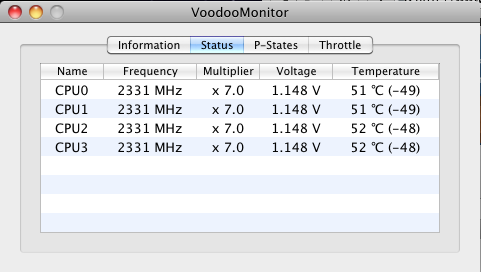

Gringo Vermelho Posted December 27, 2010 Share Posted December 27, 2010 Regarding AppleLPC kext and the DSDT, i changed them to 3a16. wtf, no dude, I told you in post #27, you have changed it to 3a18. 3a16 is the original ICH10R LPC device ID, which doesn't work. You can clearly see in the plist from AppleLPC.kext that only 3a18 is supported, which is why it loads for you now. Location of CPU power states in ioreg: The latest version of Fakesmc is 3.0, which can be found at the ProjectOSX forums. It works from /Extra/Extensions now. Your CPU temps do seem a bit high. My 2 cores (Core 2 Duo E8500 3.16GHz) are usually around 37 degrees celcius when idle. At full load they'll barely go above 50 degrees. Try this: Make sure you have ACPI 2.0, ACPI APIC and all "advanced CPU features" (except CPU ID Limit) enabled in the BIOS. Use Everest under Windows to extract your SSDT tables, as shown in the screenshots here: http://www.insanelymac.com/forum/index.php...p;#entry1468558 name the SSDT tables as described here: http://www.insanelymac.com/forum/index.php?showtopic=225766 Place the SSDT tables in /Extra and add DropSSDT=y to your com.apple.Boot.plist. Reboot and check temps. Link to comment Share on other sites More sharing options...
efp Posted December 31, 2010 Author Share Posted December 31, 2010 wtf, no dude, I told you in post #27, you have changed it to 3a18. 3a16 is the original ICH10R LPC device ID, which doesn't work.You can clearly see in the plist from AppleLPC.kext that only 3a18 is supported, which is why it loads for you now. Location of CPU power states in ioreg: The latest version of Fakesmc is 3.0, which can be found at the ProjectOSX forums. It works from /Extra/Extensions now. Your CPU temps do seem a bit high. My 2 cores (Core 2 Duo E8500 3.16GHz) are usually around 37 degrees celcius when idle. At full load they'll barely go above 50 degrees. Try this: Make sure you have ACPI 2.0, ACPI APIC and all "advanced CPU features" (except CPU ID Limit) enabled in the BIOS. Use Everest under Windows to extract your SSDT tables, as shown in the screenshots here: http://www.insanelymac.com/forum/index.php...p;#entry1468558 name the SSDT tables as described here: http://www.insanelymac.com/forum/index.php?showtopic=225766 Place the SSDT tables in /Extra and add DropSSDT=y to your com.apple.Boot.plist. Reboot and check temps. Sorry i was in another world. Been doing loads of university work, i've just been real tired. What got me confused was reading another thread which DID show changing the LPC to 3a16. But i donno maybe i missread that too... I did extract the ACPI tables and added DropDDST. Perhaps it did help. My temps at idle are at around 39-40. But installing LittleSnitch has raised by 1 or 2. The funny thing i dont understand is in my BIOS it shows CPU temp around 28-29C. I enabled a CPU fan warning if the temps go above 60 so i think i should be alright. I think thats it. Thank you very much for all the help! I learned alot! (at least in my book) Happy New Year!!!! Link to comment Share on other sites More sharing options...
