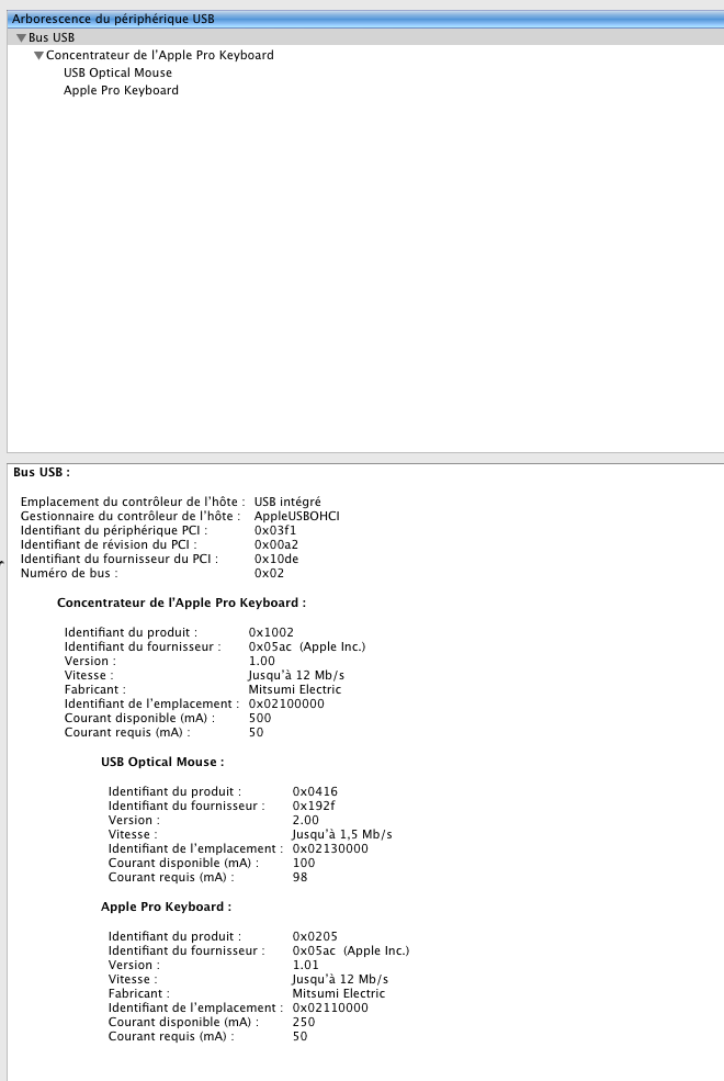

Thanks Verdant. Yes the nforce lan kext has worked after a kext utility pass. I'm now writing you with safari under my leopard :) (Sorry again for my english I'm french).
I include a printscreen of my ystem profiler under usb :) Thank you :)
Attached File  Image_1.png   73.26KB   17 downloads
You are only showing USB 1.1 in System Profiler under USB.......so try booting with the flag
EHCIacquire=Yes Enables the EHCI fix (disabled by default)
as you should see:
USB High-Speed Bus:
Host Controller Location: Built-in USB
Host Controller Driver: AppleUSBEHCI
USB Bus:
Host Controller Driver: AppleUSBOHCI
