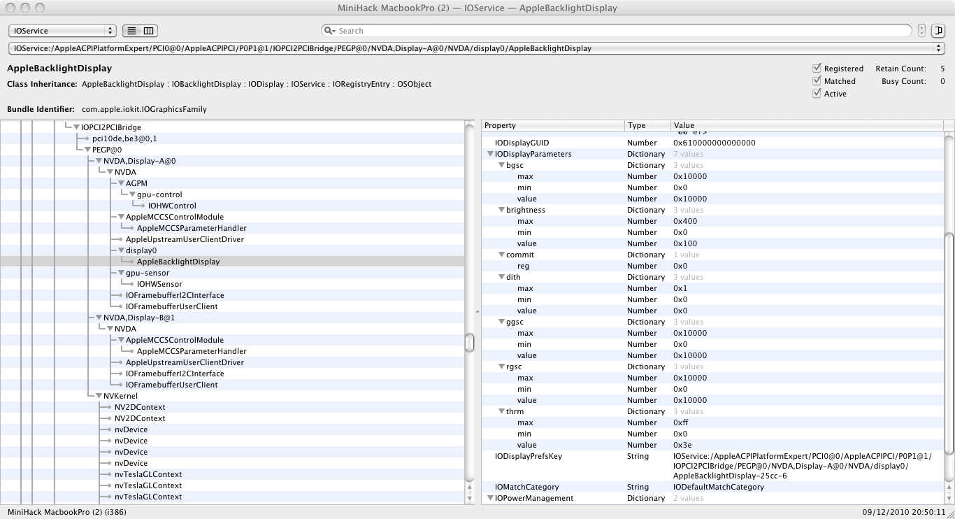

What is your grpahics from ioreg? POP, GFX0 or?
Hello, thank you very much for taking a look at this.
The thing is that i am not sure.
ioreg |grep -i p0p
returns:
| | +-o P0P2@3 <class IOPCIDevice, id 0x10000018f, registered, matched, active, busy 0 (7040 ms), retain 11>
| | +-o P0P1@1E <class IOPCIDevice, id 0x10000019b, registered, matched, active, busy 0 (72 ms), retain 9>
but grepping for -i gf
returns nothing.
If i use ioregexplorer, i do see though P0P2 but also, P0P3 (with also pegp, VGA, CRT, HDMI and LCD), and i also see: GFX0
with a bunch of DD01, DD02 etc which seem to reference PCI0, GFX0, so i am confused.
does it make sense to you?
:D

find display0 and then go up and you'll see what is your graphics.
I looked your dsdt, and found a lot of graphics, so i don't know which metjods shoul i copy.

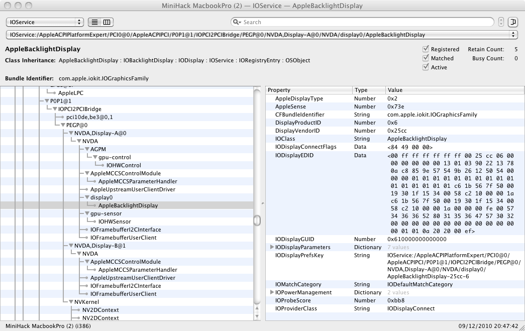

Yes native brightness now with the gfx string injection plus basic pnlf device......
fn+scr lk = brightness down (with sun menu), fn + pause = brightness up.
Interesting is that this is same string as Scorpy22, but EDID is not the same.
