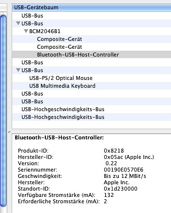

Andy Vandijck
Andy Vandijck
    InsanelyMac Legend
  • Coders
  • 1,104 posts
  • Gender:Male
  • Location:Tienen
  • Interests:Programming stuff for Mac OS X...
    Hacking...
    Hard rock (also really big Metallica...
This legacy kext enables use of the optimized Broadcom bluetooth drivers instead of the standard generic one.
You need to put your USB Bluetooth Vendor + Device ID inside the plist (3x)
After this you just install it under /S/L/E.
The stock version has vendor + device id inside it for an Acer Aspire One D250.
Enjoy much more stable bluetooth experience.

Would this work also with extermal USB-Bluetooth Sticks with Broadcom Chipsets ?
I have one and it uses some Apple driver (i must not install any driver).
Or is that version special for onboard bluetooth chipsets ?
Which device ID is needed to compare with my boardcom BT USB Stick ?
I dont know my excat Broadcom BT BCMXXXX type , but could look in the Systemprofiler after the dev id there.
EDIT: I looked in the new .kext and see there an NotRemovable = Yes key.
So not usable with removable USB BT Sticks ?
Last but not least: There is no code in driver, "only" an .plist, so changes made by injecting some keys?
Would be nice to get some more "How to edit .plist " informations. Exspecially which Dev ID / Prod ID keys must be put where.
Here my INFO with Apple Drivers - can i use your kext and if yes what dev/id numbers must i edit ?
BLUETOOTH USB +EDR ADAPTER v2.1 UHE:
Produkt-ID: 0x016a
Hersteller-ID: 0x050d (Belkin Corporation)
Version: 3.88
Seriennummer: 00190E0570E6
Geschwindigkeit: Bis zu 12 MBit/s
Hersteller: Broadcom Corp
Standort-ID: 0x1d230000
Verfügbare Stromstärke (mA): 132
Erforderliche Stromstärke (mA): 2
Apple Bluetooth-Softwareversion: 2.3.3f8
Hardware-Einstellungen:
Adresse: 00-19-0e-05-70-e6
Firmware-Version: 14 (20868)
Bluetooth-Signal: Ein
Sichtbar: Ja
Hersteller-ID: 0
Produkt-ID: 0x1
HCI-Version: 4 (0x4)
HCI-Revision: 20868 (0x5184)
LMP-Version: 4 (0x4)
LMP-Unterversion: 16910 (0x420e)
Gerätetyp (Obergruppe): Computer
Gerätetyp (komplett): Macintosh-Desktop
Composite-Klasse des Geräts: 3670276 (0x380104)
Geräteklasse (Obergruppe): 1 (0x1)
Geräteklasse (Untergruppe): 1 (0x1)
Dienstklasse: 448 (0x1c0)
Identifizierung erforderlich: Nein

How to know if my
Produkt-ID: 0x016a
Version: 3.88
is such an BCM Type ?

In case of this card it seems to be descripted as a BCM2046B1 ic (which should work).
In this case (I looked up some info) it seems to be actually configured as a bluetooth hub with multiple connections to it.
It should thus work if you change the 3 vendorIds and productIds to:
vendorId: 1293
productId: 362
These are just the values you see above converted to decimal.
Try it and let me know if it works.

Seems to work (i used the IDs you told first)!
I think the information in the USB systemprofiler changed also a bit about the USB device.
Main change: The Bluetooth Menue now has the function available (before grey) to enable/disable BT.
I dont know it it will real enable/disable the USB device.
EDIT: I tried to use the activate/deactivate BT Menue function to enable/disable the Belkin USB BT stick.
WORKS ! If i disable the blue light on the stick goes off, if i enable again (by menue not unplug/plug) the blue light goes on again.
Before ANV i had to unplug the BT stick if i want to disable BT.
Nice :)

Belkin Mini BT USB Stick
Produkt-ID: 0x016a
Version: 3.88
used in ANV:
vendorId: 1293
productId: 362

So, I added my values to the kext and now under System Profiler my USB dongle shows as:
Bluetooth USB Host Controller:
Product ID: 0x8218
Vendor ID: 0x05ac (Apple Inc.)
Version: 0.22
Speed: Up to 12 Mb/sec
Manufacturer: Apple Inc.
Location ID: 0x1d200000
Current Available (mA): 500
Current Required (mA): 94
However, I can still not wake the computer from sleep using my bluetooth mouse, which a real Mac would be able to do. So, am I doing something wrong or does this kext not fix that?
Edit:
It is working now. I can wake from sleep. I was using the hub pid and vid, switched to the IDs on the device on the bluetooth hub instead.
Thanks!!
