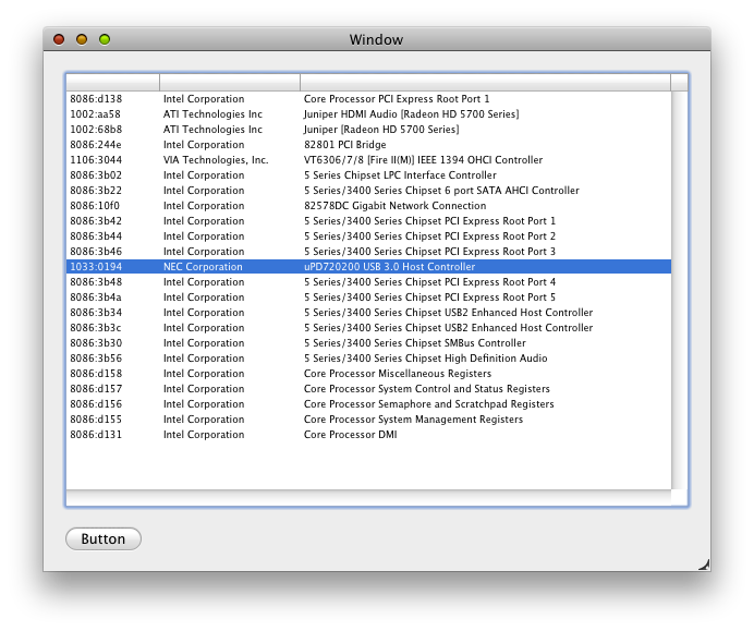

I have just downloaded LaCie drivers for OS X and they appear to have loaded ok. See screen grab
Shame I dont have  usb 3.0 drive to test it out.

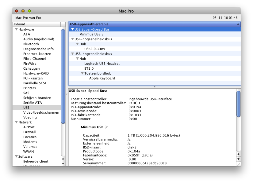

Hello All,
I am moving to this discussion since it has a more accurate topic.
Here is my original post. I will then post my follow-up after for continuity.
I have installed them on two systems with built-in NEC based USB3 ports:
1) GA-X58A-UD5
2) GA-H55M-USB3
On both systems i get the new Super-speed entry in System Profiler.
However, on system 1 i can't get any drives (USB2 or USB3) to mount on the USB3 ports.
On system 2, USB2/3 drives will mount but... in System Profiler when the USB2/3 drives are plugged in to the USB3 ports they show up under the high-speed USB entry, not under the Super-speed one.
System Profiler for system 1 does not show any of the devices i plug in to the USB3 ports.
I am suspecting the DSDT is a culprit here but i looked through them and couldn't find an obvious place to start tweaking. I will post the DSDT for both systems soon, and would love to help get this driver working ASAP.

System 3 is behaving in the following way:
USB2 drives plugged in to the USB3 ports mount. They show up in system profiler UNDER THE SUPER-SPEED entry. This seems good!
However when i plug my USB3 dock in to the USB3 ports the drive does NOT mount and nothing shows up under System Profiler. Neither in Super-Speed nor High-Speed, etc.
