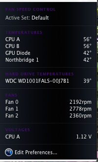

blackosx Posted October 18, 2010 Share Posted October 18, 2010 Making the edits to NVClockX.kext as suggested above by THe KiNG and oldnapalm allows it to run from /E/E.. Thanks guys But when running NVClockX from /E/E and idling in the Finder, although the GPU diode and GPU Heatsink readings look normal, I have noticed inconsistent GPU FAN readings of sometimes -4092rpm or 5380rpm? Comparing this to using the previous FakeSMCnVclockPort.kext in FakeSMC from projectOSX loading in to /S/L/E where I would see consistent readings of 1219rpm - 1229rpm Could this be due to the removing of the dependency to com.apple.NVDAResman? I've also seen the following NVClockX warning in the kernel.log: Oct 18 06:43:14 localhost kernel[0]: sp78, size 2 Oct 18 06:43:14 localhost kernel[0]: FakeSMC: Adding key F0Ac with handler, type fpe2, size 2 Oct 18 06:43:14 localhost kernel[0]: FakeSMC: Adding key F1Ac with handler, type fpe2, size 2 Oct 18 06:43:14 localhost kernel[0]: FakeSMC: Adding key F2Ac with handler, type fpe2, size 2 Oct 18 06:43:14 localhost kernel[0]: NVClockX: [Warning] error updating FNum value Oct 18 06:43:14 localhost kernel[0]: mbinit: done (64 MB memory set for mbuf pool) Oct 18 06:43:14 localhost kernel[0]: From path: "uuid", …./snip/.… Link to comment Share on other sites More sharing options...

blackosx Posted October 18, 2010 Share Posted October 18, 2010 I believe that Mozodojo has resolved this issue in his latest commit as of 10.16 Thanks DarwinX - that indeed has removed the warning in the kernel.log However, I still see inconsistent GPU FAN readings in istat menus 3 from -508rpm to 2308rpm? Link to comment Share on other sites More sharing options...
The Real Deal Posted October 18, 2010 Share Posted October 18, 2010 Those edits would be in the NVClockX.kext of course for those of us following along at home, thanks works great although don't know where the voltage for the CPU comes from as it does not seem to correspond to anything Voodoo Monitor shows... I have just removed the dependency and it seems to work fine: Oct 18 09:10:08 localhost kernel[0]: NVClockX: started Oct 18 09:10:08 localhost kernel[0]: NVClockX: Vendor ID: 10de, Device ID: 6e4 Oct 18 09:10:08 localhost kernel[0]: NVClockX: Architecture: 80000 Oct 18 09:10:08 localhost kernel[0]: NVClockX: G98 [GeForce 8400 GS] Oct 18 09:10:08 localhost kernel[0]: FireWire runtime power conservation disabled. (2) Oct 18 09:10:08 localhost kernel[0]: FireWire (OHCI) TI ID 8024 PCI now active, GUID 00caf7380000241d; max speed s400. Oct 18 09:10:08 localhost kernel[0]: BIOS successfully read What is the purpose of the second edit? Link to comment Share on other sites More sharing options...

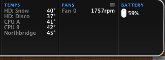

MacKonsti Posted October 19, 2010 Share Posted October 19, 2010 Dear mozodojo, I also have a question. Everybody seems to be getting a thermal reading for a Northbridge chip; I am sure that I should also get one, since I am running on a ICH7 (G31) chipset! I know that Core i7 chipsets don't include Northbridge anymore, instead. Can you imagine why I don't have such a reading? I don't get any errors in kernel log. Slice/rubik's plugin produced such a reading... Thank you. Link to comment Share on other sites More sharing options...
kozlek Posted October 19, 2010 Author Share Posted October 19, 2010 Dear mozodojo, I also have a question. Everybody seems to be getting a thermal reading for a Northbridge chip; I am sure that I should also get one, since I am running on a ICH7 (G31) chipset! I know that Core i7 chipsets don't include Northbridge anymore, instead. Can you imagine why I don't have such a reading? I don't get any errors in kernel log. Slice/rubik's plugin produced such a reading... Thank you. I have no idea before you'll show me your smc keys dump. Use atMonitor to do that. Link to comment Share on other sites More sharing options...
