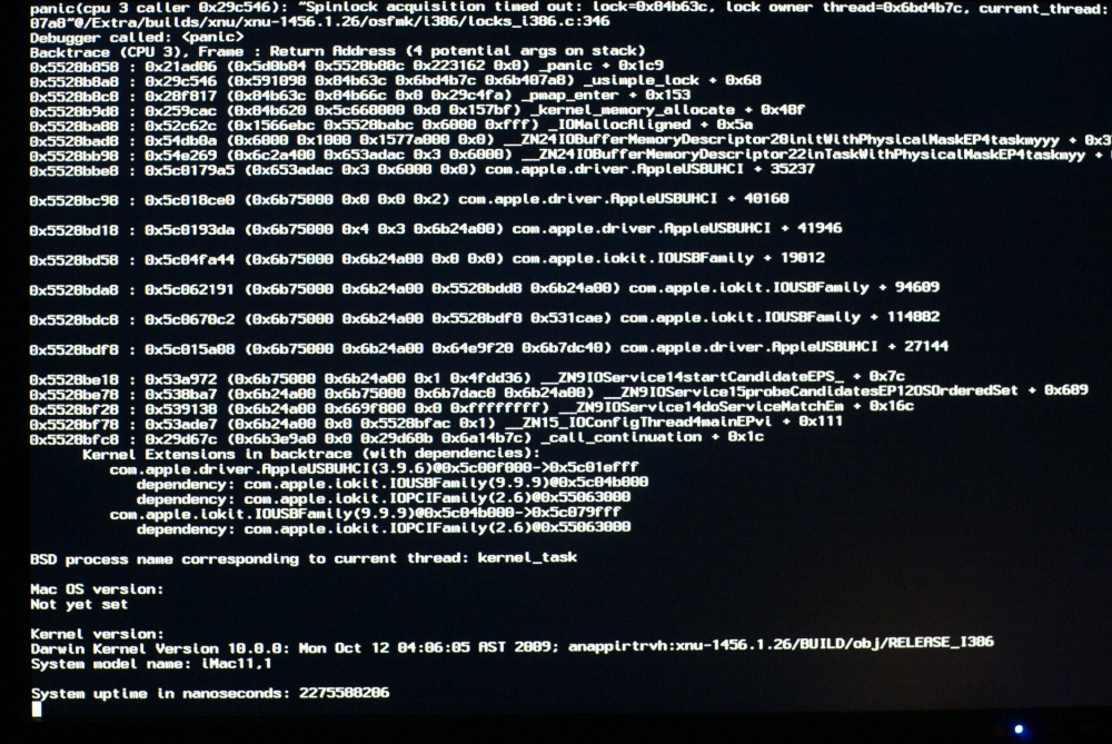

seltsam23 Posted October 10, 2010 Share Posted October 10, 2010 Hi there. I've found this thread: GA-P35C-DS3R - 100% Vanilla Snow Leopard Install, Everything Works ~ 32bit or 64bit ~ 10.6 In the BootMenue I insered SL 10.6.3 to install. The Apple-Waiting-Screen appears, and after a while this failure occurs: My Hardware: Gigabyte GA-P35C-DS3R ATI Saphire 4850 512MB Only SATA-Drives Should I use an other BootCD? Would you give me a small guide please? Quote Link to comment Share on other sites More sharing options...

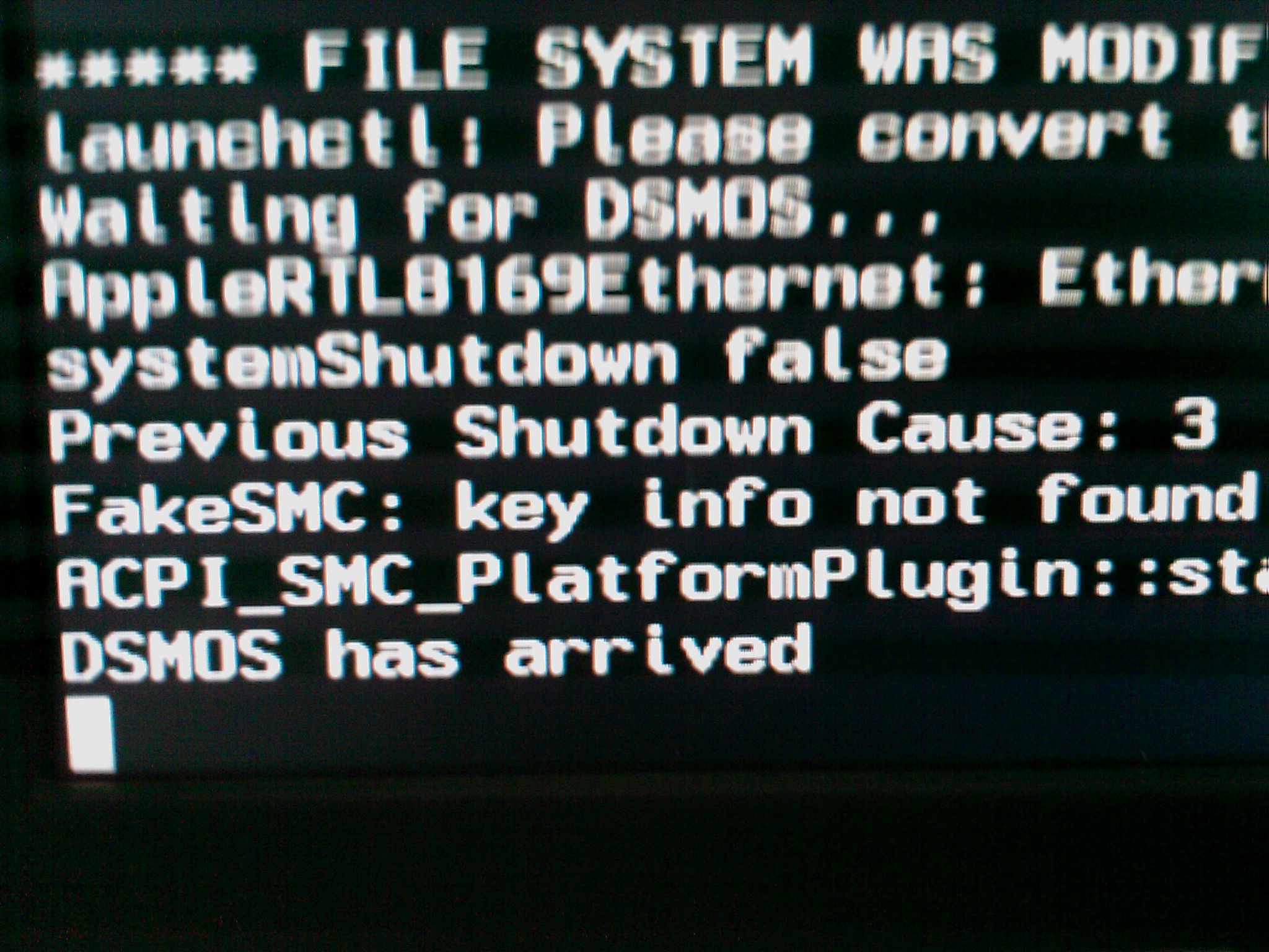

seltsam23 Posted October 12, 2010 Author Share Posted October 12, 2010 Hi again! I changed something in the Bios, I think now I get the "right" failure-message. When Im booting without savemode I get a kernel panic. When booting with savemode he stopps at "DSMOS has arrived" It seems that the ati-kext has corrupted the OS, doesnt it? Thank you Quote Link to comment Share on other sites More sharing options...

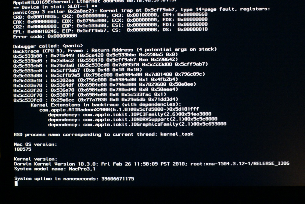

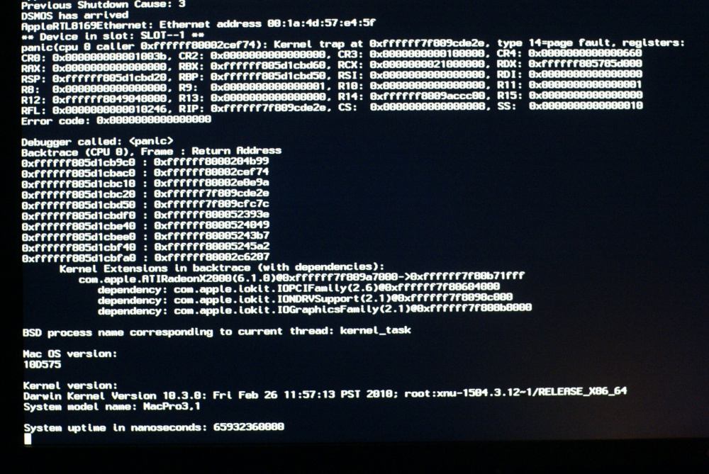

seltsam23 Posted October 12, 2010 Author Share Posted October 12, 2010 Ok, fresh installation again. I try to run in normal mode now, not only savemode. Now Ive tried 3 different BootCDs With every bootCD I get another Kernel Panic. Look at these pics: Intel Gigabyte BootCD: Another, P45 BootCD: [url="http://www.insanelymac.com/forum/topic/279450-why-insanelymac-does-not-support-tonymacx86/"]#####[/url] 2.0 Ati (!) BootCD: In the first and second picture you can read something of "Ati" seems to be a missing Graphic_Kext, doesnt it? But, with the [url="http://www.insanelymac.com/forum/topic/279450-why-insanelymac-does-not-support-tonymacx86/"]#####[/url] 2.0 Ati version there is nothing mentioned woth "Ati". How can that be? Does the [url="http://www.insanelymac.com/forum/topic/279450-why-insanelymac-does-not-support-tonymacx86/"]#####[/url] 2.0 Ati Boot CD deliver the kext for my Aticard and jumps to the "next" panic? Quote Link to comment Share on other sites More sharing options...
MaLd0n Posted October 12, 2010 Share Posted October 12, 2010 Use Intel Gigabyte BootCD Use -x After Install, upload your DSDT run on terminal perl -e 'open(CMD, "ioreg -lw0 \| grep DSDT|") or die; while(<CMD>) { chomp; if($_ =~ /\"DSDT\.?\d?\"=<([^>]*)>/) { $buff = $1; open(PIP, "|xxd -r -p > dsdt.aml") or die; print PIP "$1"; } }' the DSDT will be generated in user folder send me do not install anything, send me the DSDT and wait I'll send you the extra folder full Ok? Quote Link to comment Share on other sites More sharing options...
