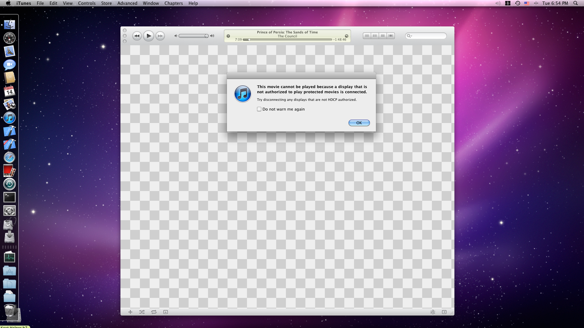

sorandom Posted September 15, 2010 Share Posted September 15, 2010 Thanks man, I guess I didnt read through enough. Thanks for all your hard work it really has made my life very enjoyable. The only problem is buying itunes hd videos I get some HDCP error saying I cannot play this movie for some reason or another here is a pict of the error. I suppose this can not be fixed other than buying a new display. I have a sony bravia 46 Inch, would buying one of those samsung 9000 LED displays fix this. Thats my plan anyway. I hope I can play those hd videos everything is really nice and this card blows away my 260. much respect, unrmn fka sorandom Link to comment Share on other sites More sharing options...

Spanky Deluxe Posted September 16, 2010 Author Share Posted September 16, 2010 Thanks man, I guess I didnt read through enough. Thanks for all your hard work it really has made my life very enjoyable. The only problem is buying itunes hd videos I get some HDCP error saying I cannot play this movie for some reason or another here is a pict of the error. I suppose this can not be fixed other than buying a new display. I have a sony bravia 46 Inch, would buying one of those samsung 9000 LED displays fix this. Thats my plan anyway. I hope I can play those hd videos everything is really nice and this card blows away my 260. much respect, unrmn fka sorandom How are you connecting your screen? HDCP definitely doesn't work over VGA but it should work over DVI. If it's connected via DVI already then it would probably mean that HDCP doesn't work on 5970s. I've never bought HDCP content on iTunes and my screen's an Apple 30" Display which doesn't support HDCP anyway so I can't really test it on my end. I'm not sure if buying a new screen will fix it, if you're already connecting via DVI then it won't. However, a 9000 LED TV + AppleTV/Mac Mini to stream would definitely fix it . Hehe. Hello,I own a normal ATI Radeon HD5970. I have a problem when I follow this instruction, i get a grey background after booting and nothing else. It is a clean installation and it worked before without ATI-kext-files. I have the PC-Efi installed on an external USB-Drive. I boot from that and the extra-folder is in on this USB-Drive. But it doesn't work. I've tried it a second time with a new installation and used the graphic-update and restored the rights in Snow Leopard itself. I can still boot with the option -x in Chameleon, but not in normal mode. In the end I have the same result. Can somebody help, please. I'll try it today with Kabyl's bootloader. What are your fans doing? Try booting up with -v and seeing where it fails. Let me know what you get. Link to comment Share on other sites More sharing options...
