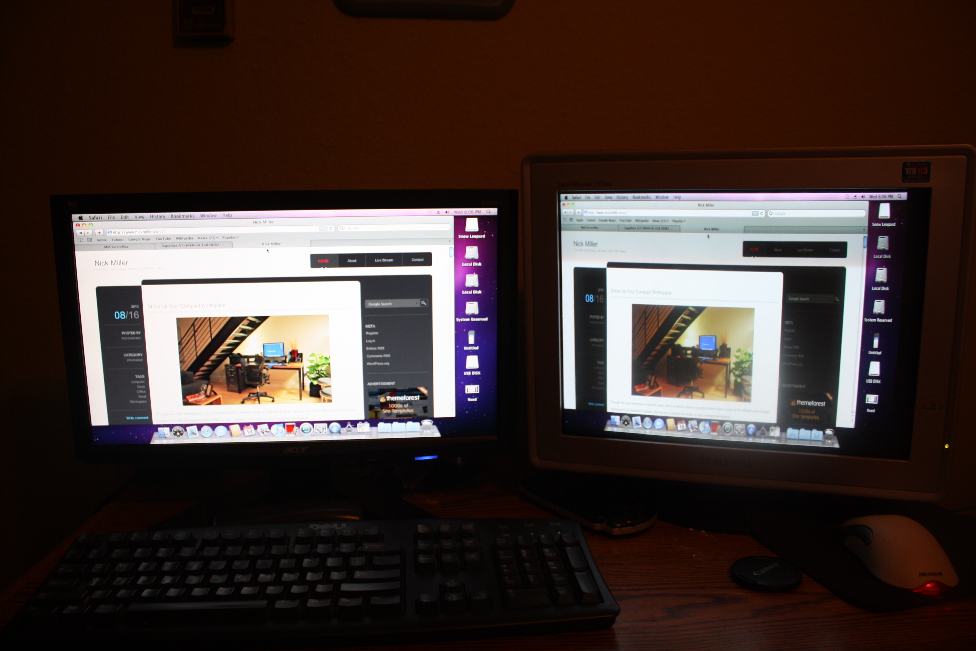

Okay, on my end I made some progress... Now my system preferences says "ATI Radon HD 4600", so that is better :P
I'm still stuck in mirror mode, but I still have hope for a simple fix :/
fixed.tiff
Nick, yes for you that is probably progress. Mine has been saying 4600 for quite some time though. All of the screen shots I have seen from 512 users with dual screen working say 4600 and not 4650 (refer to Giorgio's earlier screen shots in this thread) so let's hope that is where we should be.

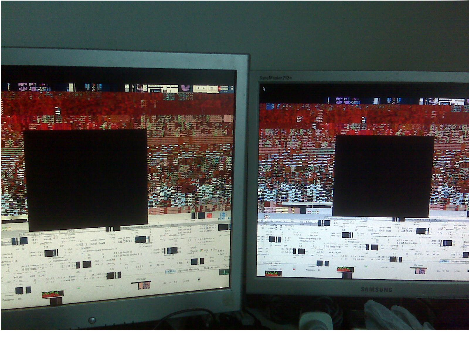

Okay...well still think we may be getting slowly closer to figuring this issue out, but unfortunately it looks like simply upgrading to the 10.6.5 kexts alone will not do it.
I tested the 10.6.5 ATI Kexts (ATI4600Controller, ATIRadeonX2000, ATIFramebuffer, and ATISupport) using several different boot loaders. These were all done using the DVI port with DVI to VGA adapter and the VGA port. Here are the results:
Chameleon RC5: Both displays power off on GUI load.
AsereBLN 1.19: Both displays power on, but display is garbled (see attached example)
Chameleon RC4: Both displays power on, but display is garbled
PC-EFI 10.6: Both displays power off on GUI load.
