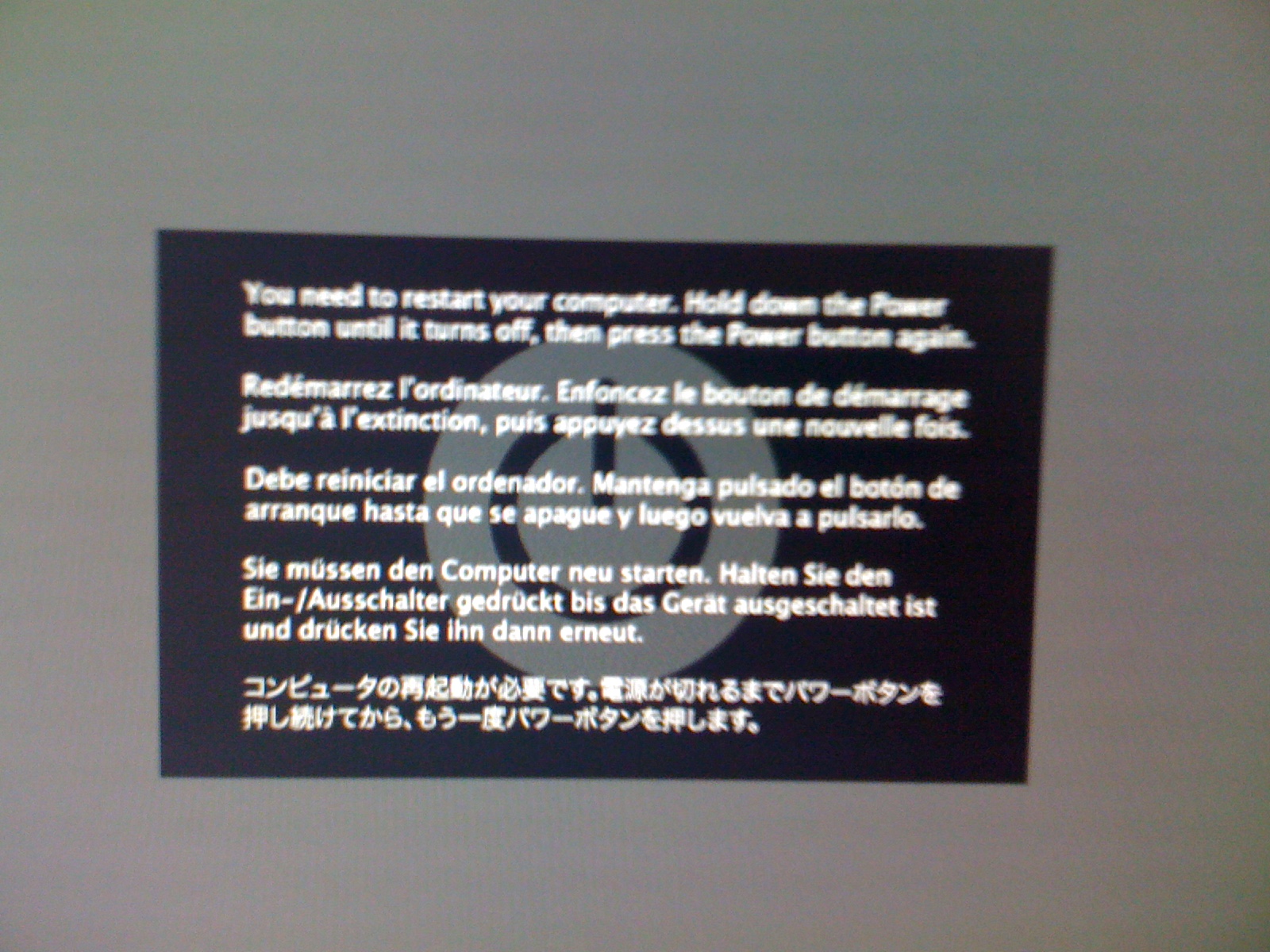

I am working 70 hours a week on top of having 5 children, which doesn't leave me much time to play around. I really need to system to work.
Here are my specs:
Motherboard: ASUS Maximus Gene III
Memory: 6Gb
Video Card (Primary): EVGA GeForce 9800GTX+ 512Mb
Video Card (Secondary): Asus EN9500GT 1Gb
Sata Hard Disk and Sata DVD writer
Currently my system is working with a single video card with NVEnabler 64, I can use any of the two cards, they both work, but they do not work together in the same system.
Everything else is working, sound, lan, etc...
The other issue is that when I shutdown, the system does not really power down. I can provide my current DSDT.
I am willing to make some adjustments to my system if required.
Thanks.

Ok I played with this a bit, and I can run the 8400GS from slot 1 or slot 2, I can run the 9500 GT from both slots as well (changing the config of course), and with ioregexplorer I see them under the proper POP3 or POP5. The problem only occurs when I put both cards in the system at the same time.

Sorry, same result.
I am really grateful for your help.
Here is the system.log for the last boot sequence if it can help:
