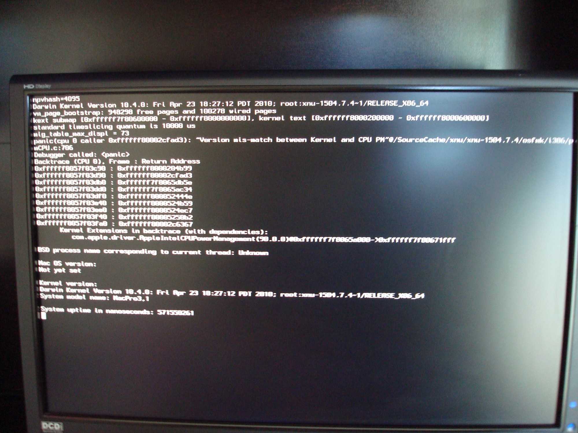

toner_ Posted August 7, 2010 Author Share Posted August 7, 2010 Booted with the boot disc, insert osx dvd, waited a few mins, pressed f5, then enter and got a panic message: "Version mis-match between kernel and CPU PM" Also, I am unplugging all my other hard drives when trying/installing osx to limit things getting messed up, so once it's done, I can choose how I want my boot options. Thanks for your help so far by the way, I appreciate it! Once this is done we can have an official XPS 410 tutorial since I can't find anything on it and they should all be the same hardware except for maybe a processor and video card. Quote Link to comment Share on other sites More sharing options...

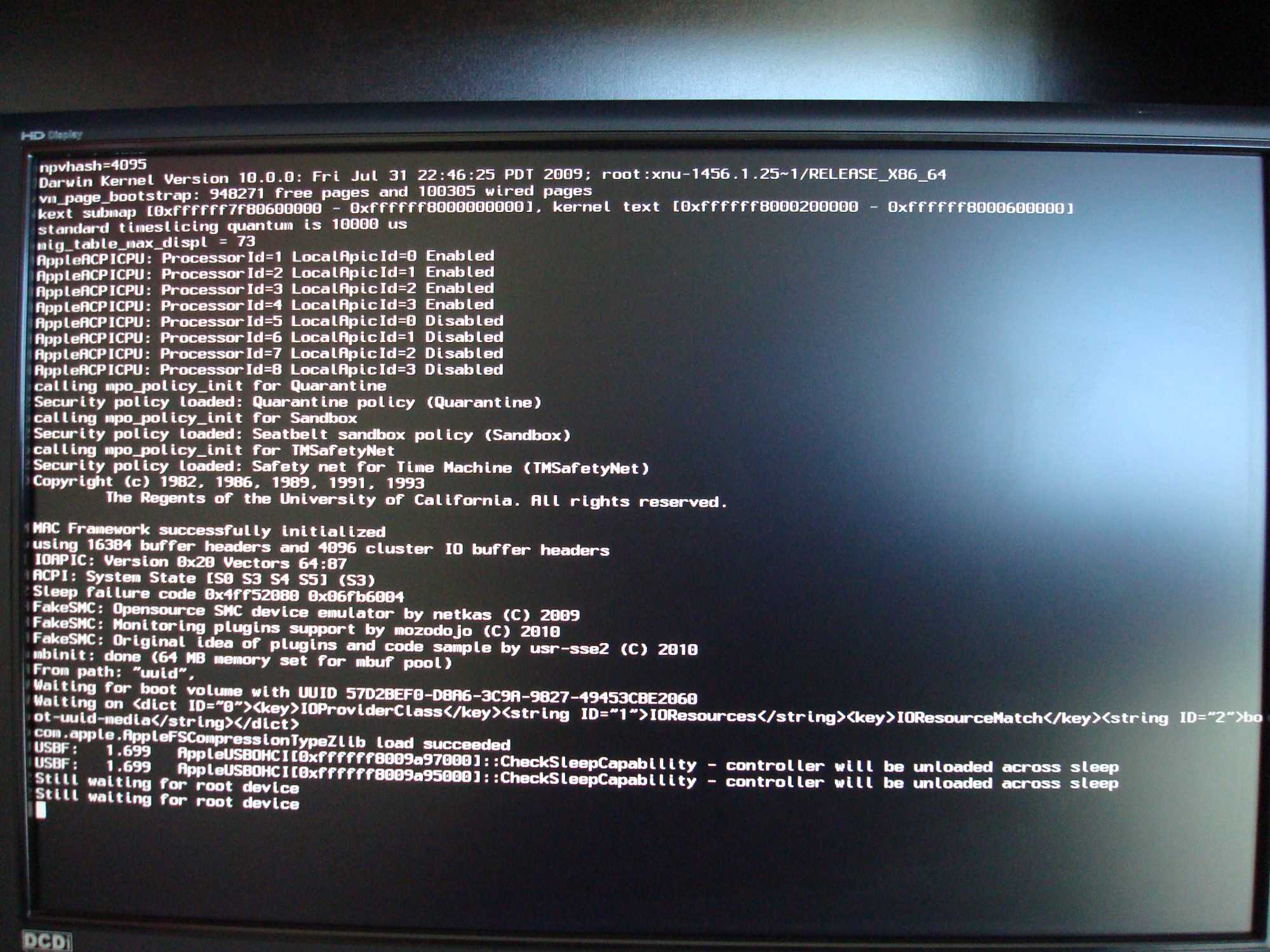

toner_ Posted August 10, 2010 Author Share Posted August 10, 2010 The boot disc does NOT work properly with only a fresh formatted HDD as GUID. When I just left all my hard drives hooked up, I loaded the boot disc, swapped for my osx disc, pressed f5 and BAM it loaded it. I was still getting errors, here is the screenshot of when I booted it in verbose mode. Quote Link to comment Share on other sites More sharing options...

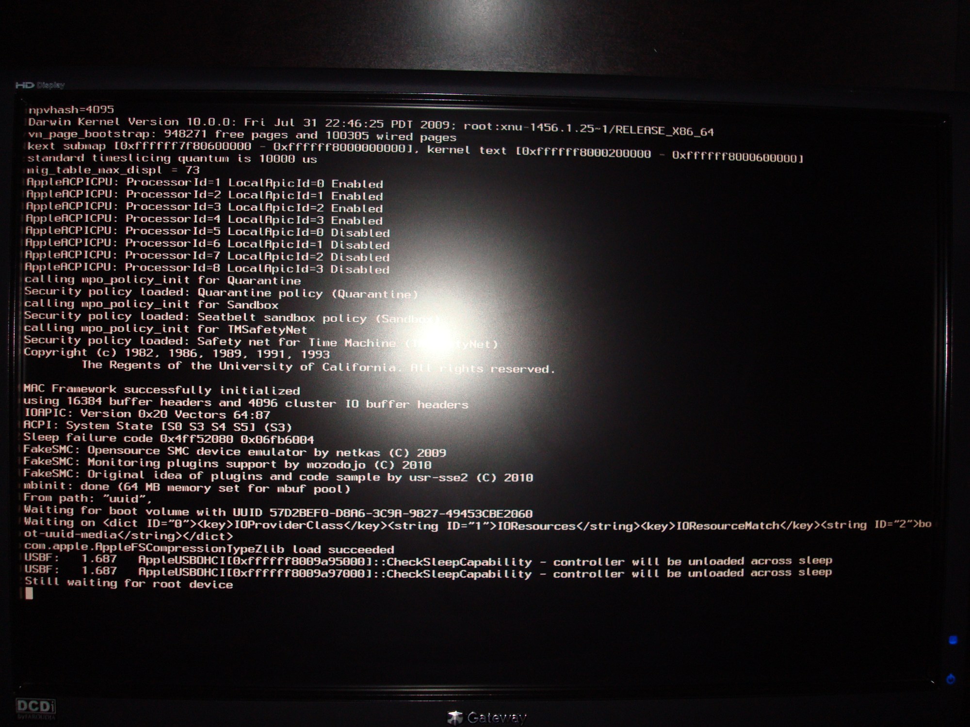

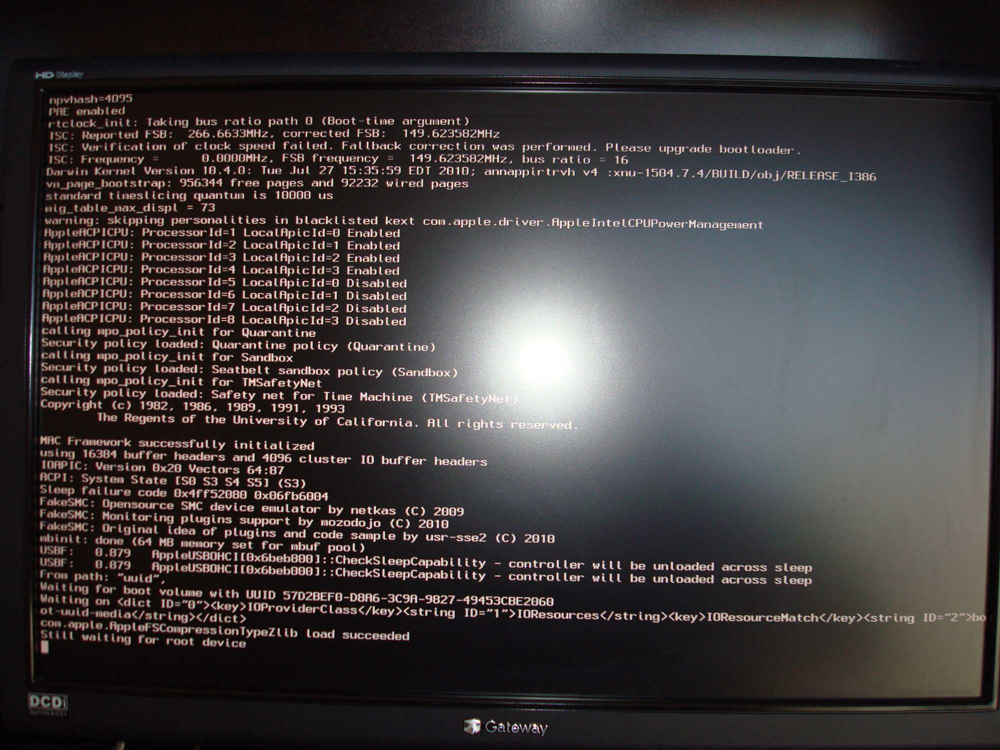

Mohamed Khairy Posted August 10, 2010 Share Posted August 10, 2010 use this boot cd boot with -v if you get loop restart boot with rd(0,0)/extra/legacy_kernel busratio=16 -v Quote Link to comment Share on other sites More sharing options...

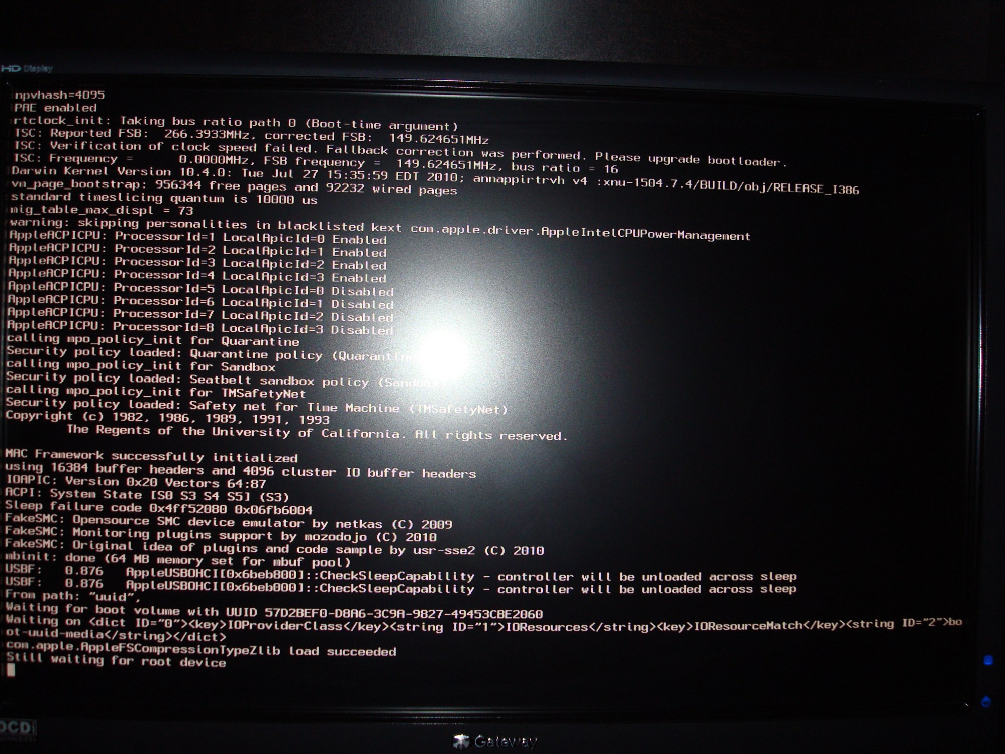

toner_ Posted August 10, 2010 Author Share Posted August 10, 2010 Using the new boot disc you provided: The first pic is when I tried booting the osx dvd with just -v The second pic is when I tried booting with rd(0,0)/extra/legacy_kernel busratio=16 -v Seems like they both get to a certain point and every minute or so the line "waiting for root device" keeps poping up. Quote Link to comment Share on other sites More sharing options...
Mohamed Khairy Posted August 10, 2010 Share Posted August 10, 2010 Using the new boot disc you provided: The first pic is when I tried booting the osx dvd with just -v The second pic is when I tried booting with rd(0,0)/extra/legacy_kernel busratio=16 -v Seems like they both get to a certain point and every minute or so the line "waiting for root device" keeps poping up. trun your sata setting to achi and use -v only during boot Quote Link to comment Share on other sites More sharing options...

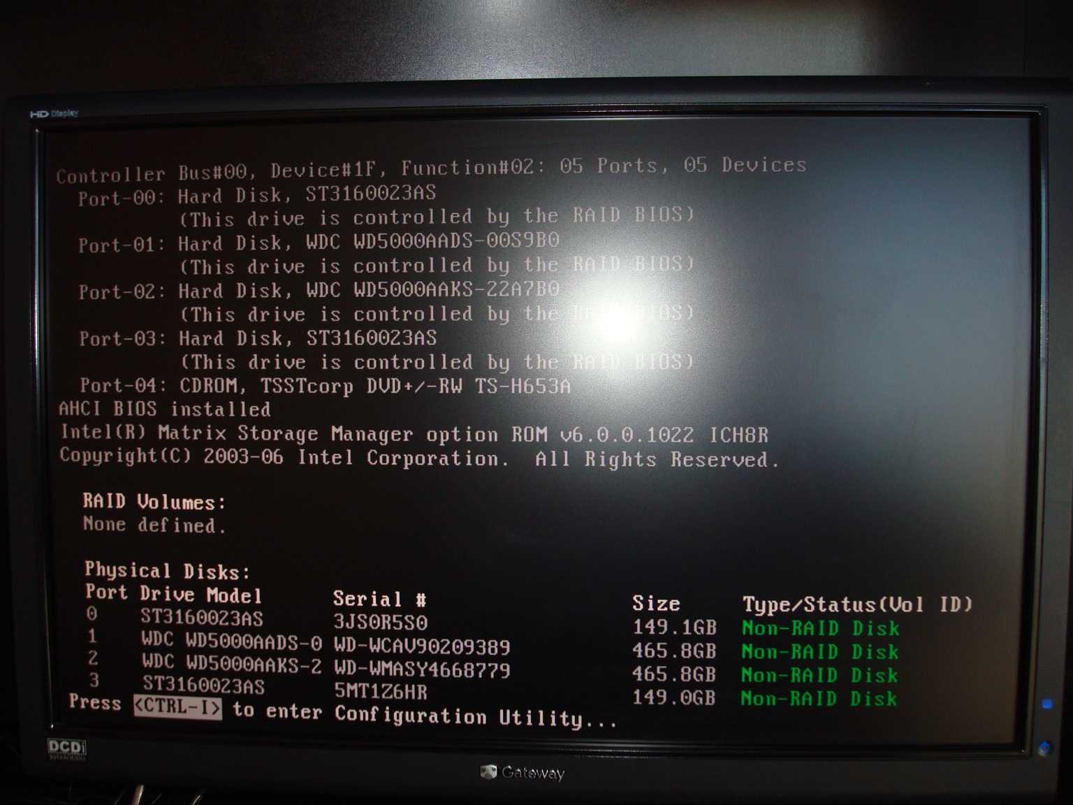

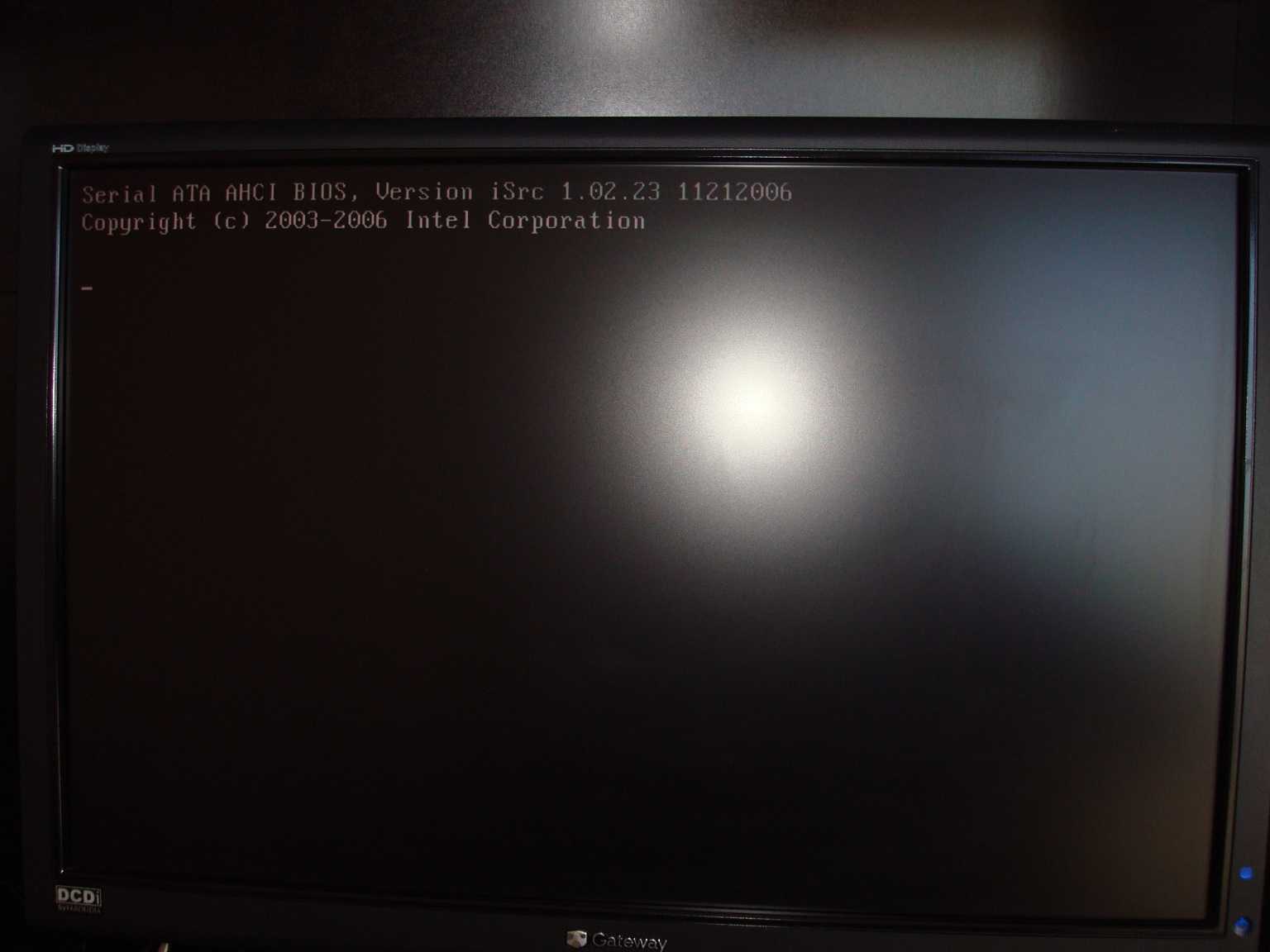

toner_ Posted August 11, 2010 Author Share Posted August 11, 2010 I think it's on by system default/bios. There are no specific settings for it, but when the system is turned on it says ACHI bios etc. And if you enter the "configuration utility press ctrl+i" in the 1st pic, it just loads the windows boot screen where you can select windows 7 or memory diagnostic. Quote Link to comment Share on other sites More sharing options...

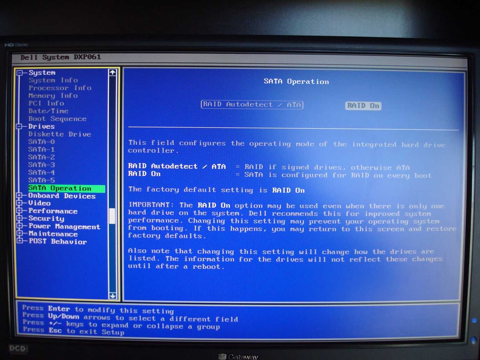

Mohamed Khairy Posted August 11, 2010 Share Posted August 11, 2010 I think it's on by system default/bios. There are no specific settings for it, but when the system is turned on it says ACHI bios etc. And if you enter the "configuration utility press ctrl+i" in the 3rd pic, it just loads the windows boot screen where you can select windows 7 or memory diagnostic. this is raid trun it off there are option that have two options IDE and ACHI Quote Link to comment Share on other sites More sharing options...

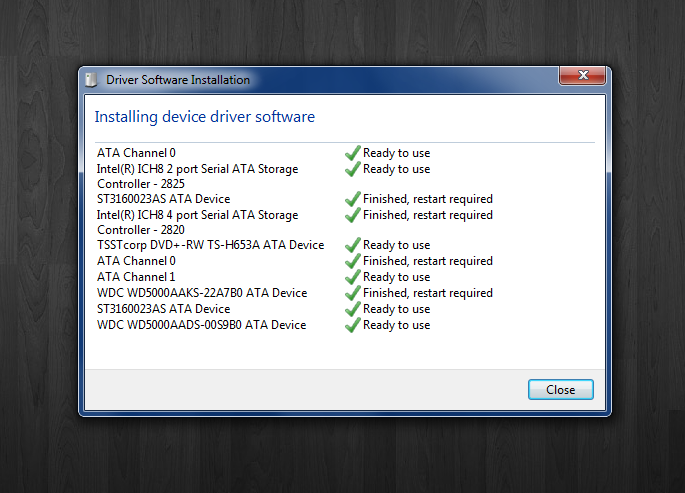

toner_ Posted August 11, 2010 Author Share Posted August 11, 2010 For anyone using an XPS and will be following this thread in the future, please note: The Dell XPS 410 comes default with the raid bios on, changing this to autodetect/ata will cause your current windows installation to not load properly (blue screen) like if you put your hdd in a different computer. There is a workaround to change this WITHOUT having to reinstall windows. This is the article from microsoft. Written for XP, it worked on my Win7 x64 install. It's not as complicated as it looks. First, make sure the Atapi.sys, Intelide.sys, Pciide.sys, and Pciidex.sys files are in the System32\Drivers folder, then make the registry file how the article says. CREATE A RESTORE POINT just in case. I just saved the reg file I made to my desktop, double clicked it, added it to the registry, restarted, opened the bios and changed the raid from on to the "autodetect/ata" setting (the only other setting), saved and restarted. Once my win7 x64 loaded up, it installed new drivers for the hdd controllers (see pic) and everything was working perfectly. ------------------------------------------ Now, back to instructions here. I switched the raid off like you advised, booted in verbose mode -v and took a screenshot, then booted with the rd(0,0)/extra/legacy_kernel busratio=16 -v and took a screenshot. Both screen shots seem to be the same as when I had the raid on and tried both of the above boot options. What do you advise next? To see all my available bios settings/options, here is the link to the documentation on my system. Click the 4th item on the list "system setup options." Quote Link to comment Share on other sites More sharing options...
Mohamed Khairy Posted August 11, 2010 Share Posted August 11, 2010 For anyone using an XPS and will be following this thread in the future, please note: The Dell XPS 410 comes default with the raid bios on, changing this to autodetect/ata will cause your current windows installation to not load properly (blue screen) like if you put your hdd in a different computer. There is a workaround to change this WITHOUT having to reinstall windows. This is the article from microsoft. Written for XP, it worked on my Win7 x64 install. It's not as complicated as it looks. First, make sure the Atapi.sys, Intelide.sys, Pciide.sys, and Pciidex.sys files are in the System32\Drivers folder, then make the registry file how the article says. CREATE A RESTORE POINT just in case. I just saved the reg file I made to my desktop, double clicked it, added it to the registry, restarted, opened the bios and changed the raid from on to the "autodetect/ata" setting (the only other setting), saved and restarted. Once my win7 x64 loaded up, it installed new drivers for the hdd controllers (see pic) and everything was working perfectly. ------------------------------------------ Now, back to instructions here. I switched the raid off like you advised, booted in verbose mode -v and took a screenshot, then booted with the rd(0,0)/extra/legacy_kernel busratio=16 -v and took a screenshot. Both screen shots seem to be the same as when I had the raid on and tried both of the above boot options. What do you advise next? To see all my available bios settings/options, here is the link to the documentation on my system. Click the 4th item on the list "system setup options." you dvd is sata or IDE Quote Link to comment Share on other sites More sharing options...

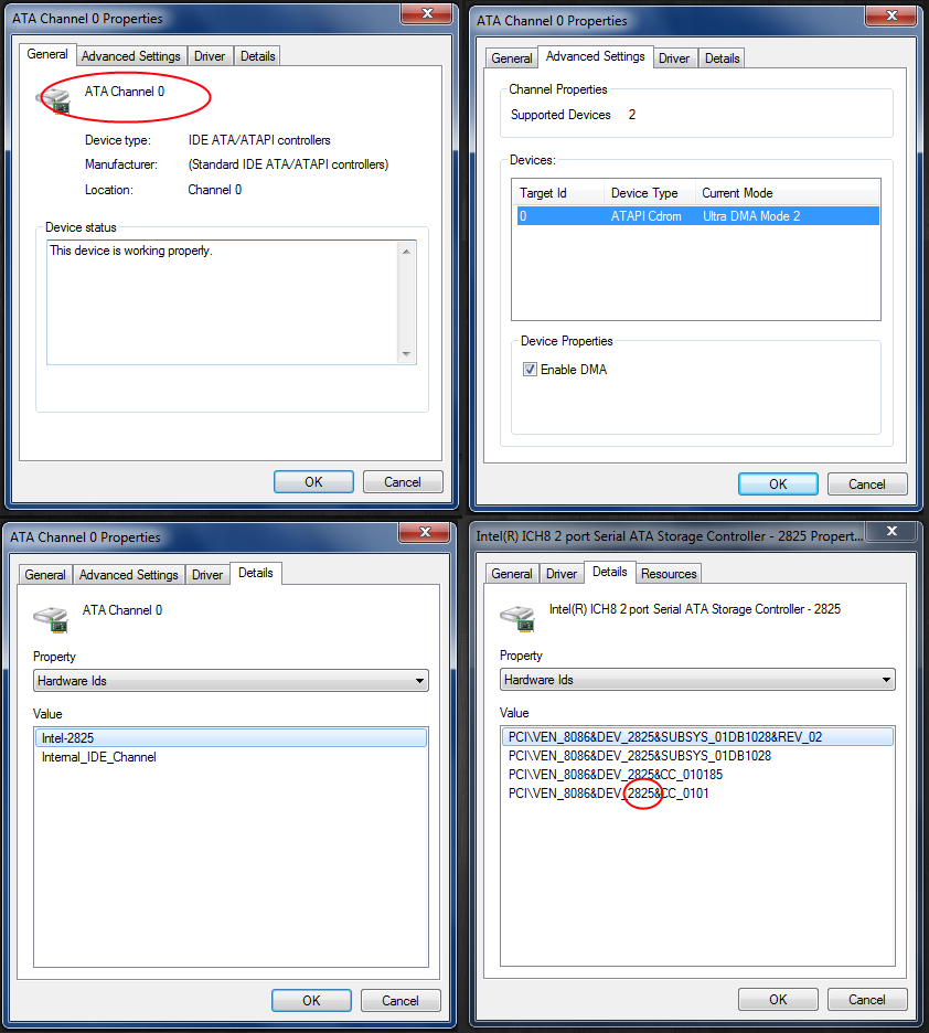

Mohamed Khairy Posted August 11, 2010 Share Posted August 11, 2010 My DVD drive is SATA. According to the BIOS it is located on the SATA4 port on the motherboard. OK from windows can you know sata controller id device mananger and on sata controller properties go to last list of properties and choose dev id Quote Link to comment Share on other sites More sharing options...
toner_ Posted August 11, 2010 Author Share Posted August 11, 2010 Here you go, there are 2 controllers on my mobo, so I provided screen prints of how I found it for anyone else that may use this tutorial later, it's "2825" Quote Link to comment Share on other sites More sharing options...
Mohamed Khairy Posted August 11, 2010 Share Posted August 11, 2010 Here you go, there are 2 controllers on my mobo, so I provided screen prints of how I found it for anyone else that may use this tutorial later, it's "2825" OK i will make it and when done i will post Quote Link to comment Share on other sites More sharing options...
toner_ Posted August 11, 2010 Author Share Posted August 11, 2010 I don't know if you need both, but the other is "2820", thanks! Quote Link to comment Share on other sites More sharing options...
