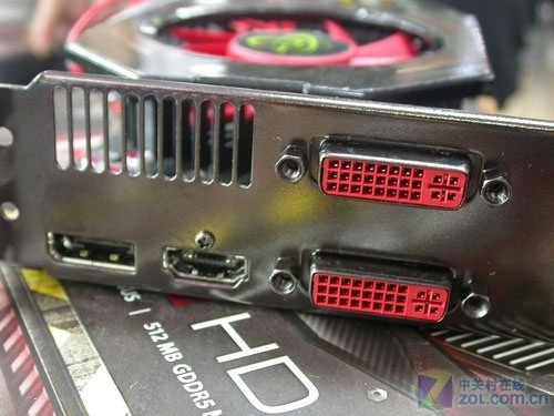

iTrooper Posted August 7, 2010 Share Posted August 7, 2010 Wooohooo jmacie! Thanks! one of those Tutorials did the trick, I now have full resolution and it's working on 2 monitors right now. Next step.....get it working on my 3rd monitor. Currently I have video coming out of the DisplayPort on my video card, and one of the DVI ports, but the other DVI isn't putting out any video yet. The ports are laid out very much like this one below - I do have the settings set to ATY,VERVET at the moment. Link to comment Share on other sites More sharing options...

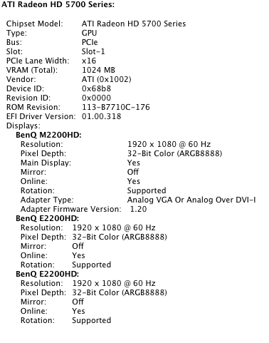

hascosx Posted August 10, 2010 Share Posted August 10, 2010 Reporting that Netkas has done it again! Thanks Netkas! Followed 5770 directions from Netkas and succeeded Card is Visiontek 5750. SCREEN SHOOT PLEASE FROM YOUR SYSTEM PROFILER Link to comment Share on other sites More sharing options...
jmacie Posted August 11, 2010 Author Share Posted August 11, 2010 SCREEN SHOOT PLEASE FROM YOUR SYSTEM PROFILER ATI Radeon HD 5750 ATI_Radeon_HD_5700.tiff Link to comment Share on other sites More sharing options...

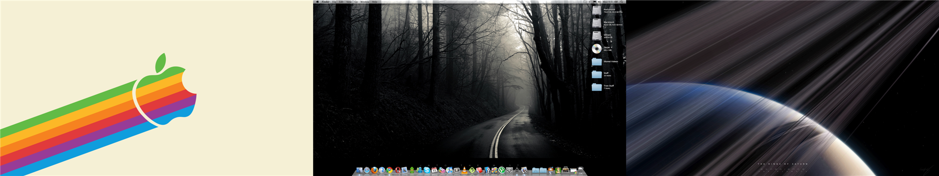

iTrooper Posted August 11, 2010 Share Posted August 11, 2010 And here's mine and the desktop capture result Believe us! It can be done!! For a 3rd Screen, you're gonna need a card like the one I pictured earlier in this topic, and the Display Port adapter. I've got my 3 screens all running random wallpapers every 5 seconds, all out of sync, so they're all different. I HIGHLY Recommend you get the HP VGA DisplayPort Adapter (AS615AA). It works for my Hackintosh to allow 3 screens, and works perfect for Eyefinity mode in Winblows. Most DVI Display Port adapters won't work because they're passive, and you need an active one and they cost about around $100 or more. I've experienced no loss of quality running the VGA adapter at 1080. I got mine for around the $30 range, just look high and low and get a good price. Now I have a big beefy brother to play with my Macbook Pro and my Mac Mini Link to comment Share on other sites More sharing options...
VCH888 Posted August 11, 2010 Share Posted August 11, 2010 And here's mine and the desktop capture result .... What is your graphic card? HD5750 or HD5770 I saw that device-id is the same as my HD5770. Thank you for your pictures. Link to comment Share on other sites More sharing options...
iTrooper Posted August 11, 2010 Share Posted August 11, 2010 It's a HD5750 (which from what I've read was a wee bit more tricky to get working). For me, the best piece of info that jmacie gave me was a link that lead to another post on this forum which refers to a GoogleDocs page --> https://docs.google.com/fileview?id=0B8c6FQ...4MDEy&hl=en Following those instructions are exactly what I needed to get past the "Pain in the arse" threshold and get my screens finally working. If you have the means to "Screen Share" from a real Mac or another Hackintosh, it might help you to see your screens if you're getting a big "Grey" screen or something. For me, I was getting that, but I can still hear sounds when I hit the volume button on my keyboard (I've got a real Mac Aluminium keyboard hooked up to my Hackintosh which gives me full Mac functionality). Link to comment Share on other sites More sharing options...

iTrooper Posted August 11, 2010 Share Posted August 11, 2010 Hehe, those 5700, 5800, 5900 series cards usually come with a fair few video ports on them, just make sure to ask them if you can take it out of the box before you purchase a new card. The one that makes me drool is the Eyefinity 5 and Eyefinity 6 (5870) cards, they come with 5 or 6 Mini-DP ports on them If you tweak the settings I pasted above, you could end up with a 5 or 6 screen Hackintosh, now that is the epic aw3s0menSS 8) Link to comment Share on other sites More sharing options...
